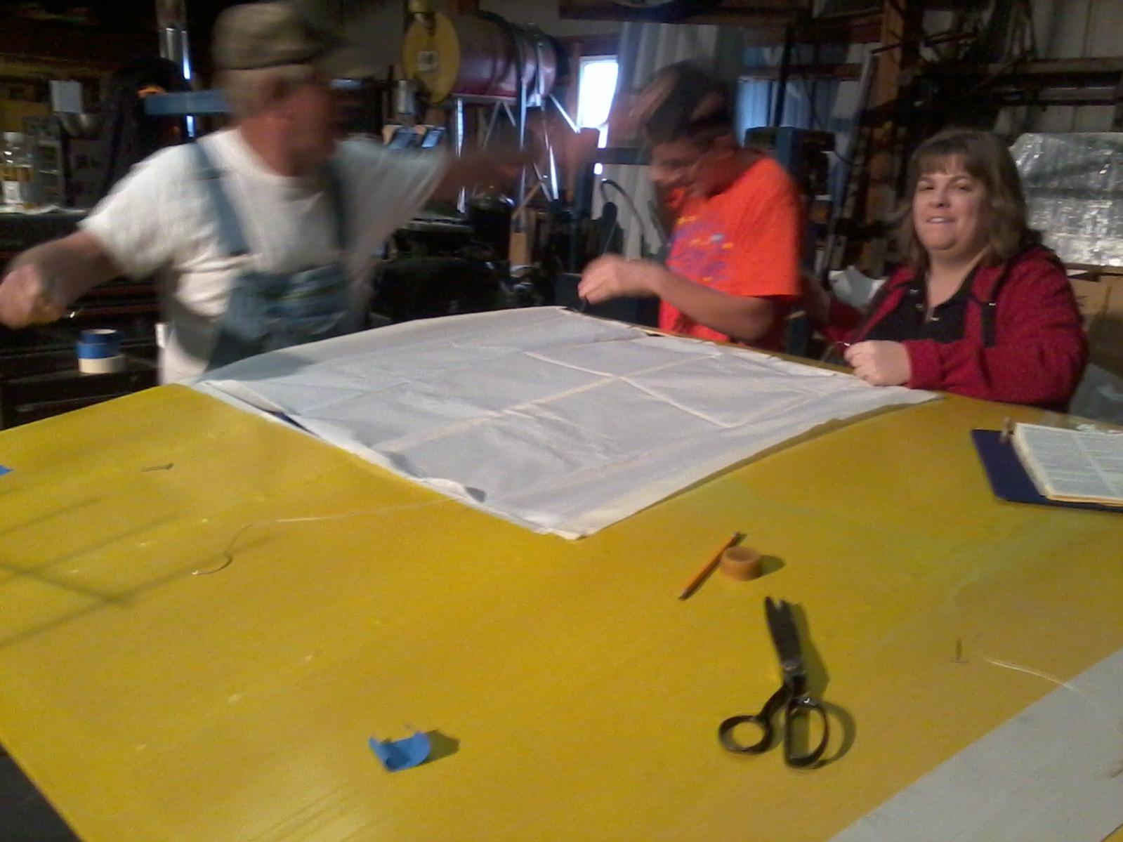

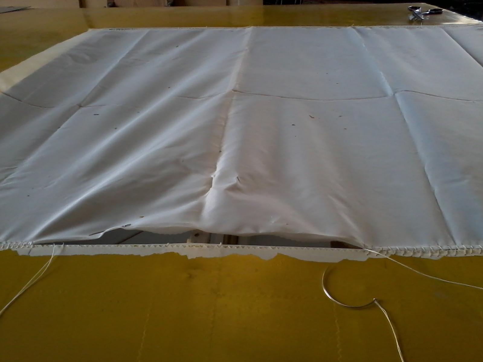

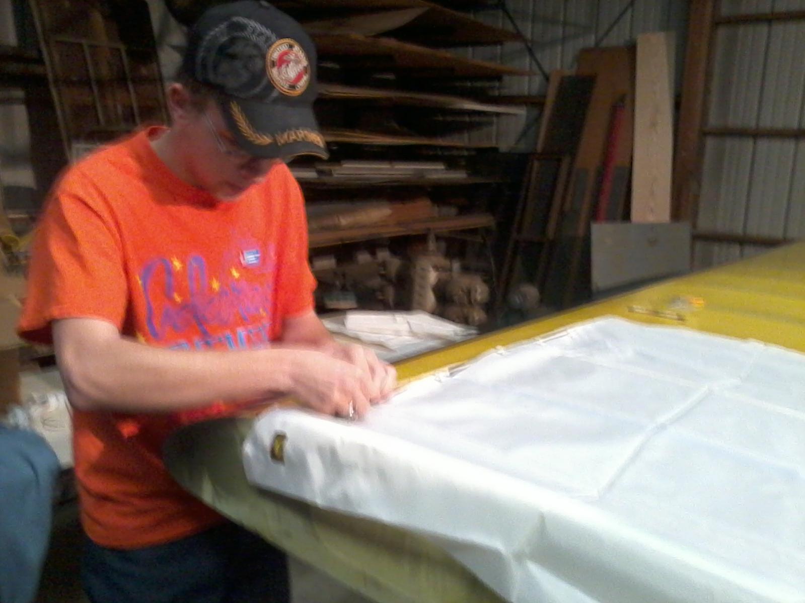

                          Since the patch spans three rib bays, I am doing a baseball stitch spanwise along the leading edge and aft edge of the patch. We were sure to peel back the existing dope far enough so that the stitches were fabric-to-fabric and not sewing through the existing dope finish. On the outboard edge, the existing fabric was cut right up to the outboard rib (#3) without disturbing the existing fabric attachment on this rib. In my case, the previous fabric installer used aluminum rivets so I will retain this method for securing the new patch to the ribs. But that's a later step. After consultation with my I.A. we decided that I will extend the new fabric patch past this rib by 2 inches. The edge of the new fabric will be sewn by hand (zig-zag) to the existing fabric. I will also add rib-stitches to this rib later between the existing fasteners. On the but rib end, no stitching is needed because I can get a good solid structural glue joint (Super Seam Cement) of the patch with a 3 inch overlap on the but rib.

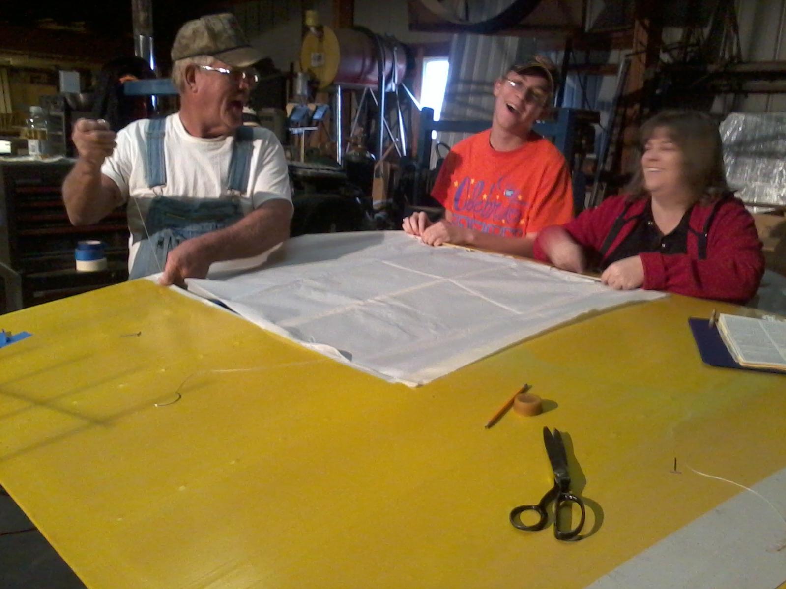

                          As you can see by the photos, I had some pretty good help at the beginning... not without some horsing around. This photo is three generations, our son, my wife, and her dad. Pretty cool. They helped get all four corners stitched. Then it was all left for me to finish. It really isn't that slow if you keep after it and don't let yourself complain. It is actually fun. I once got frustrated with a rat's nest of a not I created. So I walked away, took a break, then came back awhile later and the knot came right out. I found that the recommendation of coating your sewing thread with beeswax is a very good suggestion. It seemed not only to keep the thread from tangling as bad, but it also seemed to help the stitches stay tighter until tied off. The most difficult seam was along the outboard edge of the rib because I had no access to the underside. I learned that if you'll pre-poke your holes it will make your life much easier and your stitches will come out a lot more uniform. You can see in the pictures, we tried to allow some slack in the fabric to account for shrinkage to come later on. The book says you will get approximately 10% shrinkage.

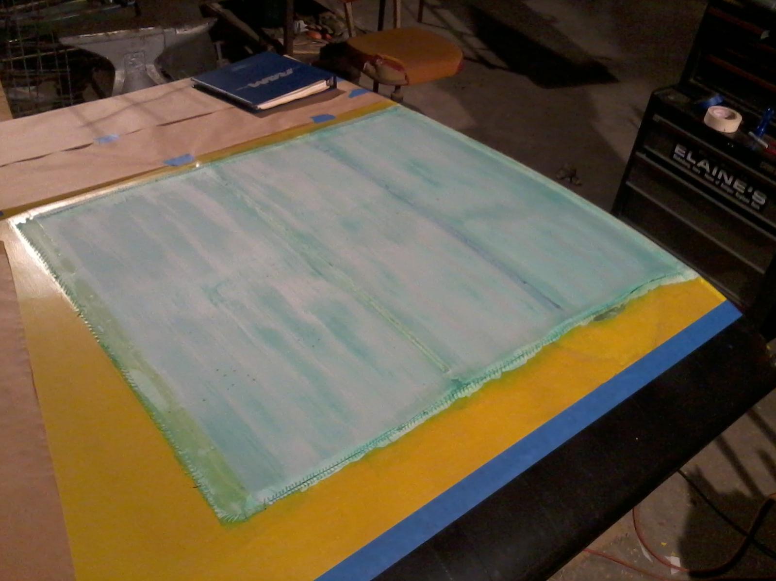

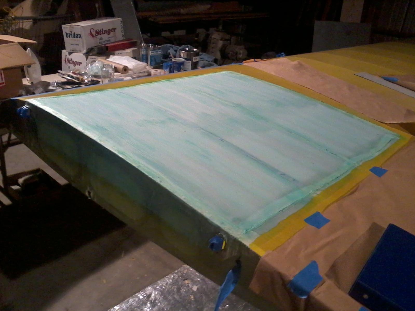

                          On to the next step... first coat of nitrate (non-taughtening) dope. I used the green-tint version. There is also a clear type, but the tinted is recommended to see where your coverage goes. It is not just about coverage however. The main intent is to get PENETRATION. You want the fabric to become impregnated with the nitrate dope. So you find that once you start brushing it into the weave of the fabric, you will learn and see how the fabric absorbs the dope. It takes a firm pressure on the brush for this to occur efficiently. You want to get the stuff brushed on and into the weave but to do so with minimal strokes. Too many strokes and it starts to become tacky and leaves brush marks. The brush technique takes practice to get down, but you can pick it up pretty quick. I think I will have a few brush marks to deal with, but I think I was starting to get better toward the last. Some folks say you can spray this first coat instead of brushing. Maybe I am old-school but my dad brushed this coat and had good results. So that's how I am doing it.

                            why not go all the way back so you do not have a noticable seem in the bays? stitch can be hidden by one extra wide tape over the rib.
                              Re: Ceconite covering process discussion and Nitrate/buterate dope
                              good idea Mike... will try that on the bottom. I guess I got caught up in trying to minimize the cutout area. Always learning... thanks.
