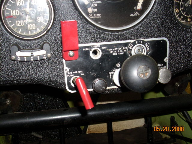

                        The "swirled" finish is called "Engine Turning" and is done with a drill and VERY steady hand. That was what was on the cowl of the "Spirit of Saint Louis" and it is a beautiful finish, but I don't know how well it stands up over time or if it was original on a Taylorcraft. The panel in the second picture is partly original but someone has put a key mag switch in and added a cover for the fuel cut off that wasn't there from the factory (but is REQUIRED now). I kind of like that safety cover since there is just NO WAY you could accidentally pull the fuel cut off like you can with the little spring clip ones.
                        We are gathering parts for the restoration of Josh's plane and he wanted to put the original panel back into his, so we will probably be doing that. We have a panel and big Tach, as well a s some of the other parts so I will be following this thread closely. I am just starting to research the "big tach" panels and hopefully Josh had a lower plate in the boxes and I can post some pictures and make a drawing. If it was engraved I will be able to make them, but from the photos I have seen it looks like it was Silk Screened. Oh well, I have wanted to learn to do Silk Screens for years. Always fun to learn a new process.
                        If we can get a good example of an original rectangular panel, we should be able to make copies. Hopefully someone will chime in. Good project for the cold winter months.

                              Noel Allard has 3 versions of that placard, one just like the original in Howard's photo, one with carb heat and cabin heat substituted for nav lites and switch on top row, and one with no top row. All currently $40 plus $5 shipping. I believe that the original cabin heat and carb heat knobs were all the way on the left by the parking brake, I've seen a photo somewhere with them there, and the instrument panel for NC22211 has the holes for them there.
                              Don't know what the big holes at either end were for, obviously added at some later point. And somebody obviously added the funny dohickeys at the yoke holes at a later time also.
                              And anybody have a few of these laying around?
                              It's the switch used above the throttle for the single mag (missing the knob. On Howard's airplane somebody replaced it with a key switch), and apparently for the nav lite switch also. Lites were push off which opened the circuit and mag was push on which opened the circuit. I'm guessing that it's probably either a period automotive headlight switch or a period tractor mag switch. The push pull rod rotates a circular contact plate inside the round part.
                              Re the swirled leaf instrument panel, the more I think about it the more I think it's likely to be from one of the special show ships, as there are several prominent in the Alliance Memory photos, and it wouldn't be surprising if they put a special finish on the instrument panel of a show ship.

                                Andrew, you are correct about the carb and cabin heat being on the left side, but they were not mounted in the panel. There were 2 holes 3/4"? for the knobs to go through, but the cable assemblies were mounted to the structure. The plate with the ignition and nav lights was used all the way up to 1941. The other 2 styles he has are adaptations.
