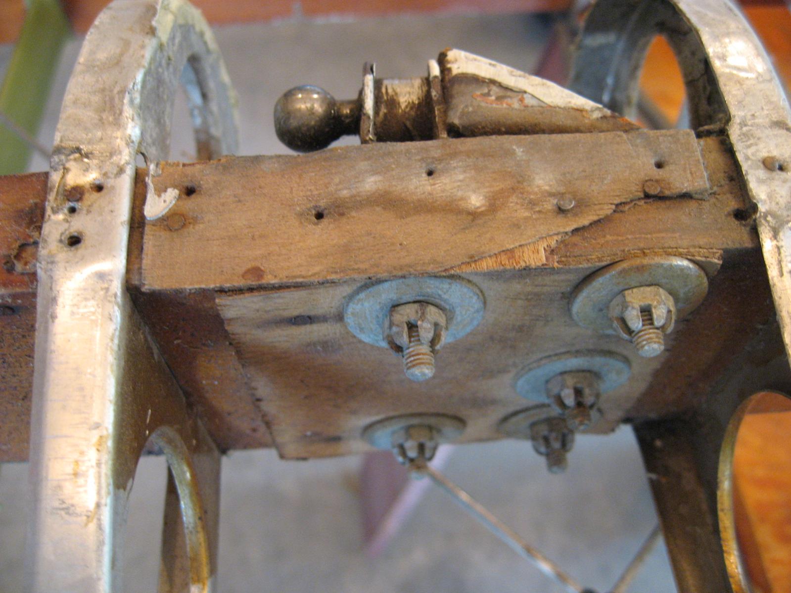

                          Swoeric, the very first thing that should enter your mind when you find a loose bracket like this, is WHY???? Like Hank mentioned in an earlier post, make SURE that you're the first one to ever have tightened up that nut, and figure out why it came loose! Unless you're the original owner and the only one that's done maintenance on the plane since new or at least an aileron rebuild, you can't be sure that someone else hasn't cranked on them before. Here's what I found on my Tcraft, years ago, when I did my first annual on it. The previous mechanics or owners had cranked things down more than once! This plane spent it's life in a nice dry climate, but you can see what was waiting for me when I opened up the aileron....
                          Not saying yours will be anything like that, but even in the picture that Mike Cushway posted, you can see distortion and damage behind that one washer from overtightening and "not so great" wood.... check it over closely!!

                            Looks like Mike's first pic is drilled bolts, if that is what someone put in, it will be tough pulling cotter pins out and putting them back in thru a slit in the fabric, Tom

                              I think you may have won the prize for the WORST damaged ailerons from overtightening! Those spars are SCARY. Anyone else think they have a shot at the "Baby Huey"award?
                              Sure glad you found the damage before the spar failed! I have a mental picture of that aileron spar in turbulence getting a real workout and cracking across the crushed grain. Not a pretty ending. Good on ya for catching it!

                                Yah Hank...it sure opened my eyes to look in there and see that...especially when it was flying alot and over gross just before I bought it!! It just goes to show what alot of the mechanics and people that are "taking care" of these planes, DON'T know about what they are doing or looking at! The spars in the wings weren't that much better! People that haven't worked with wood, don't realize what can be going on in there...that's why I was saying that the first thing through your mind when you find something loose, is WHY?????
                                I keep that spar on my wall, as a reminder and a demonstration tool to everyone that comes through the door with an airplane with wood in it...as well as some other "choice" parts I've come across in the last 30+ years... like they say, a picture is worth a thousand words..well, holding that part in their hands is worth even more!
