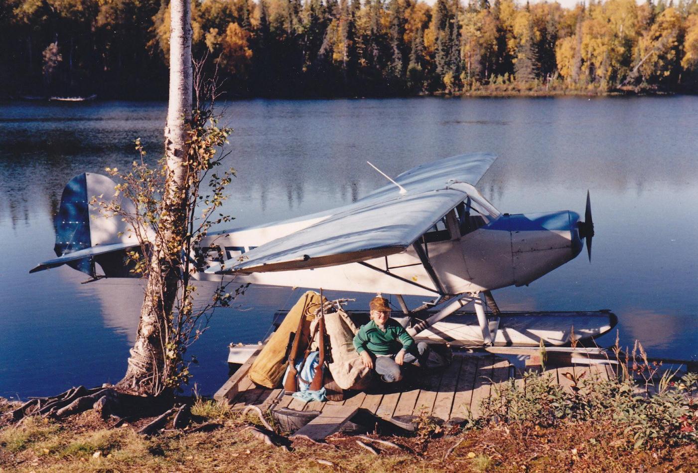

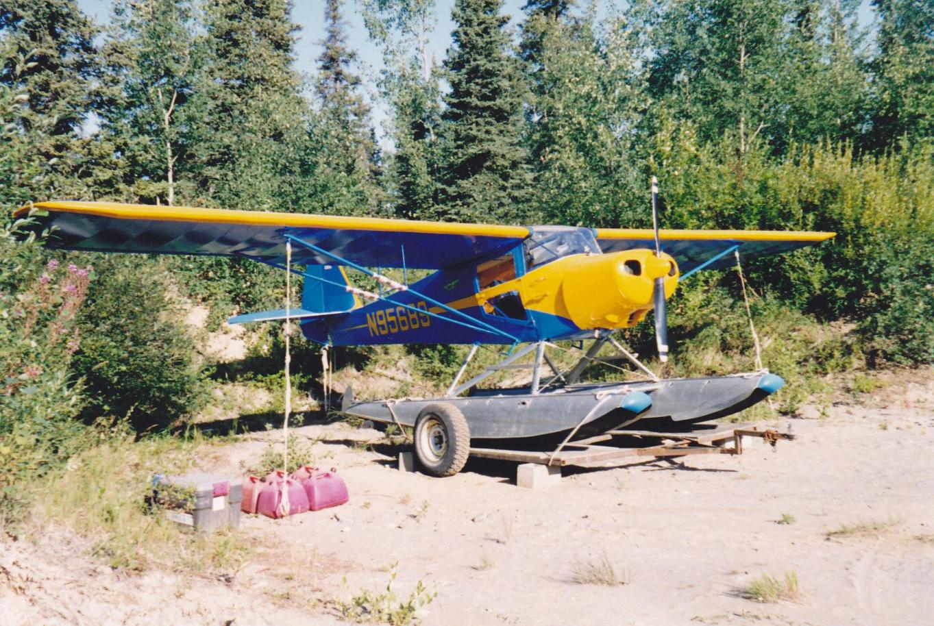

                      Re: From days gone by...
                      A couple of pix of Taylorcrafts powered with Lyc. 0-290. Blue/Yellow was an experimental BC-12D and the Blue/White was an F-19. Really helped on floats. You can see the two different cowling styles.
