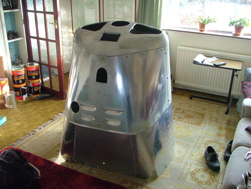

    If the photo below helps, this is what I have on mine.
    It's difficult to show the louvres...perhaps the attachment below helps...just imagine the firewall 18" above the carpet.
      Re: Bottom Cowl on BC12D
      Thanks. Maybe my louvers are correct. Super looking sheet metal work.

        Kripes Robert, If my cowl looked that good my wife would want it for a coffee table!
