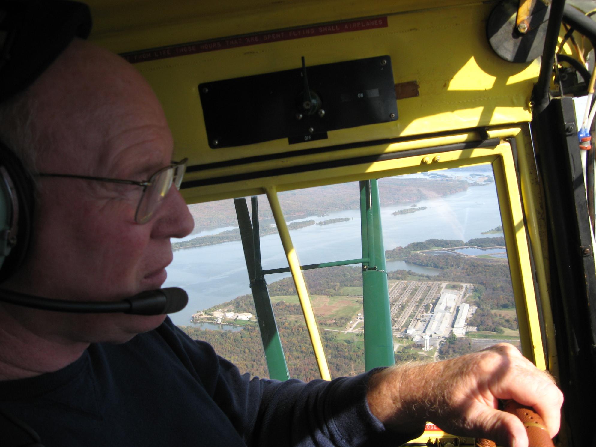

                  the wing tanks on my plane are the type with the valves in the wing roots the handles have a pointer when at 6 o'clock is off 3o'clock is open and feeding the main tank also they are plaquerd do not open until main tank is below half empty see photo
                  1940 BLT/BC65 N26658 SER#2000
