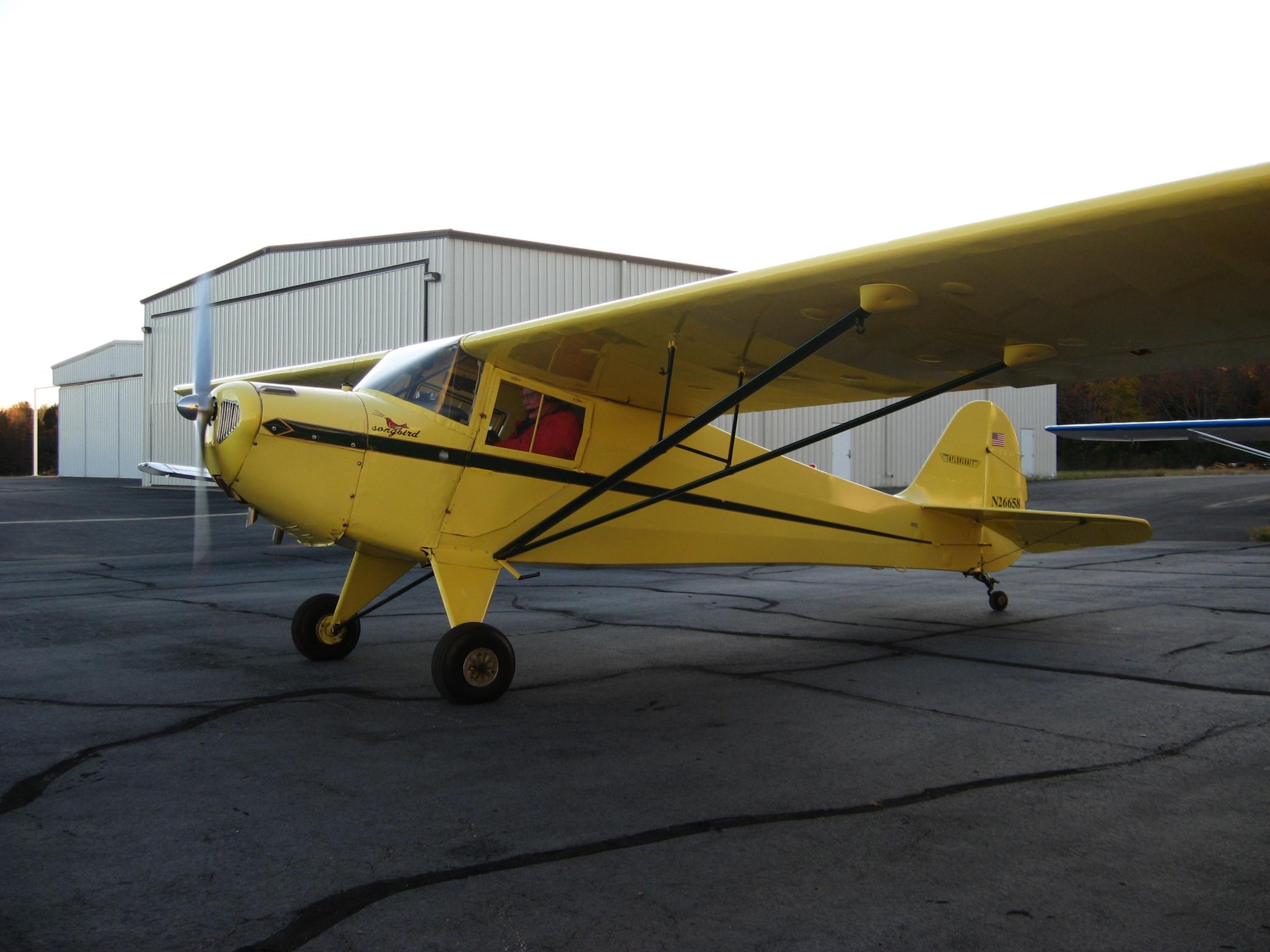

Nice pic Tom. I have a question, I notice most aircraft have the landing gear fairing like yours but very few have the cuff/fairing around the struts at the wing. Are they standard or does it take some paper work to attach? I have one for a pattern from Rob to use someday. Larry

They aren't hard to make if you have a pattern to start with. The pattern WON'T FIT, but with some cardboard (a LOT of cardboard) and some careful trimming you can make a set that fits great. Then just transfer the cardboard shape to some aluminum flashing and you are in business. One thing that is IMPORTANT is to be sure to put a rubber edge over the metal where it is against the fabric. The edge of the aluminum will cut the fabric from the vibration!
I am going to work with Ray to make him a set and we should have another set of patterns in a few weeks. Each different strut size and cross section shape changes the shape of the pattern completely. You will need a LOT of cardboard and a bit of beer to get them to look right, but it is fun.

Larry,Originally posted by Larry Lyons View PostNice pic Tom. I have a question, I notice most aircraft have the landing gear fairing like yours but very few have the cuff/fairing around the struts at the wing. Are they standard or does it take some paper work to attach? I have one for a pattern from Rob to use someday. Larry
The strut cuffs were standard on my '41 DeLuxe (BC12-65). The photo of my Dad's '39 BL-50 taken in 1940 does not have cuffs. My only two data points.

My '41 also has the strut cuffs and I have to say the rubber coaming around the edges are made of some tough material. May be synthetic but it's textured, some 1/2" to 5/8" wide and looks pretty much bulletproof. Beware of anything else, as softer types can wear out easily. This may not be original but has been on there quite some time and is getting just slightly brittle.

Looks like the delux in 41 had then from the factory.

Yep I saw that pic last night too. That is the only pic I have seen but looks nice. The one rob sent me is plastic and has a permanent bow in it so I have sitting on my bench with a weight slowly flattening it out so I can use it as a pattern. Been there for almost year now and I could use it if necessary but as I do not need it I will let it set some more. One thing I have learned is use this forum first with questions, I payed dearly to have Rob send me this from the UK when all I had to do was ask here and I could have had a paper pattern mailed direct instead of over seas postage!

Larry mine are definitely sheet aluminum and my best bet is they're original. Mine is ser no. 2736, mfg. 4-41. Far as I know so are the struts (...and I would really like to keep them that way as I need no added weight with this Lycoming). From what I have seen of the Taylorcraft Foundation and the Chet Peek book pics, I am pretty certain all the '41 B -12 models had the streamline cuffs.

Hear is a photo of the cuffs on n26658 they are plasticAttached Files1940 BLT/BC65 N26658 SER#2000
