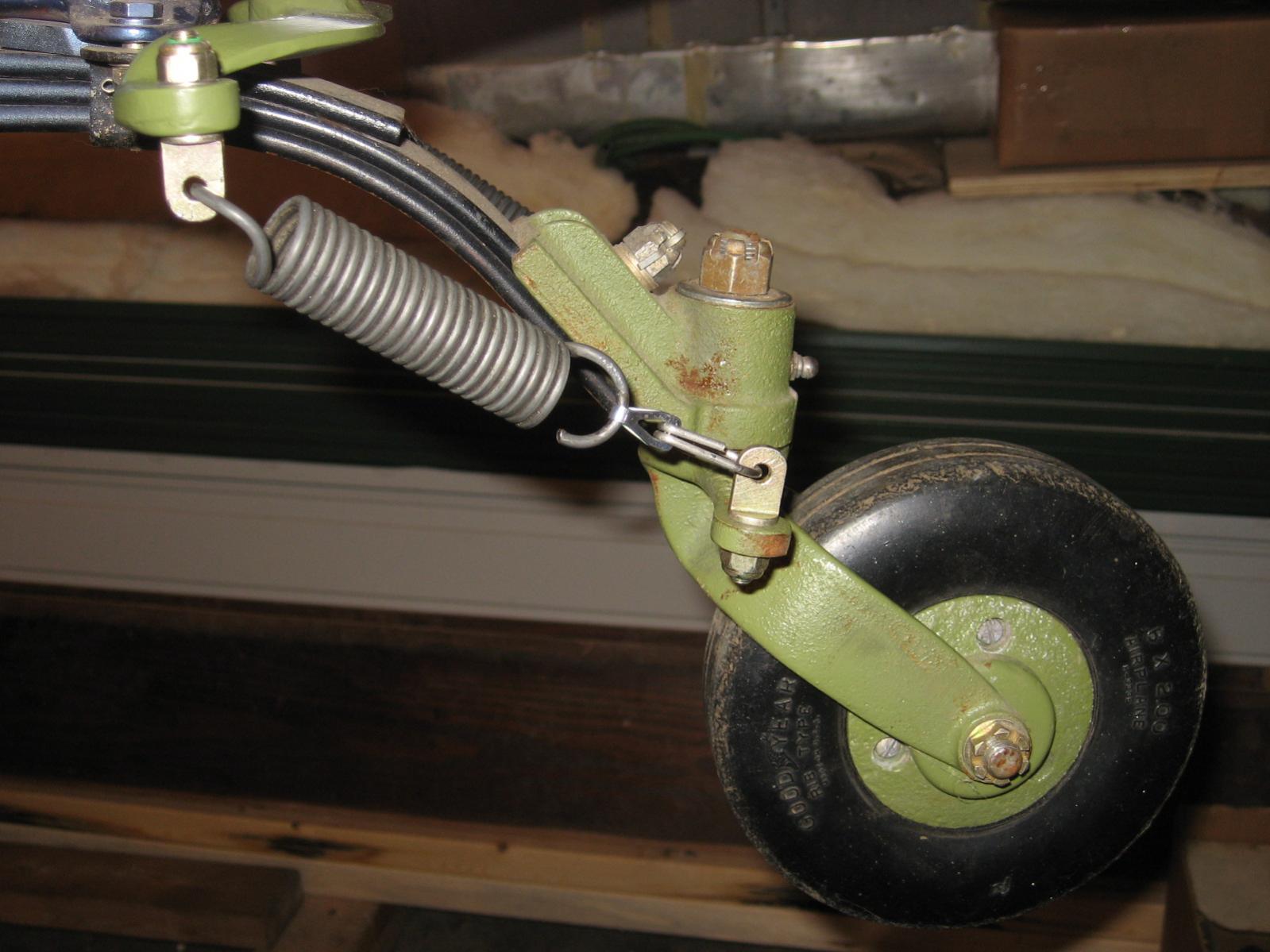

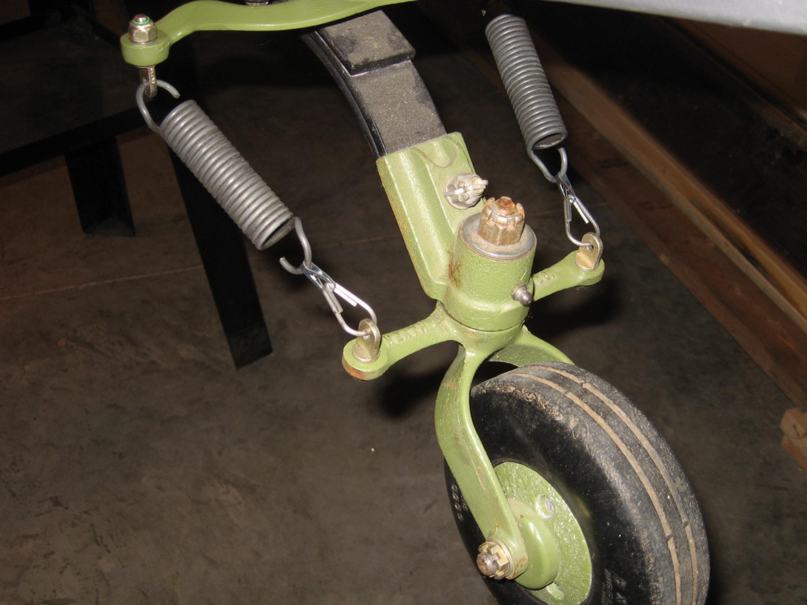

I would like to hear some real world discussion on the merits of a steerable tailwheel versus a full swivel. I have an excellent condition (fully restored) Heath on my 1938 B. I have not yet flown this aircraft since purchase (4) short years ago. All is looking well for having it back in the air this spring. I am a relatively new pilot with approx 100hrs....50 of that in the Cub. I have zero experience with a steerable tailwheel. What can I expect of this tailwheel? What type of spring pressure should I have on the rudder arms? Attached are a couple pics of the tailwheel before restoration.

What is "too tight" on the springs? Right now I have maybe 5# on each side in the neutral position. If I add another link they are loose to the point of hanging.MIKE CUSHWAY

On my first two T-Crafts I had the same tailwheel as yours, absolutely no problem whatsoever. You sacrifice a little bit of ground handling if you want to pivot around the main gear while turning at the end of the runway or while parking. I made do without any problems. You also won't have the problem related above when the lock doesn't lock anymore.
Your tailwheel is also the 'correct' one for your airplane. The only more correct one would be obtaining one that said 'Taylor' on one side of the steering arm and 'Craft' on the other, Heath made them both. There is one on Ebay right now, in fact.
My current T-Craft has a Maule full swivel tailwheel. It does come in handy when moving the aircraft around on the ground and in the hangar, as well as a little bit better ground handling as Tom said.
You do not want the springs sagging or hanging, they should be taut. How taut, I cannot tell you. Both of my planes came set-up just fine. They both had a little tension to begin with. I have never seen the set-up you have to attach the springs to the rudder and tailwheel arms. My springs attached directly to both arms. From the pictures you posted that looks like my first two set-ups on my prior T-Crafts. You will probably pick up a little tension when the tailwheel is on the ground and the weight is on the wheel.Last edited by M Towsley; 12-30-2010, 08:43.Cheers,

Spring tension is a trade-off. Too loose and the taxi steering feels a little sloppy. Too tight and the steering becomes a little twitchy at higher landing speeds. One other thing to keep in mind... if you loose a steering spring on one side, a too tight spring on the opposite side can pull the tailwheel to that side. Not a good thing to have happen on a non-swiveling tailwheel.
I have my steering springs set up with a small amount of tension. I'm guessing about 5 lbs. It's a reasonable compromise between good taxi handling and acceptable three-point landing sensitivity.

Mike, The set up you have should work just fine. My only suggestion is to "Mouse" the forward end of the springs. Mousing uses safety wire to help reduce the chance of losing a spring. There are photos of mousing on Rob Lee's restoration website. After you have a little time using the Heath, try flying with someone that has a full swivelling tailwheel. As long as it is properly maintained and locks up and unlocks as it is suppose to, it is no harder to use than a non swivelling. The only difference between the two shows up when you are parking and need to pivot on one of the mains.Richard Pearson

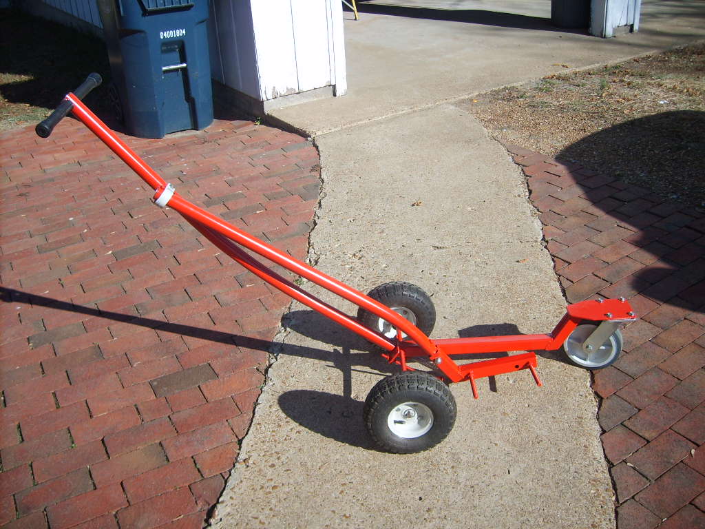

I built this to help me move air planes in and out of hanger works well on rough ground over door tracts and you can see the wing tips well chuckAttached Files1940 BLT/BC65 N26658 SER#2000

Hi Chuck,Originally posted by cvavon View Posttribe
Thanks for the picture!
I just got back from Northern Tool. I went there to get a a trailer dolly (on sale for $29) it includes the main steering arm, axle and 2 pneumatic tires (plus a trailer tow ball). I planned to modify into something to use on my tailwheel to get the a/c out of the hangar.
Your picture is a big help. Its timely and a terrific item for me to emulate.

Heath ( or any non-swivel) is best for low time pilot. They cannot kick out. Get rid of the non standard attach hardware , they put a twisting moment onto the tail wheel arms , not good to lose an arm. Tension is just barely snug put them on even . IF you want to take one link out to make it tighter do it on the right side . I have pic , can't find it this morning.Taylorcraft Foundation, Inc
