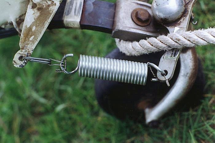

          I think this is correct thread ; I found pic of mousing and the clips , this is a typical Taylorcraft , the springs are shorter than other ships; I have been known to buy one and then cut it in half with a sharp chisel, bend out ears and use both. The reason for clips & chains is to prevent the spring from jamming up in a colum situation. This way it hangs down out of the way when relaxed.
          These springs are backwards , I usually hook spring to rudder arm , then chains or clips. these springs should be shorter ( they could have been cut in half and you have two sets.) and then chains used.
          The pic was to show "mousing" . I have been down with power failure & internet failure, back in full steam on Tuesday. Got to go move LAST of snow from last batch.
