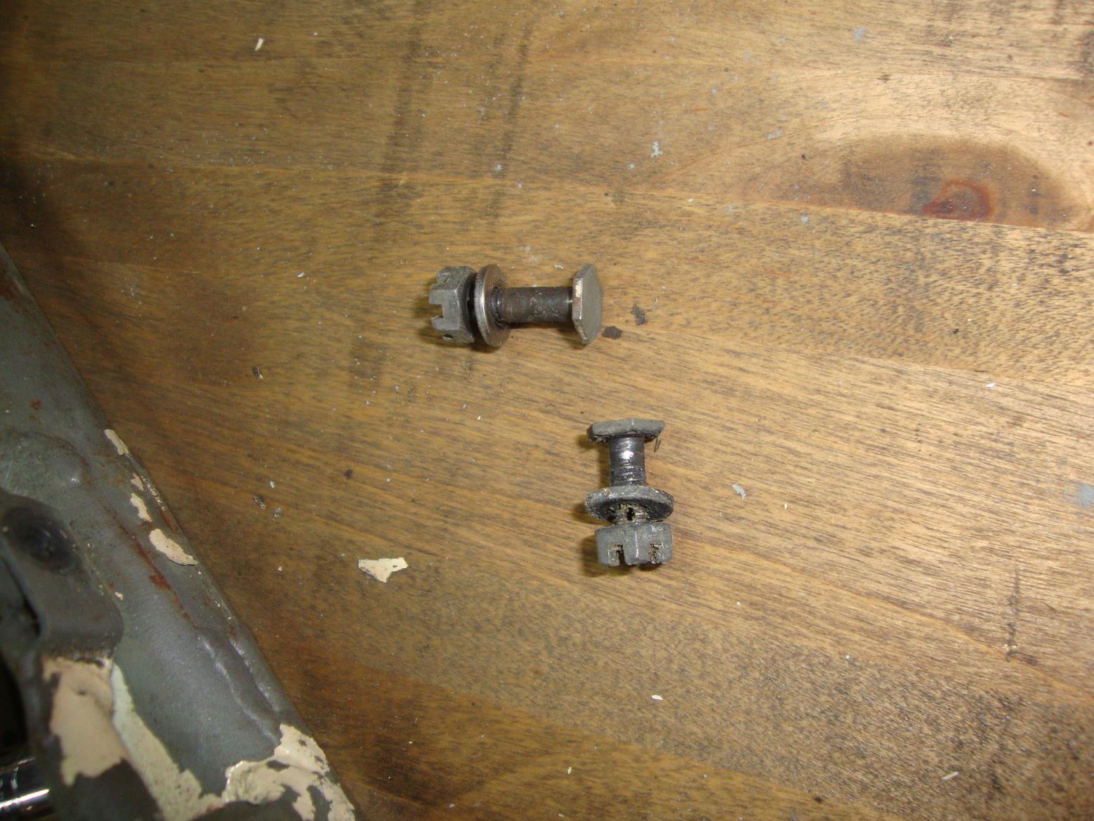

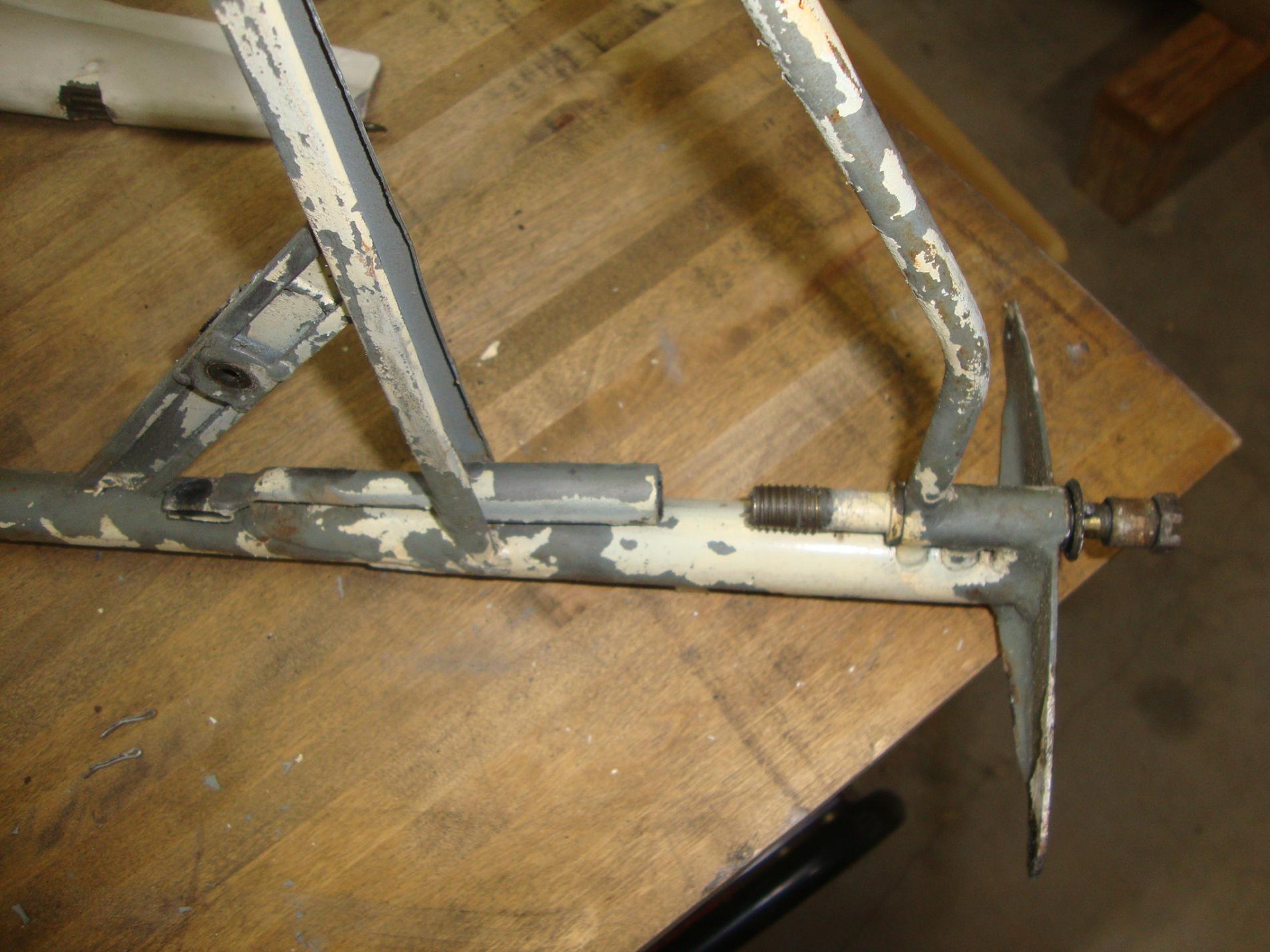

          I have two questions about this. BTW, If I haven't told y'all yet, on March 1, 2011, I took my Tcraft out of service to start my recover/restore project.
          My first question is about the two bolts with very thin heads in the elevator trim bellcrank assembly. Are these thin-headed bolts commercially available? Or do I have to grind down the heads of new bolts?

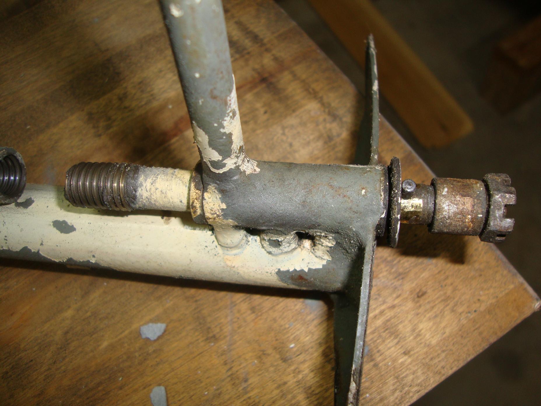

          The second question is how do I remove the two threaded parts of the actuator assembly from the elevator frame? The little pin that seems to hold together the rightmost (male) half is in a blind hole. So I cannot push it from the other side.

            Those bolts look like AN bolts with ground or filed down heads. That is NOT what was in either of my planes. Mine had AN-23 or AN-24 Clevis Bolts (can't remember which, just get the grip right).
            Not sure on the pin. Mine pushed out from the other side.

                Those thin headed bolts were a Taylorcraft part ; just make them IF you need them .
