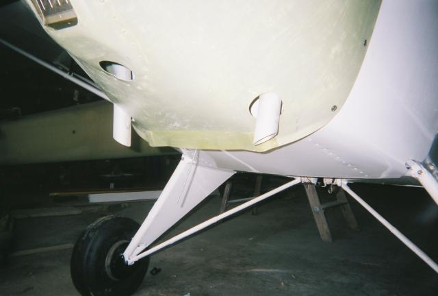

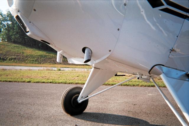

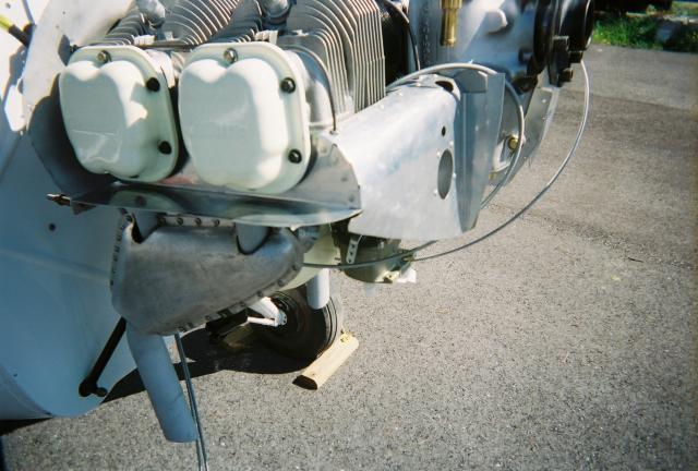

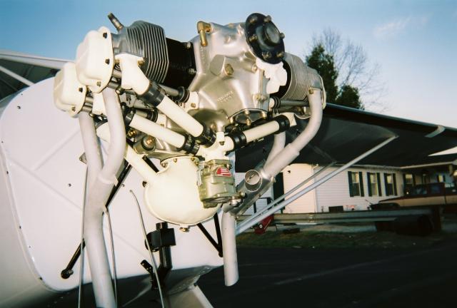

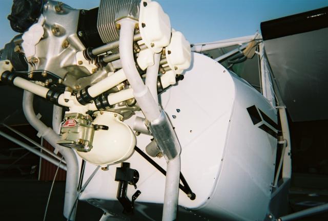

I love the luscombe exhaust...that's what I used on Crispy. It's a non-electric BC12D with and 0200. Exhaust is used off an 8E,F,etc. Worked really well but you will have to relocate the gascolator from the tab on the original short engine mount to the firewall. Also,if using a 6qt oil tank you will have to modify the tank slightly because it will just touch the engine mount tubes on the back side. A four and a half quart pan works great but I like the extra capasity on the 0200. I am STC'ed for a McCauley 74/45 prop which is what worked great on the 0200 and will need one when Crispy goes back together again. I'll try to attach a couple pics of the exhaust on Crispy.Originally posted by Jim Herpst View PostHmm thanks all.I will do more rersearch on the cam. I was planning on the Luscombe exhaust. Kevin I had another guy PM me yesterday on the prop. No hurry to sell right now anyhow. Want to do more research there too then let yall know something.. Also have a A-75 that came with it (it is an original A-75 from Continental as the tag and logs show) want to consider what I will do with this complete engine also. Thanks again all. What a great group still here ! Taylorcrafts forever !Kevin Mays
