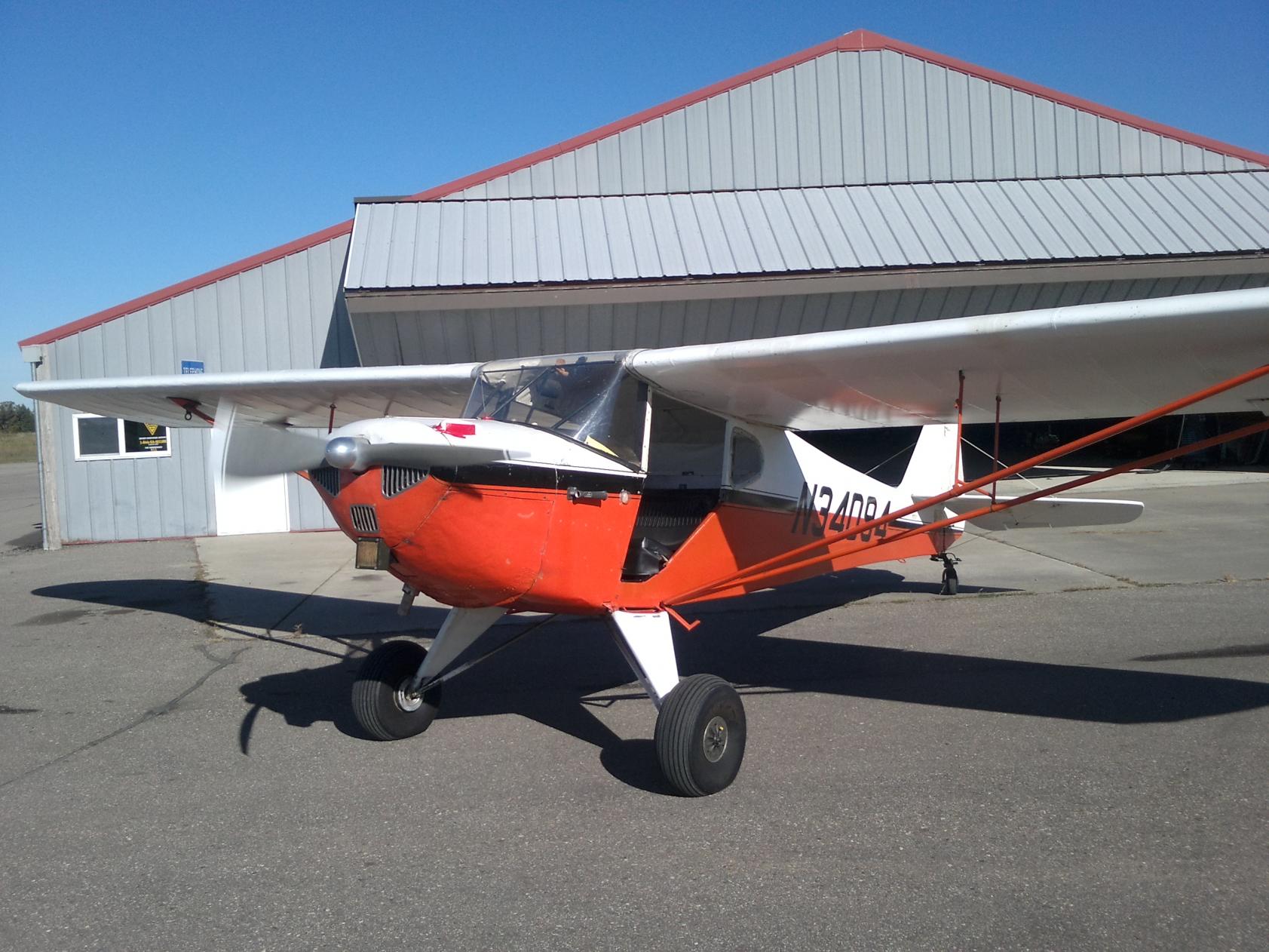

                          Im trying to put a pic on here with no doors hope it worked. If not can someone let me know how.
                            Re: Doors removed
                            Not a '41 admittedly; a '46, but good fun nonetheless!
                              Re: Doors removed
                              Skipilot.... that's one of those planes that just looks "RIGHT"!
