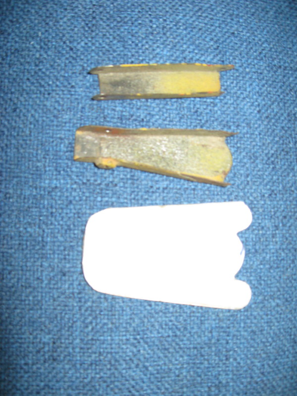

        Could someone post some pictures of the latches? Some idea of size would be good. I don't have any for my project, so I don't have anything to copy.
        Ray
          Re: Window Latch
          I'll put it on my list to trace the latch parts on Monday at the airport.
            Re: Window Latch
            Thanks Hank. That would be great.
              Re: Window Latch
              I don't know if the pictures will help or not. Unless you have some latches to copy I think it will be difficult. The left and right are unique. Anyway if can use the one pattern, I'll send it to you.
              Norm G
                Re: Window Latch
                Mine were mirror image of each other so you could just bend the metal the other way to make a right or left. I am hoping I can make a template on graph paper so it can be scaled from a photo.
                Do you know what material and thickness you used?
                  Re: Window Latch
                  The latches that I made using what I had on hand,.032 steel.
                  Norm
                    Re: Window Latch
                    Norm,
                    Check your private messages. Or email me at neat1s @ yahoo.com without the spaces.
                      Re: Window Latch

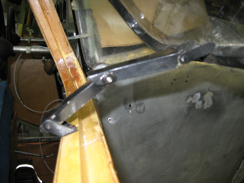

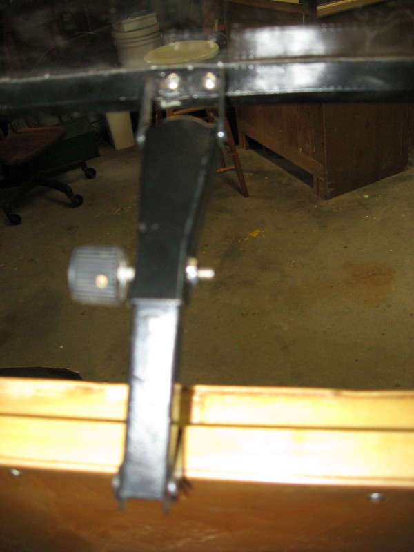

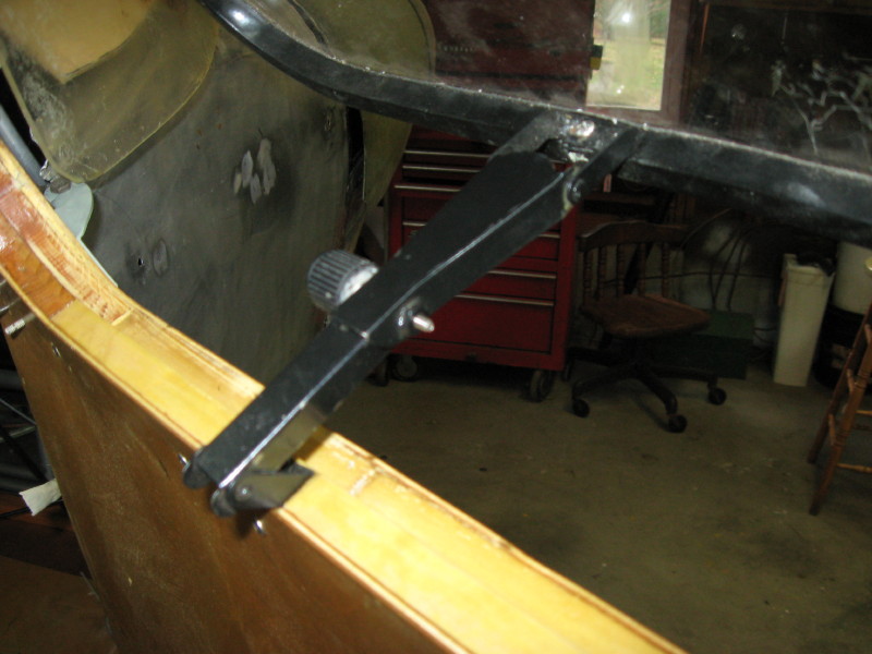

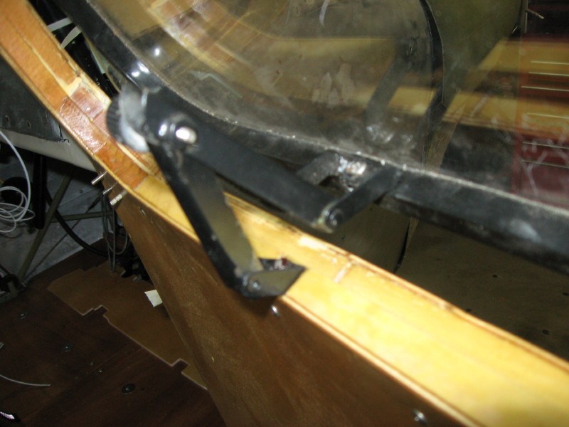

                      Not sure if this will help, either.
                      Wow! Those are some ugly rivets. Never noticed that before!

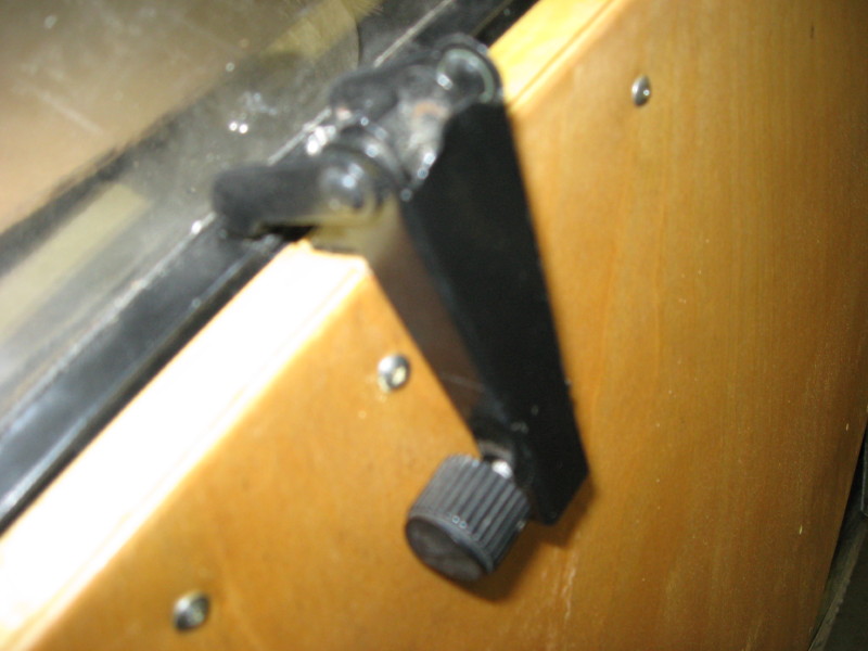

                        Re: Window Latch
                        on my window latch some one put hitch pins in the latch and the hinges makes it easy to take off windows in summer or to take photos see picture
