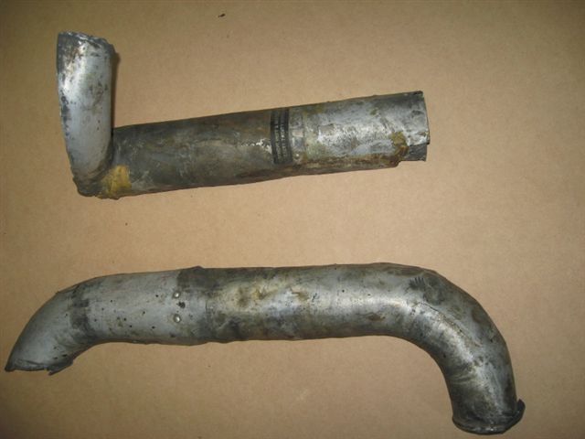

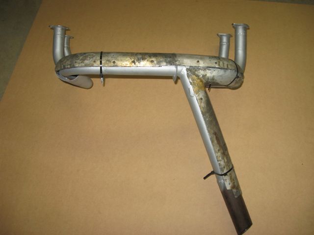

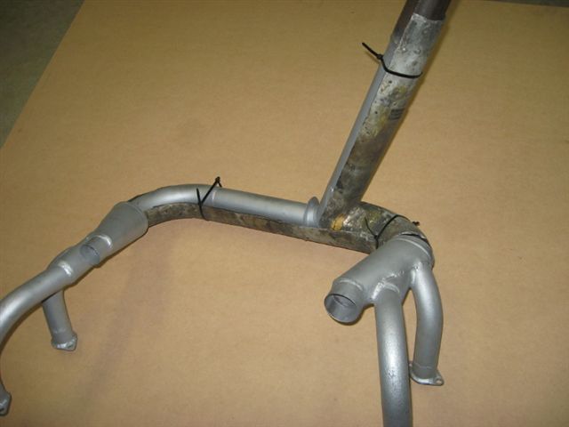

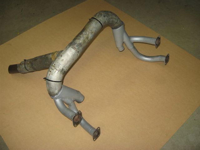

                              First off, thanks for your input on this exhaust problem that we all
                              share. As far as making and repairing my system, I have tried using O aluminum. First I made a mold then cut a paper pattern,then using O alum. I worked the O until I found it's beond my ability, I give up. Now if I could find an original shroud, I would consider buying it, or at lease the one piece I don"t have ( see pictuers ). At this point, Luscombe looks like the way to go.
                              Please continue with your coments and sugestions, belive me, it realy helps.
