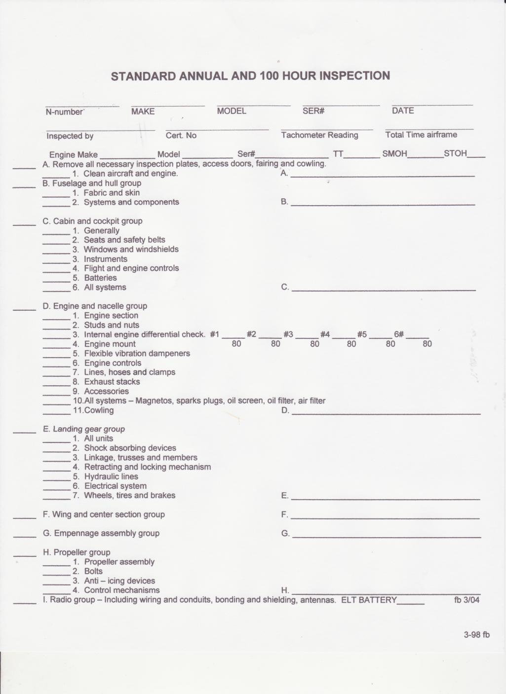

                        My very own KISS Standard Annual & Inspection form is now attached , this is 43 Appendix D and I use it for all small ships plus any Condition Inspection I do as an A&P . I will be gald to add any Taylorcraft specific items ; but this one seemed to fill the bill all these years.

                          I agree with Forrest on this one... I would not try to re-invent annual inspection requirements for Taylorcrafts. When we start detailing out the job of the A&P with Inspection Authorization for annual inspections, we are only expanding our own grief. These guys are trained and authorized by the FAA to do their job to a standard. As owner / operators, we will use the I.A. that can be trusted to do their job right.
                          So... I recommend this inspection manual effort should not try to dictate annual inspection requirements. Instead this group effort should be recommendations for restorers, owners, and operators for the upkeep of their Taylorcraft airplanes. And, it should be so designed that if one follows these recommendations, he/she should have no worries at annual inspection time. Just leave it to the I.A. to handle the annual inspection.
