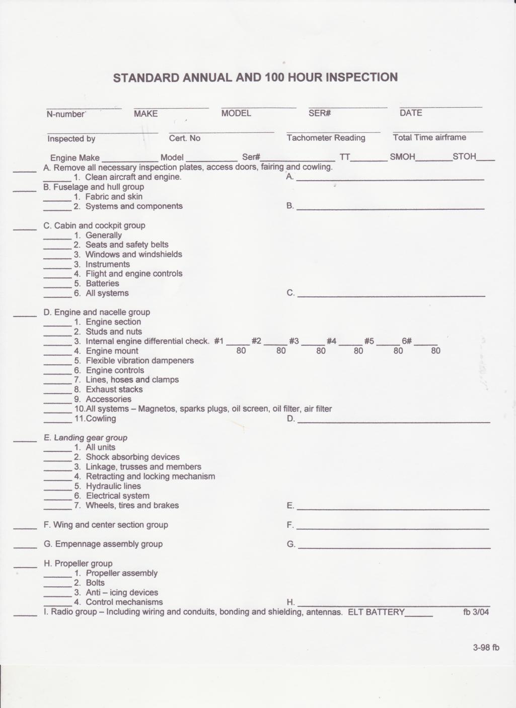

                      Carry on! This can be a great help for new and old alike. I feel the disclaimer is VERY important. I presume you have used the Part 43 App. D . as an outline and then add the Taylorcraft specific stuff. I have attached the one I have used for years.... It is somewhere on this forumn in the past.
                      • #71
                        Re: Taylorcraft Inspection Manual proposal
                        Thanks Forrest. I downloaded your checklist and will incorporate it as necessary. Yes - I am indeed following App. D almost to the letter. Not only does this hopefully keep us away from any potential legal hassles, but a lot of mechanics are used to the 'flow' of App. D.
                        I've already caught a few grammatical errors in Section 3. I didn't post it as a finished product by any means, strictly as a rough draft for people to review and give me feed-back on.
