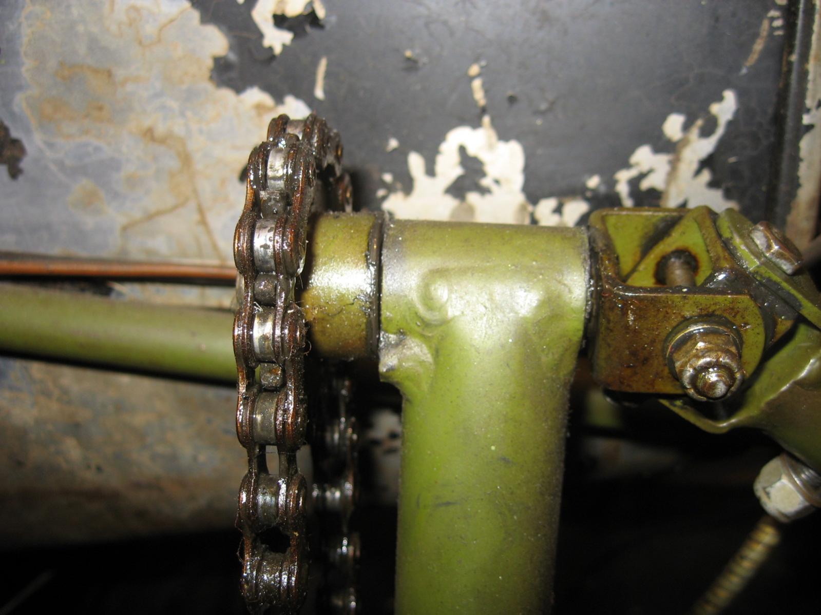

    Tore into the panel/control system last weekend. Wanted to get a good look at the aileron sprockets and work on the main tank fuel shutoff valve. It was fairly easy to take the fuel valve apart in place and relube it with fuel lube. Works like a charm now. Look at what I found with my aileron control sprockets.....they are both on backwards. The little stop pin turns merrily past its limits without a care in the world. Glad I looked into it.
      Mike, educate me a bit more... I had too many Margaritas over the weekend... I cannot see what I'm supposed to see looking at this photo. Where is the stop pin and/or the stop that is supposed to contact it?

        Bill,

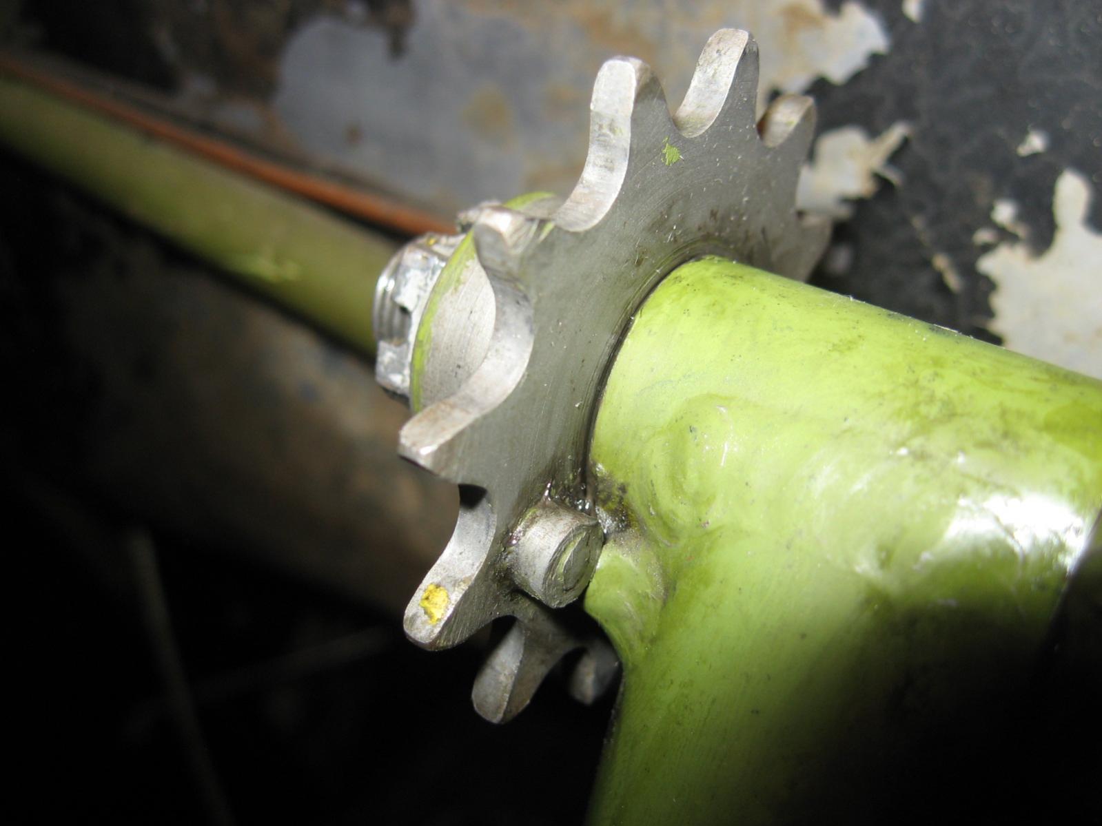

        Good point! I will take some pics tonite to show the pin and the stop. The sprocket is supposed to be mounted "flat side" to the column not hub side.

          The "pin" is pressed into the sprocket gear to prevent it from turning too far and screwing up the ailerons. With the sprocket backwards you can over-deflect the ailerons. NOT a good condition!

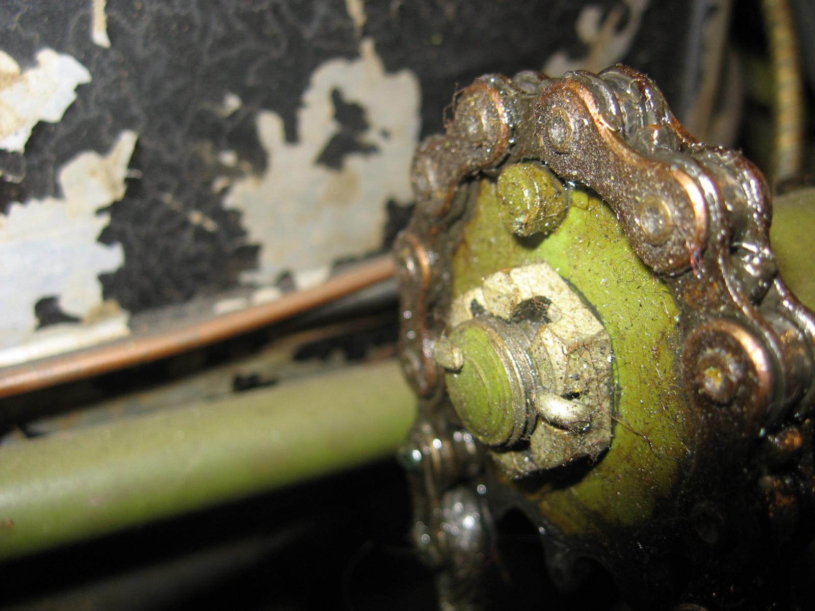

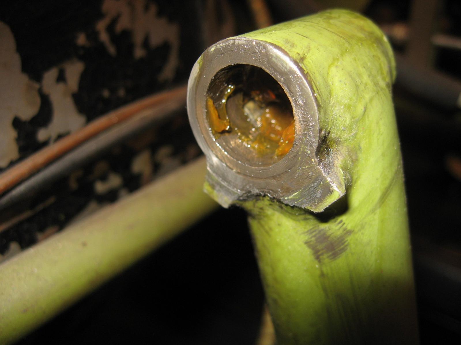

                Attached are more pics showing the intent of the pin stop. The first pic shows the sprocket on backwards and the pin facing forward(useless). Next pic shows the welded on stops on the left control column. Next pic shows the sproket on correctly and the relationship between the stop pin and the stops. Last pic shows the oil hole....which was painted over and plugged on both sides of my control.

                  Hey gang has any one given any though to creating a well detailed lubrication chart with photos of all the lub holes as in mikes photos i did not know the one on control column existed wood be a grate help in caring for the old airplanes
                  chuck

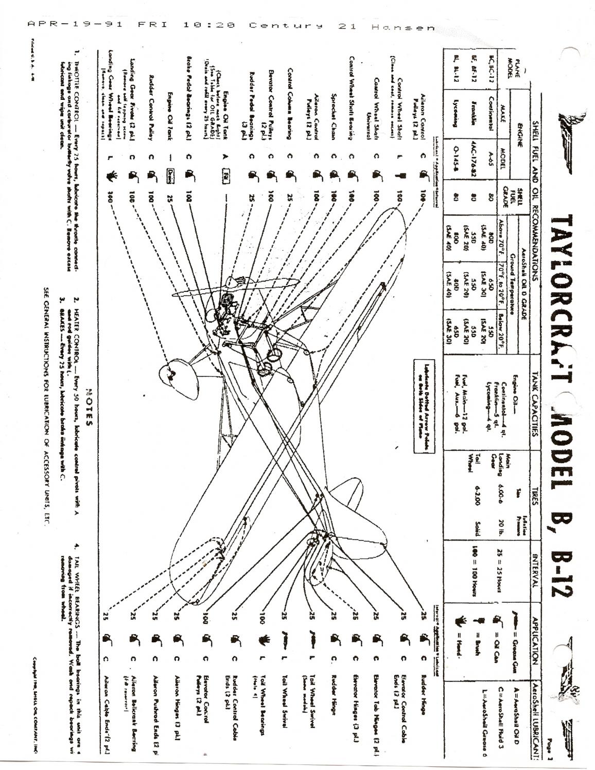

                    The lubrication chart has been done. I forget the gentleman's name, but I believe he monitors this forum. He used to attend the Taylorcraft fly-in at Columbia, CA every year.
                    It is a professionally done chart with heavy lamination. It shows every possible place to lube on a Taylorcraft, BC12D I think. If he doesn't jump on here soon, someone PM me and I will scan my copy and send it to Robert Lees for posting on the archive section.
                      Re: Bass ackwards
                      Hi Chuck
                      This is one I have.
                      Buell

                        I kind of like the idea of putting some photos out. Look how hard it has been for some of the guys to find the hole for the trim on the elevator.

                          Hank the photos that were posted of trim tab lub hole and control column hole are what i mean that showes me what to look for

                            On the lubrication chart Buell attached above, Note 4 states “... damaged if incorrectly removed”. Anyone know details pertaining to this statement?
