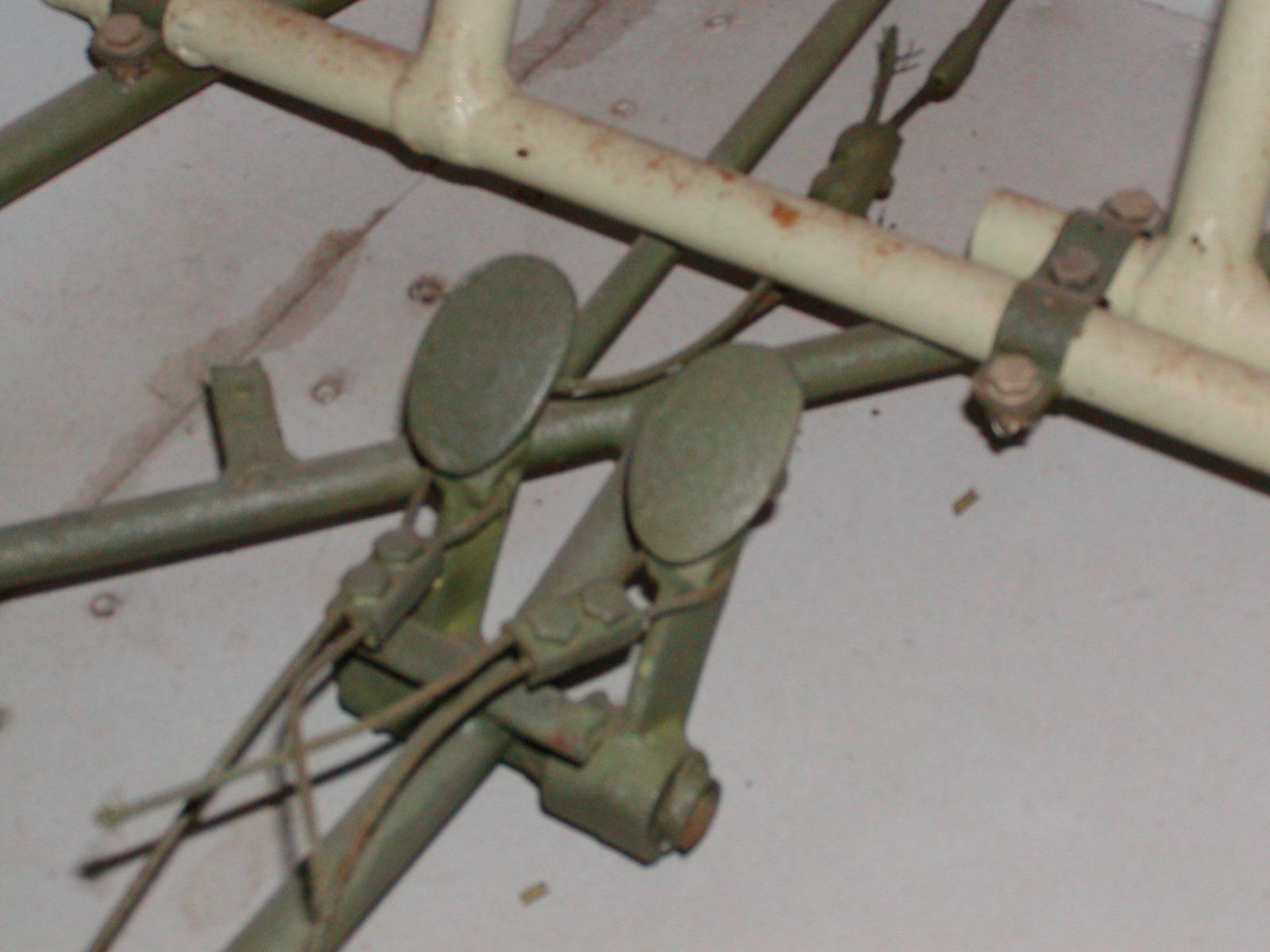

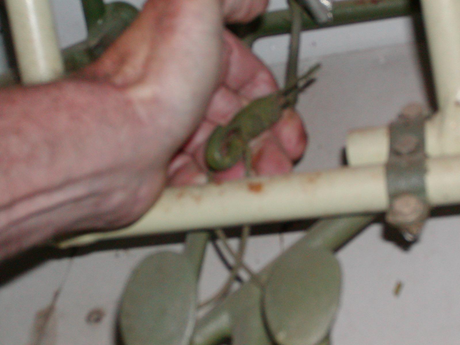

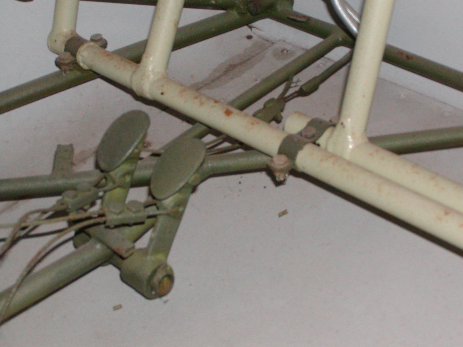

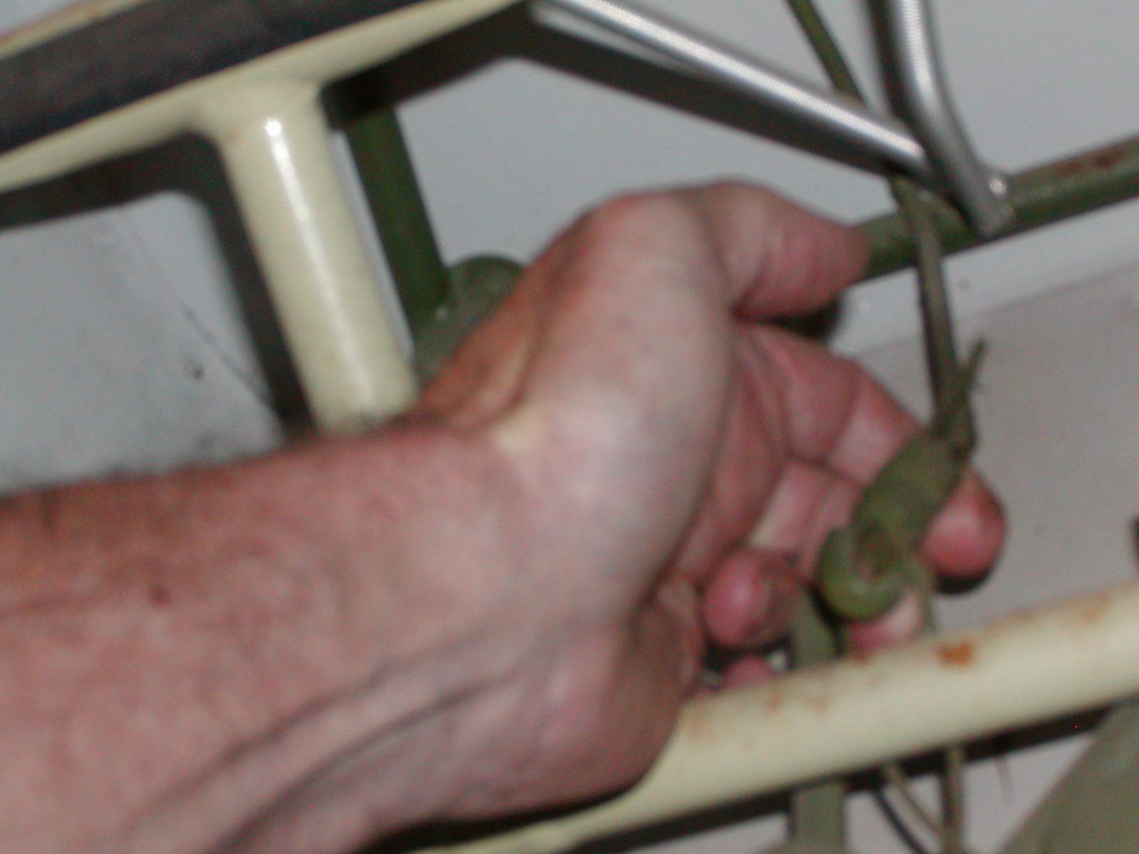

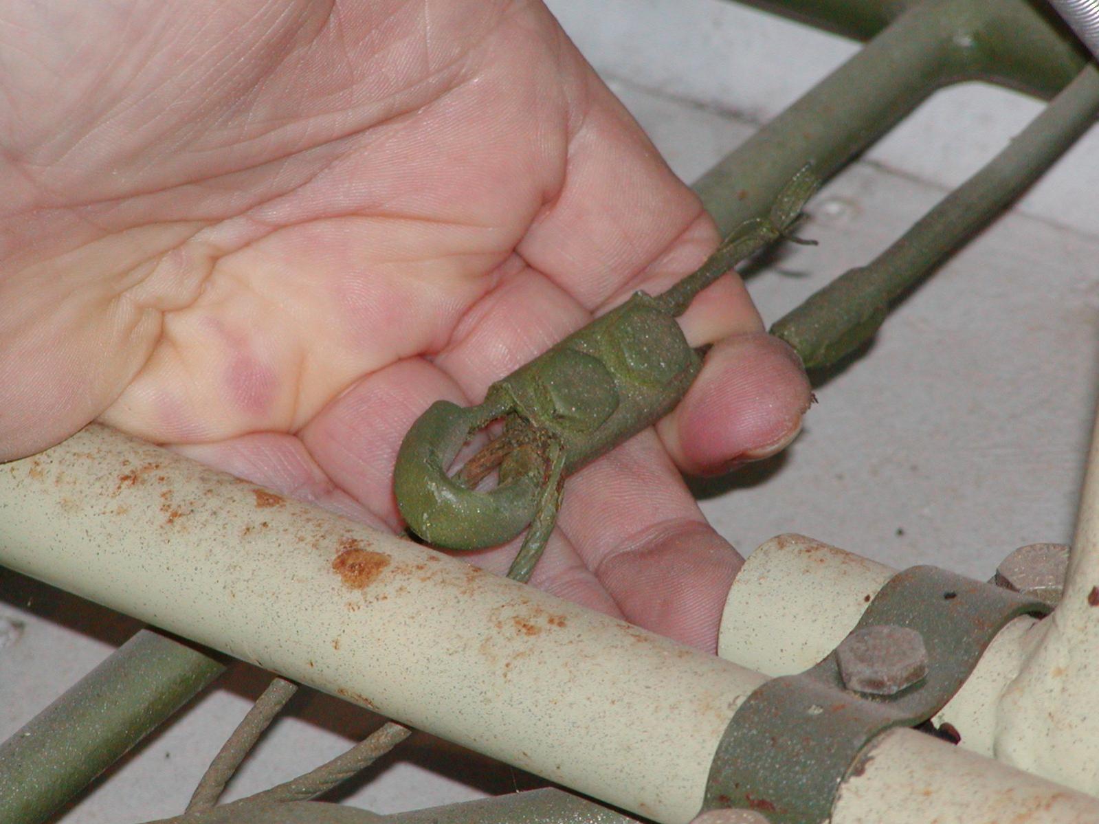

      Kinda hard to get in focus but here are a coupla pictures that might help you
        Re: Parking BRAKE CABLE
        Here's a better picture, it appears that the main brake cable is formed into a u shape with a "thimble"? on it and shortened way down, it also looks like the clamp itself was the only means of adjusting it. And yes my cables are in dire need of replacment, thats why it's a project.

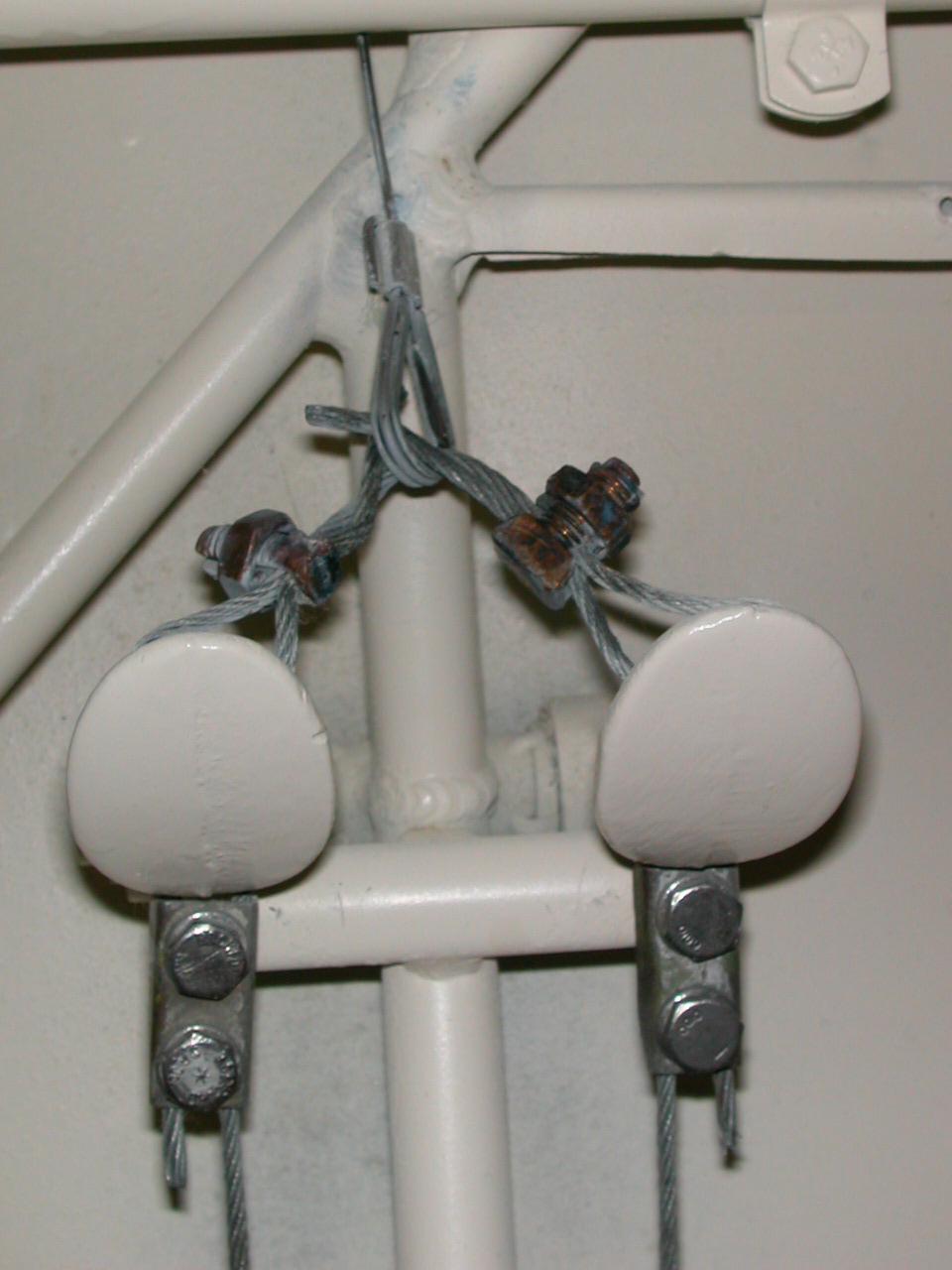

                Photo attached of my parking brake cable connection for comparison.
                Ditto the don't trust it: The only time I use my parking brake is when hand-propping alone -- in addition to chocks, a rope around a post, the fuel shut off, the control wheel tied back with the seat belt, and the throttle friction tightly on idle.

                  Thanks Jole. Thats the picture I was looking for. Do you know if those cable nuts are original? I do not like the idea fo a nicopress on that short little cable between the pedals. No way to adjust the length and you have to remove the pedals with everything else. Plus if you ever want to diconnect the brake this makes it simple.
                    Laz,
                    Yes, I think those cable clamp nuts are original.
                    (Nothing wrong with Nicopress sleeves though -- according to a May 1944 Taylorcraft news release quoted in Chet Peek's book, it was Taylorcraft that introduced Nicopress sleeves for swagging aircraft cable ends, replacing the labor-intensive splicing method.)
                    I'm looking at the 1940s factory parts price list for the BC12-D, and it lists:
                    p/n 0703, 2 per airplane, Clamp - Parking Brake Control Guide, $0.25
                    and I think that short length of cable between the pedals that the parking brake cable grabs is:
                    p/n B-A528-2, 1 per airplane, Cable - Equalizer, $0.20
                    Good luck finding those little cable clamps. If you do, will you post the supplier and part number back here?
                      The clamps in the picture are called electrical split bolts, used in the electrical trade everyday. There are a couple of types, one of them match's yours exactly. Larry
