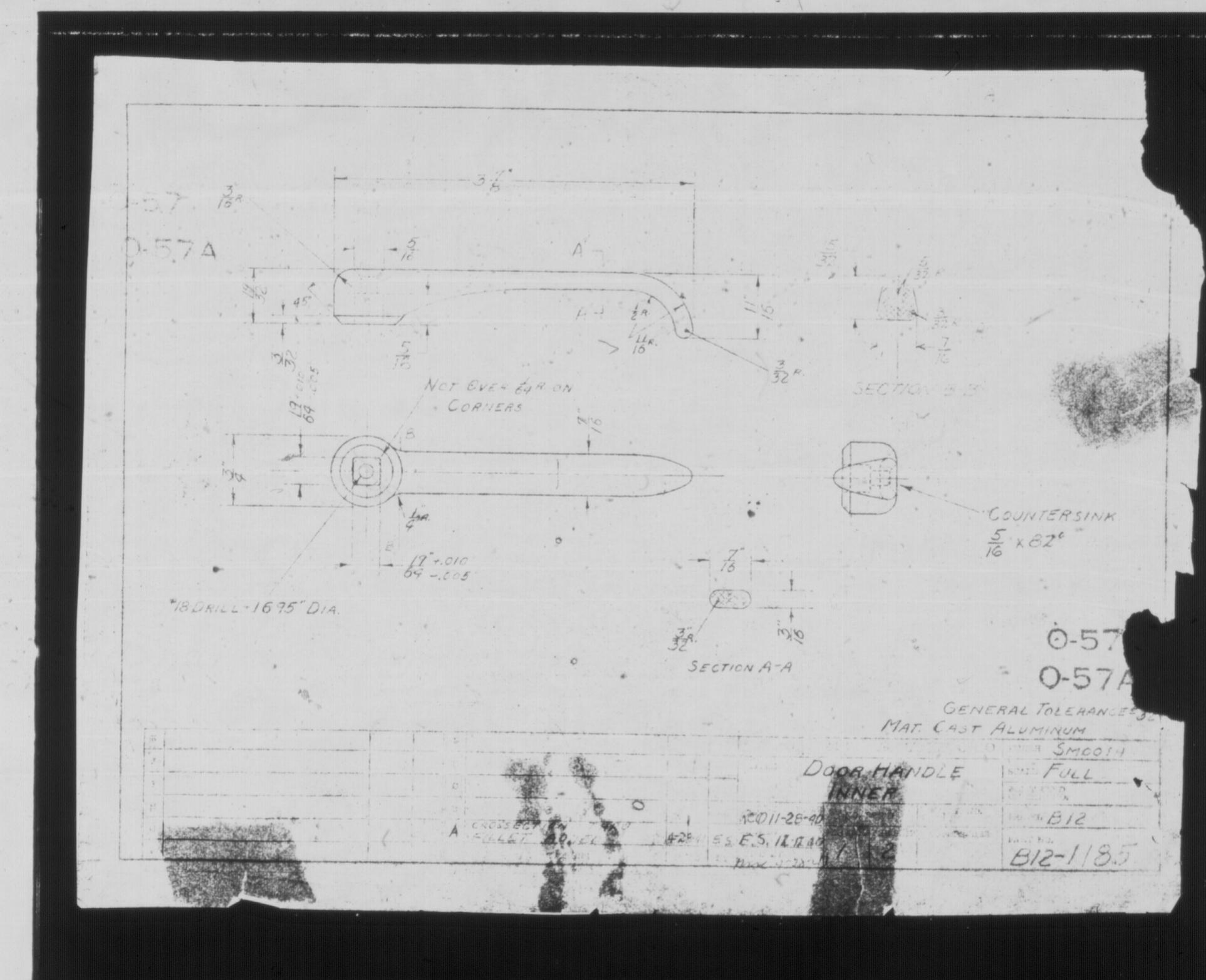

    Glen,
    I have attached the blueprint for B12 1185, it is used on the L-2 and probably with a B prefix is also used on the B models, I just have no idea which ones.

      Ron,
      Thanks much, that's exactly what I have.

        That's the one on mine too.
          Re: Door Handles
          Hank,
          Great, so they also correct for the '41 Deluxe.

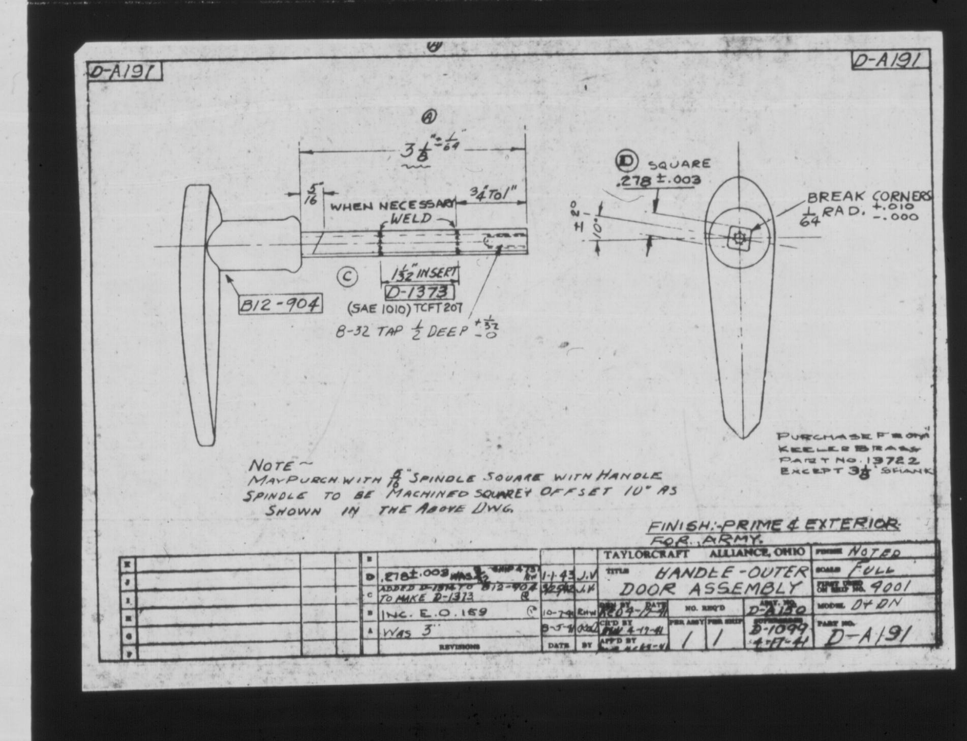

              Ok, who made them back in the day? Were they subed out? Tim
                Re: Door Handles
                The L-2 outer door handle was made by Keeler Brass part #13722. I contacted them several years ago and they could not cross the part number. Drawing attached.

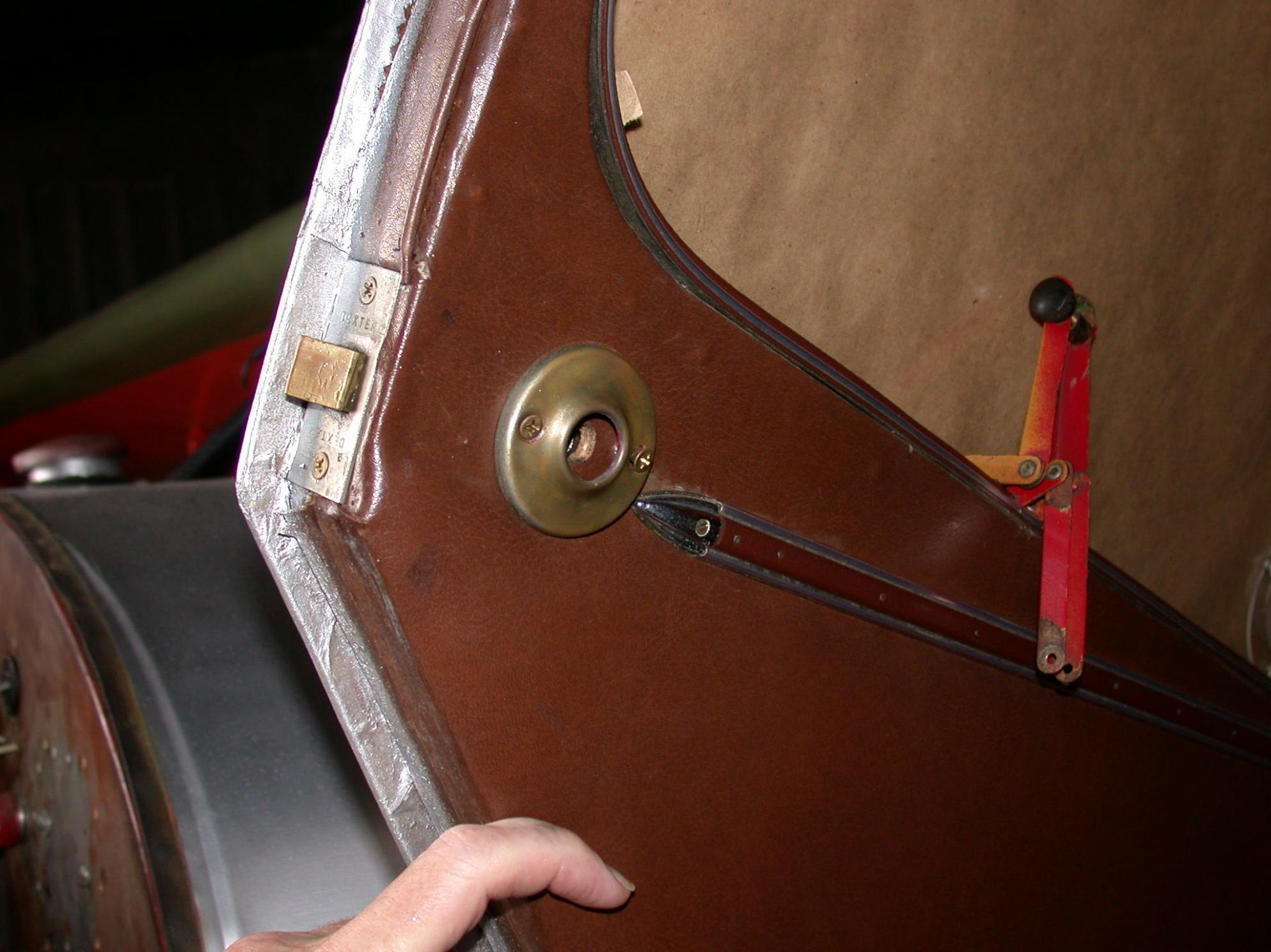

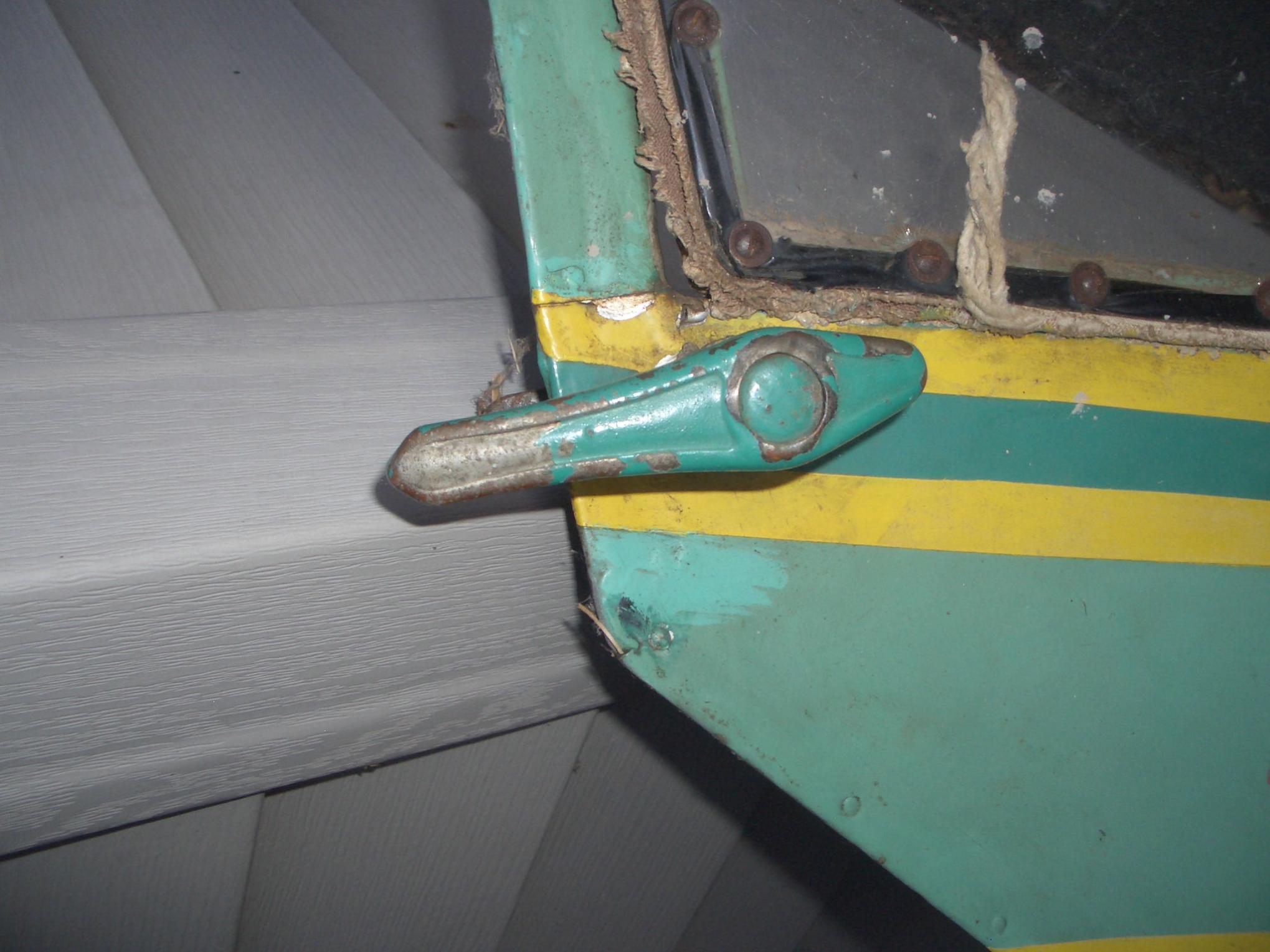

                      Here are some picsa of from my 41 Deluxe. Look origonal but who knows? The inner handle is held on by a flat head screw. Larry

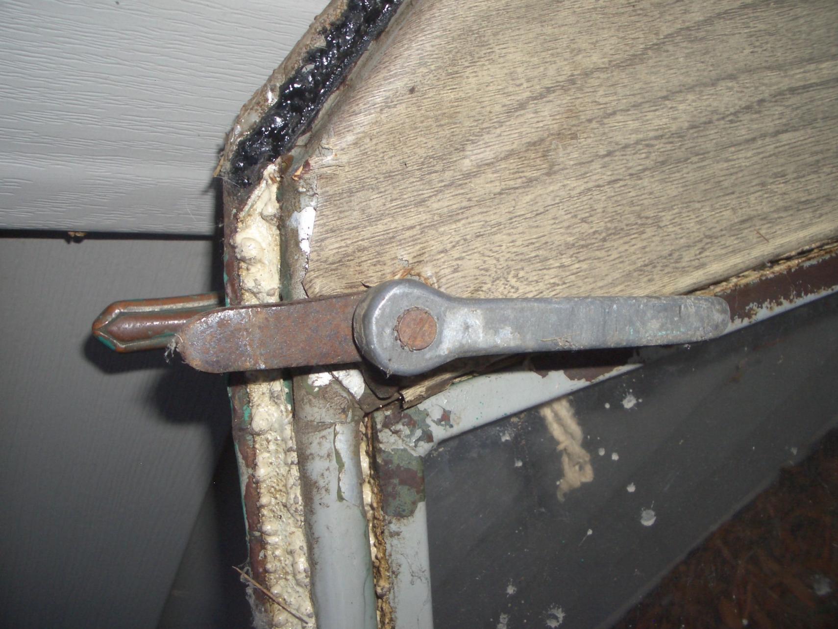

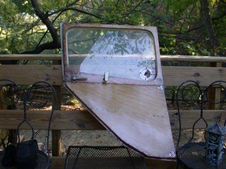

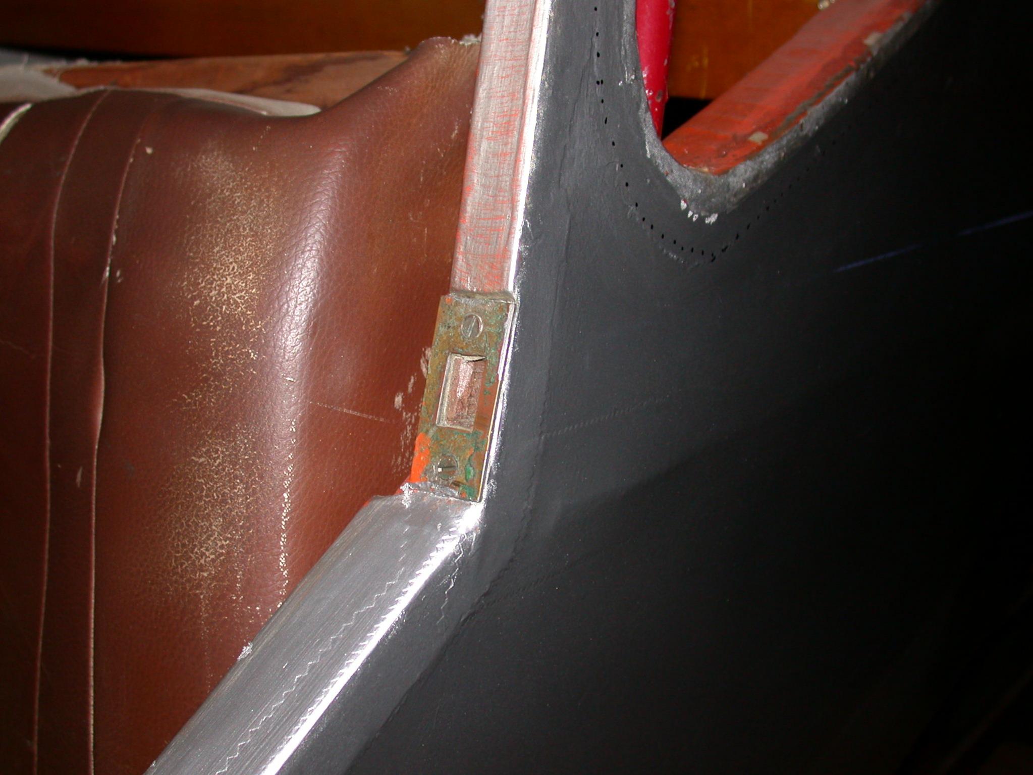

                        This is my 41 door. The striker and latch mechanism matches some pictures from before WW-II. The latch is an old design screen door latch that is still made and available at a lot of hardware stores.
                        The 41 door was wood and this is mine after I striped off all the upholstery. The hinge cap nuts are NOT original. The hinges were held in with plain wood screws and were NOT solid. Machine screws and cap nuts are solid as a rock, even if they are not original. Don't tell on us.

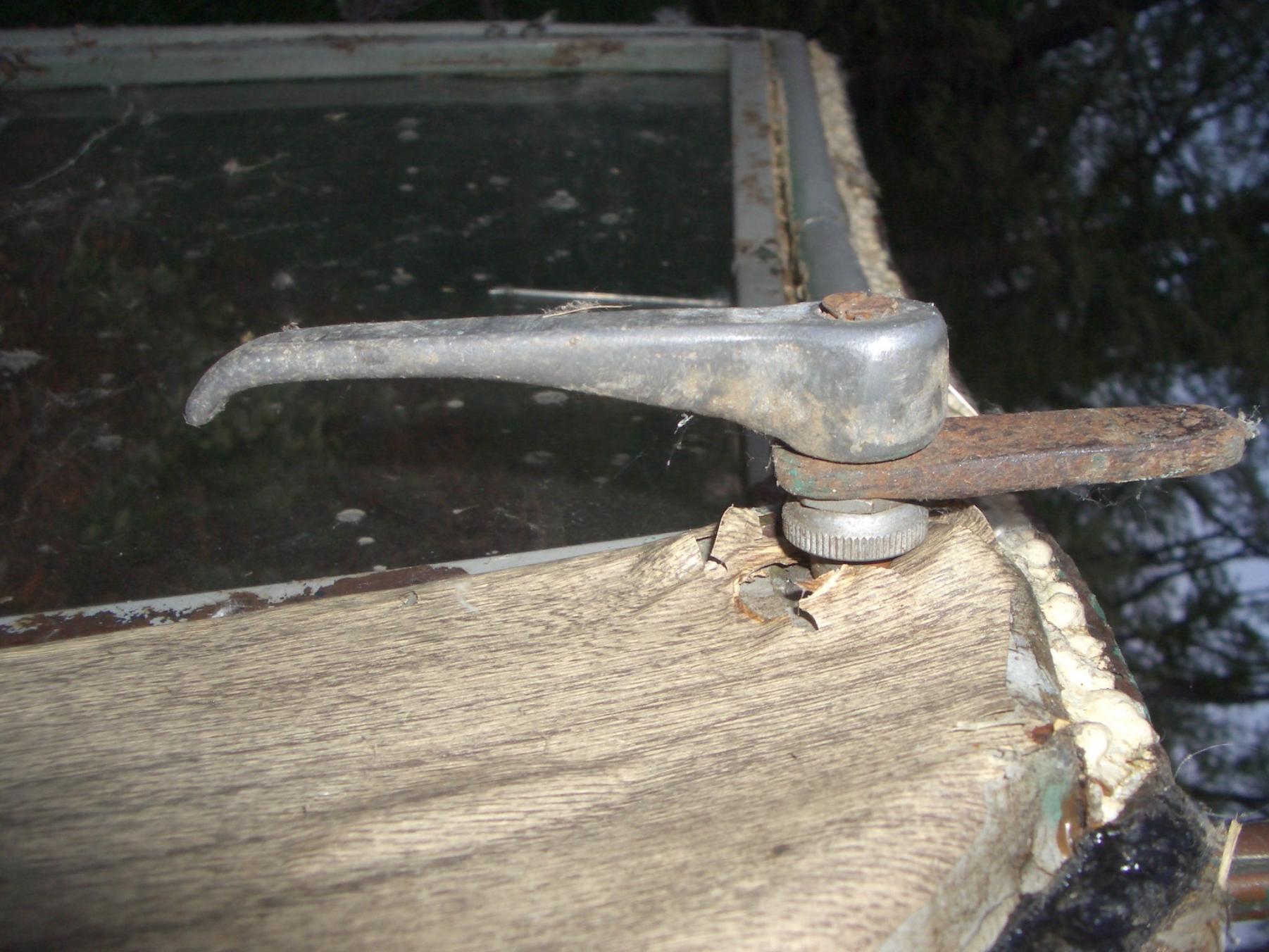

                          Hank,
                          The 41 window latch. Is that something that is availble in hardware stores?
                          Ray
                          Ray
                            Re: Door Handles
                            I needed new springs for mine to rebuild them and the "Old Dog" at the local corner hardware was helping me. As we were going through all the springs trying to find the right ones he asked me why I didn't just replace the whole latch.
                            I told him they were for a 1941 antique and he walked in back and came out with a couple of brand new ones off the shelf! They are still being made. Even have the same markings on the case. I wanted to stay as original as I could so I bought them and used the parts to rebuild my old ones.
                            Yes, they are still available. He said they were used on the old style, thicker wood screen doors you see on older houses.
                            Can't remember what I paid, but I do remember thinking they were CHEAP!
                            Taylor used what was available from hardware stores and car parts dealers.

                              Interesting, my doors are steel with aluminum skin. No sign of ever having a latch like yours on the door or the fuslage. My serial number is 2540 however how many times has it been rebuilt? I have not looked at my CD from the feds lately. My doors are not light but not that heavy either. I will have to weight them. Larry
