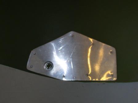

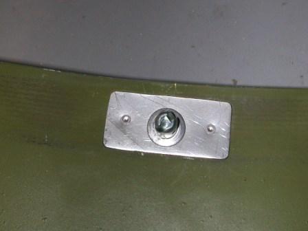

                  Mine were stainless (March 46 BC12D) as were the reinforcements on the upper hinged cowls and the reinforcements for the Dzus fasteners.
                  Because they were all riveted with those pesky steel rivets, I can only assume that they are original, especially since the lower cowl was butchered to fit the Brackett air filter.
                  Mine were all installed on a pre-painted surface, with "Pigeon Poo" Duralac as a sealant, and wet-riveted too.

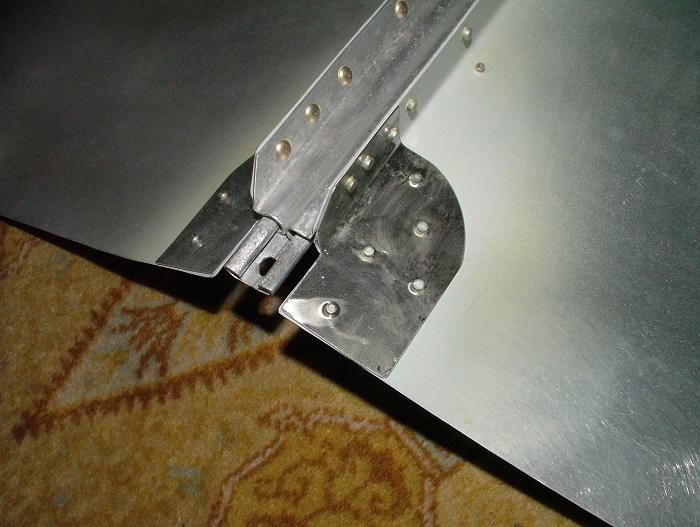

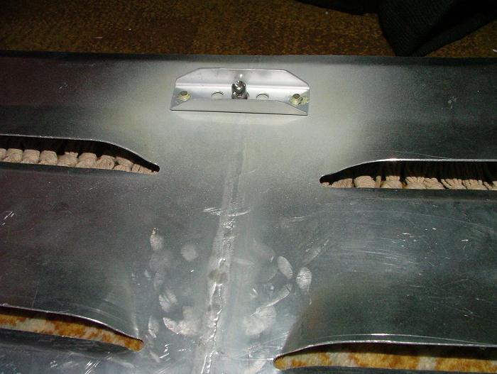

                    ...The other place mine have cracks is where the cabin heat support bracket connects to the cowl in the middle. That spot really needs a doubler.
                    This is what I did. No cracks.
                      Re: Hexagonal reinforcement patches on lower cowl?
                      Thanks, Rob. As always, a photo from you is worth a thousand words.

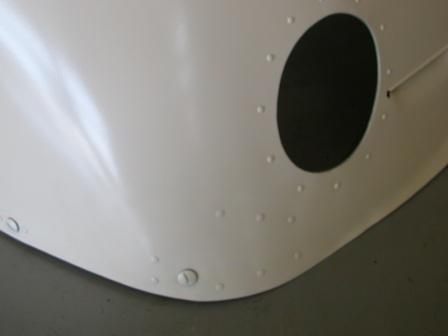

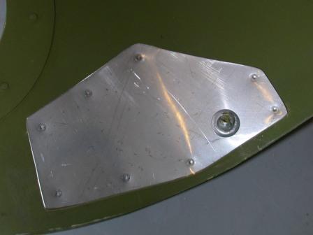

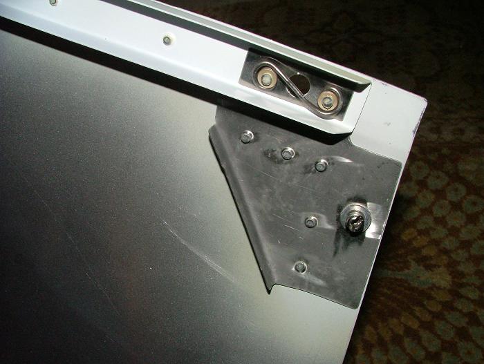

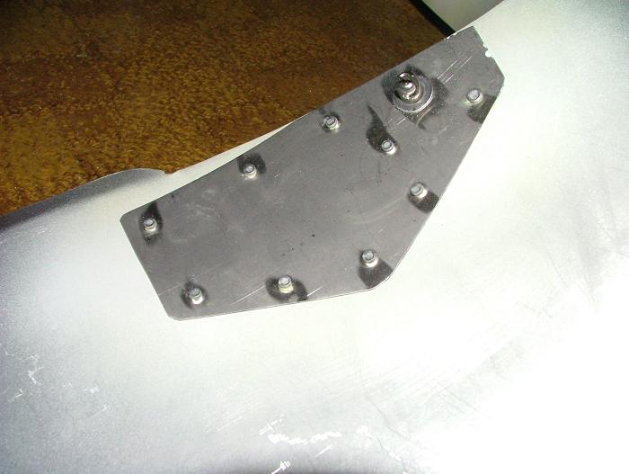

                        Photos attached of my new stainless steel doublers on the lower cowling, owner-produced parts made according to Larry Haas' drawings. Thanks, Larry!
                        (No, didn't make them myself -- had some shop credit to use up at the FBO, so commissioned an A&P to do the work.)
                        Yet another detail to benefit the new owner of my plane...
