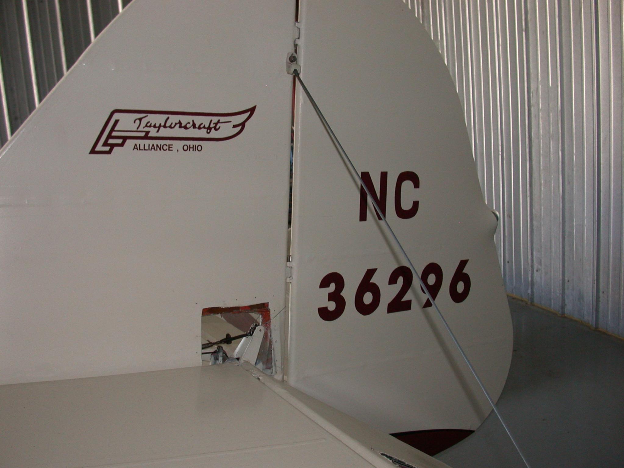

                        Looks like rotten weather again this weekend but if I can get out to the airport I will measure them. I attached a picture of what they look like. You will need two top wires and two bottom wires (they are different).
                        You also need 8 nipples, 8 jam nuts, 8 half round blocks, and 8 flat wrapped fittings that the bolts go through (they are also different and have to be put in the right locations).
                        There are also special washers so the bolt threads aren't in bearing and 5 bolts, washers and nuts.
                        If I can, I'll try and get close up pictures of each type of assembly for you.
