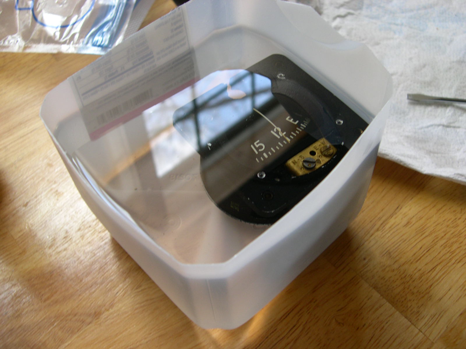

                    "Compass fluid" can be purchased lots of places. to get the compass "full" requires a knack , in the old days when we ( A&P) could do this major repair we would have a can of compass fluid and submerge the whole thing till the bubbles stopped. there is a bladder in the system that comes with the repair kit. I am going to my IA refresher in two weeks and will talk with the CLE FSDO & MIDO about a lot of things.

                              Thanks Forrest for the "submerge the whole thing" tip. That works great. The picture shows a compass (a boat compass) submerged in baby oil. I used the bottom half from a 2 quart plastic milk bottle and 20 oz. of baby oil, both from WalMart (the compass came from a boat).
                              Baby oil is a bit more viscous than the kerosene that was originally in the boat compass. The thicker baby oil makes the compass slower moving and more stable. It's less prone to overshoot the heading and less inclined to hunting and spinning. That's good and my impression was that the baby oil had improved the compass.
                              However, I was a little worried that baby oil might be too viscous at low temperatures. So last night we set the boat compass outside...it was about 5 below. When we brought it back inside this morning it's operation was definitely sluggish. It took 90 seconds to turn through 180 degrees. After the compass warmed to room temperature it would turn the 180 degrees in about 20 seconds. My conclusion: baby oil compass fluid is great at normal temperatures but might not be best for folks who go boating in very cold conditions.
