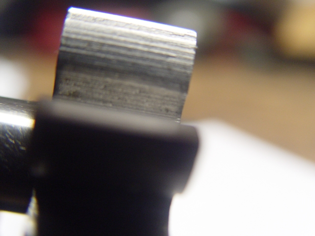

    I ordered a new set of oil pump gears for my about to be A-65 and received a perfect drive gear and this oil pump driven gear. It was full of chips and burrs which I rubbed down before I returned it for replacement. The replacement gear which I just received is about half better. Both gears came in a Continental parts box. It creeps me out to think that I would put this gear in my new engine.
    Would this be serviceable? Will it wear in? I know that some one on this forum has real life experience with this situation.
    Thanks in advance

    Looks to me like it's been broached but not ground afterwards.

      That's NOT a gear, it isn't even a paper weight. :kotz: I would be calling the supplier and asking him to personally check the next one and ask him to consider if he would fly HIS family behind it before he ships it.
      Be friendly, mistakes happen (sometimes they even happen twice) but he needs to consider his companies liability if a half baked A&P (and we know there are some out there) had installed that gear.
      I wouldn't drive with that gear in a car glove box, much less fly it in an airplane engine.
      Stay polite and friendly! You need to assume he is on your side and will be as upset by the quality as you are. They don't look in the box before they ship. HE has a problem with HIS supplier and he needs to read them the riot act.

            I beleive Robert has the correct answer.
            It looks like a run is missing the grinding operation.
            Have your supplier look at all his supply before shipping you any more.
