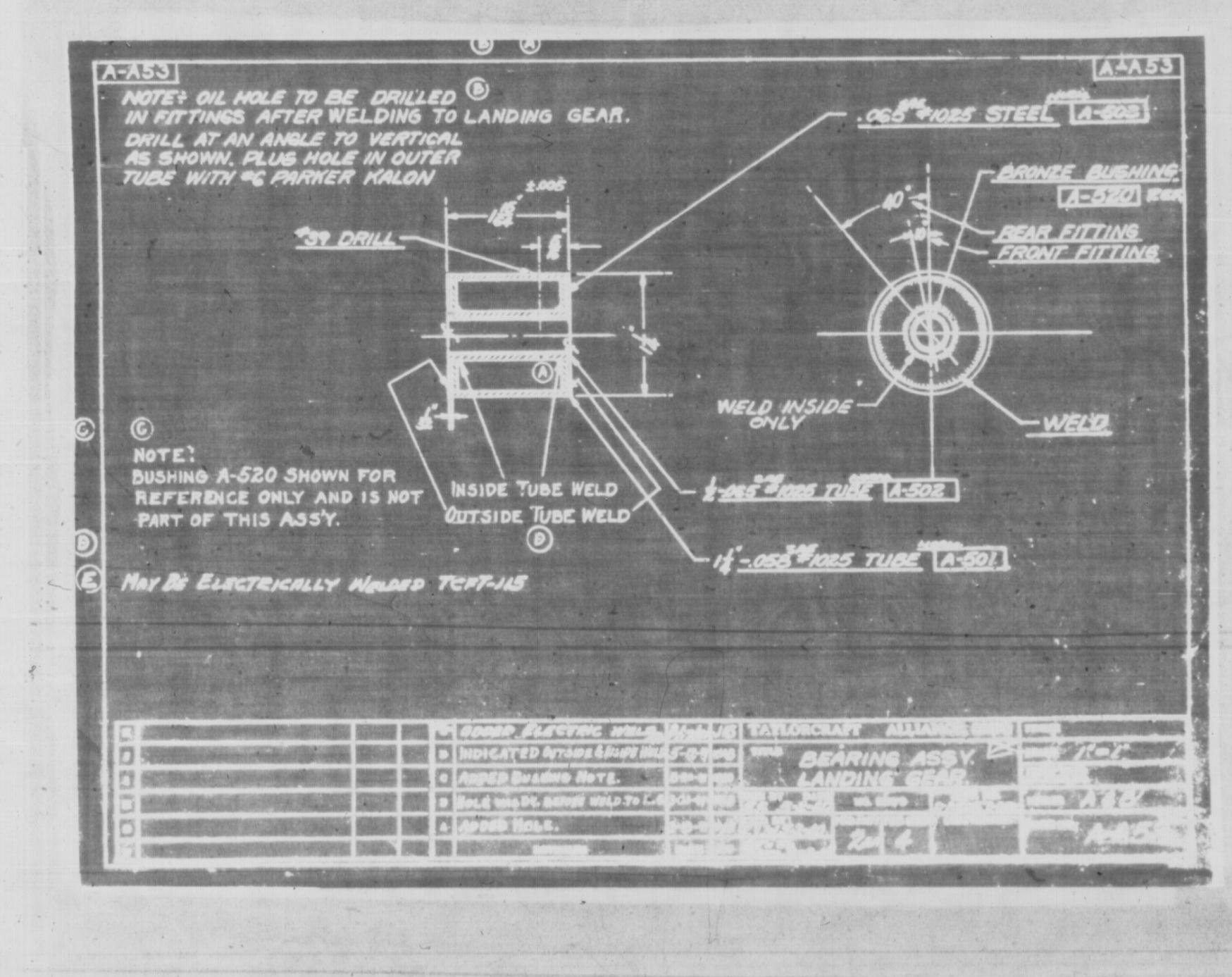

Looking at the L-2 gear it has a bushing. The part numbers suggest the B models also have a bushing. I will attach the drawings for the L-2 which use an A pre-fix.
