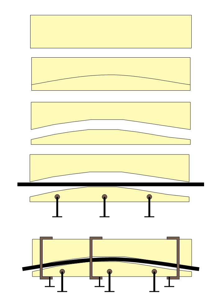

                  Depending on how long the piece is you want to bend, here is a way to make a simple tubing bender. Take a length of 2X6 and lay out the desired shape. Since tubing has a tendency to spring back a little, your layout should be about 1 1/2 degrees more than your final desired bend. Using a scroll saw cut the 2X6 in the desired shape. Lay the pieces on a flat surface and clamp one piece of the 2X6 down. Lay the tubing in between the pieces of 2X6. Use C-clamps to compress the shape. Usually 3 clamps, one at the center and one at each end will suffice. You may have to help it a little, by heating, but don't overdo it. Don't want to catch the wood on fire.

                    You can reduce the "surprises" by routing a half round cut into the two mating surfaces. The tube is like a spring as you apply pressure and will move towards the lowest energy position. If that is to twist out of plane and fly out from between the pieces of wood, it will do that and fly up in your face. Not recommended unless you take extra underwear to the shop with you.
                    When we bent tube in an industrial setting one of the key parts of the process was to have a smooth fit to the tube sides to prevent it flattening out (another lower energy state). The routed groove will help with that too.
                    The tube bender also put tension on the tube and actual stretched the tube around the mandrill. I don't think you will be able to do that so I don't know how successful you will be.
                    Go to a muffler shop and watch how the machine pulls and bends the exhaust pipes around the tooling. Exhaust pipes are mostly SS and mild steel of much larger diameters than we use, but the principals are the same.
                    Good luck and don't flatten too much tube (and especially don't put any round dents in your skull!).

                      Thanks Hank. I forgot to mention routing the groove. The first time I tried this, the tubing popped up but the C-clamps caught it.
