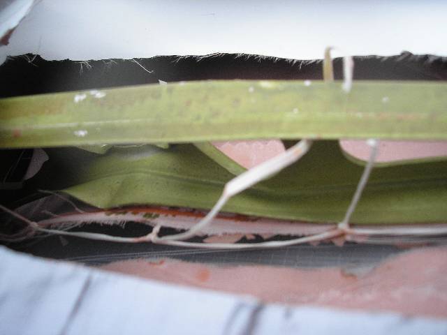

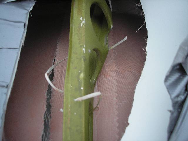

    I was wondering if anyone had an extra or perhaps knew of a source for aileron ribs? One of mine was damaged when the plane slipped off the jack while changing over from skis to wheels. Are they repairable if they aren't mashed too badly? Thanks in advance for any info.

    That rib looks like it should easily be repairable as long as both spars are still good. I just sent you the fuel tank mod info in two separate emails.

        If you can get a replacement perfect one, use it. It looks easily repairable and should be fixed even if you don't end up using it.
        There is always someone who will have one in worse shape and need that one.
        If you just want to trash it, I will pay to ship it, fix it, store it and pass it to someone who needs it. I just built a shop in my hangar with plenty of storage space on top. DON'T throw it away.

            You need to understand I kind of have a reputation around here for wanting to fix EVERYTHING. I'm a believer that almost anything can be repaired if you can't get another one and never throw a broken part away. Of course, some of the repairs consist of making a whole new part. All it usually takes to fix a part is a little learning, some practice and a lot of patience. The Taylorcraft was built with less technology and tools than some of us have in our garage now. Don't be afraid to try. It's a blast to bring a 60+ year old part back to life.
