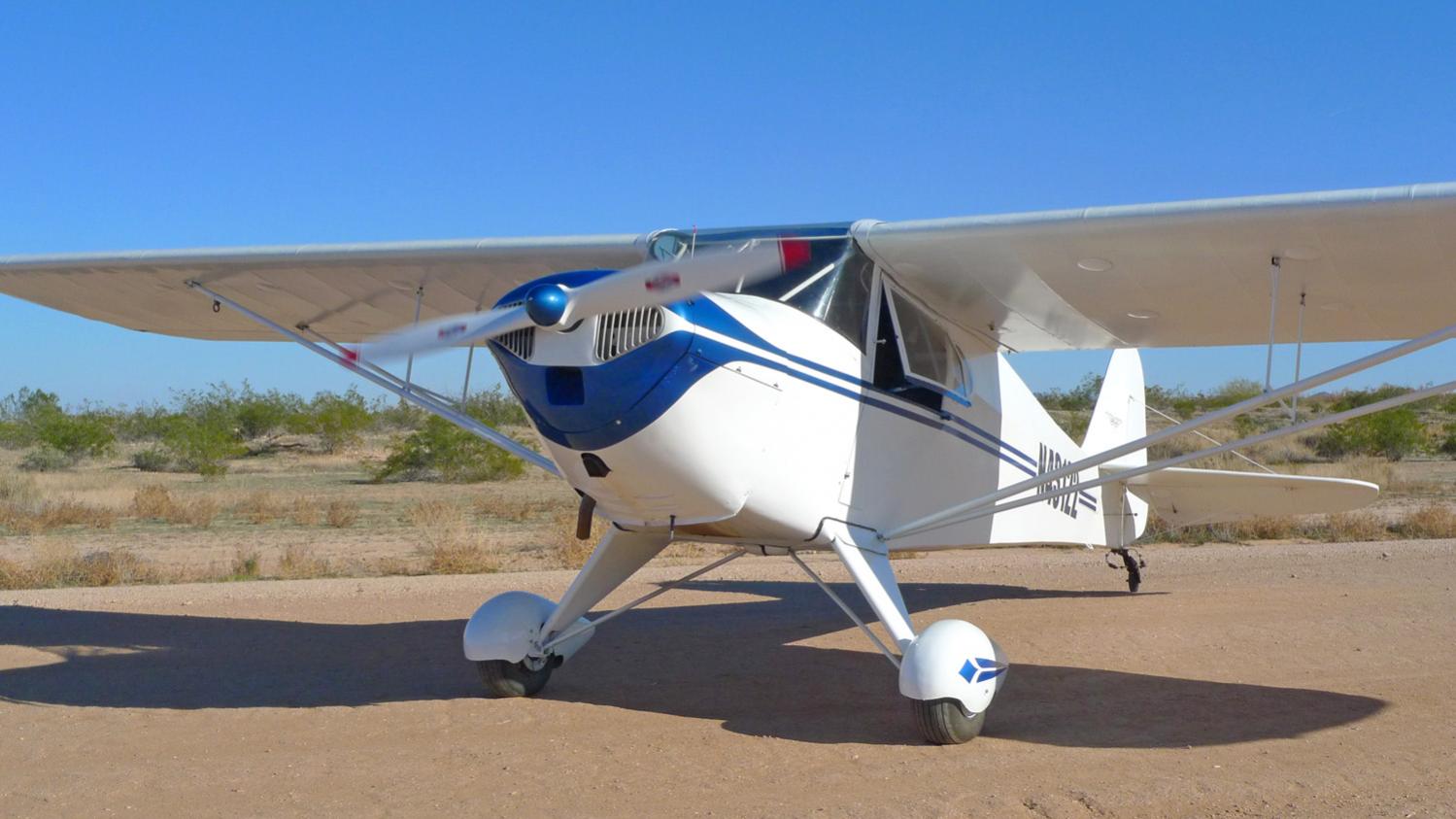

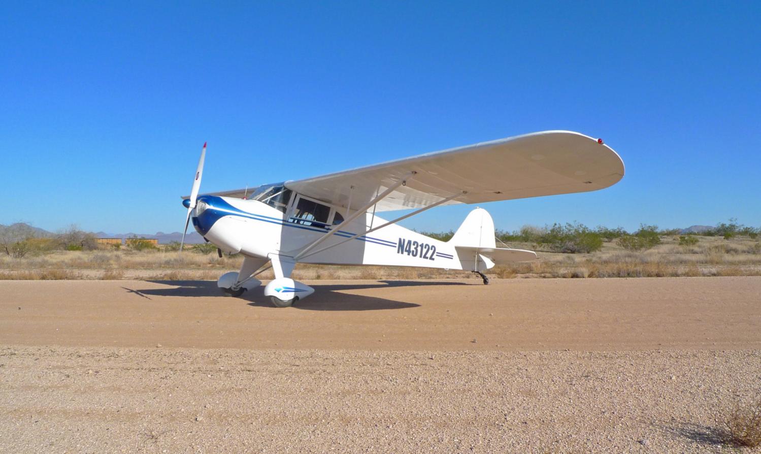

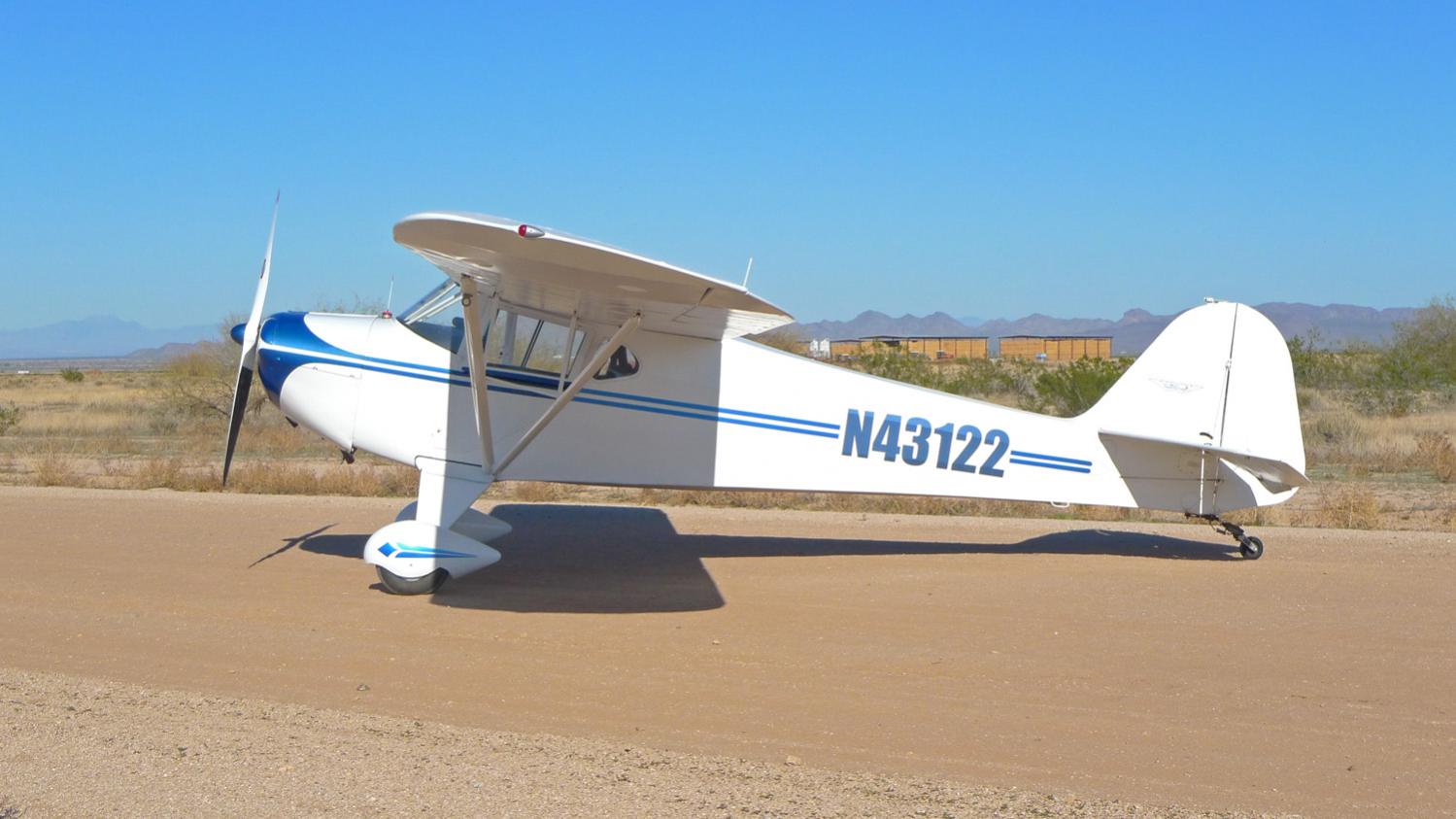

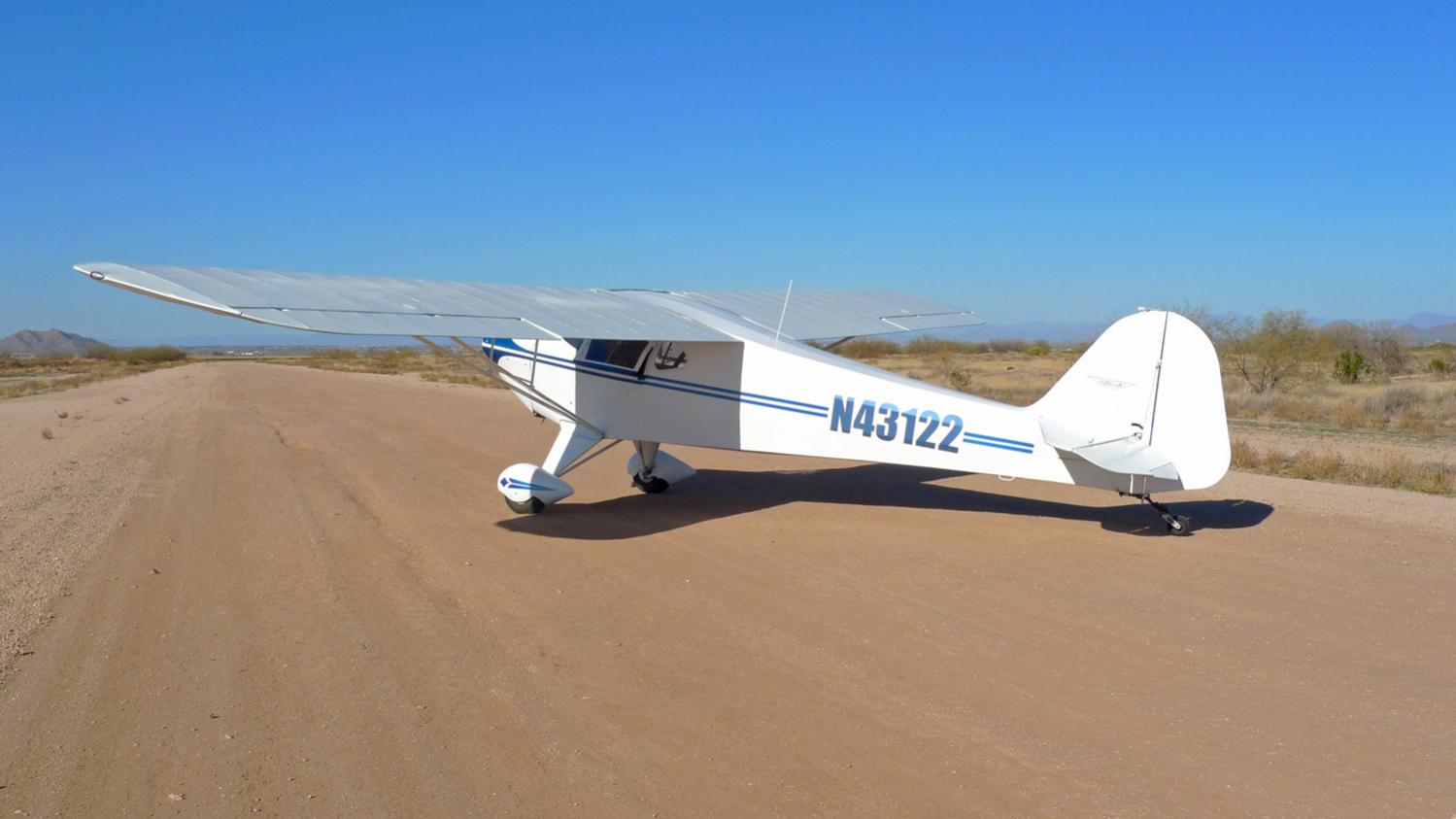

    after about 7 or 8 months out of service we finally got 43122 back flying a few weeks ago. While it was down we rejuvenated the dope and repainted the trim colors.
    pics shot today at an old 2500' dirt strip near Casa Grande, AZ that Ag pilots use to refill their hoppers.

    That looks real sweet...congratulations!

      Nice pics!

          Rejuvenating took about 4 hours on a Saturday and 4 hours on a Sunday. REALLY simple to do. We washed the plane thoroughly with some soapy water. Then took MEK and a rag to the areas where the paint had cracked.... used the MEK to melt the cracks and smooth them out. Hit those areas with a small touch up spray gun and white dope. Wet sanded the entire plane lightly with 320 and rinsed with water. Taped off the windows and other pertinent parts and proceeded to spray the rejuvenator with a twin turbine HVLP gun. Rejuvenator is SUPER easy to work with. it's thin so you got to be careful not to get runs but it dries in about 15 minutes with a nice even semi gloss sheen.
          Our fabric and paint was done in 1971 if you can believe it. Irish linen and Butyrate dope. it sat in a garage for 30 years which is the only reason why it was as good as it was, but the paint was very flat and faded and quite brittle. The rejuvenator worked miracles. Paint is very pliable now. I have no doubt it'll last us at least another 3-5 years if we keep the covers on it during the summer.
          From the boot cowl forward is all new automotive single stage acrylic enamel paint. We also used the automotive paint to refinish the prop. What a difference painting the prop made. it used to be an ugly faded gray.
