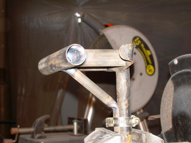

                        I made one of the extensions, it may need a little tweaking but I think it will work. I may put a small bolt through the top if I fly quite often. The way it is it can be off and on in seconds and it is plenty solid.
