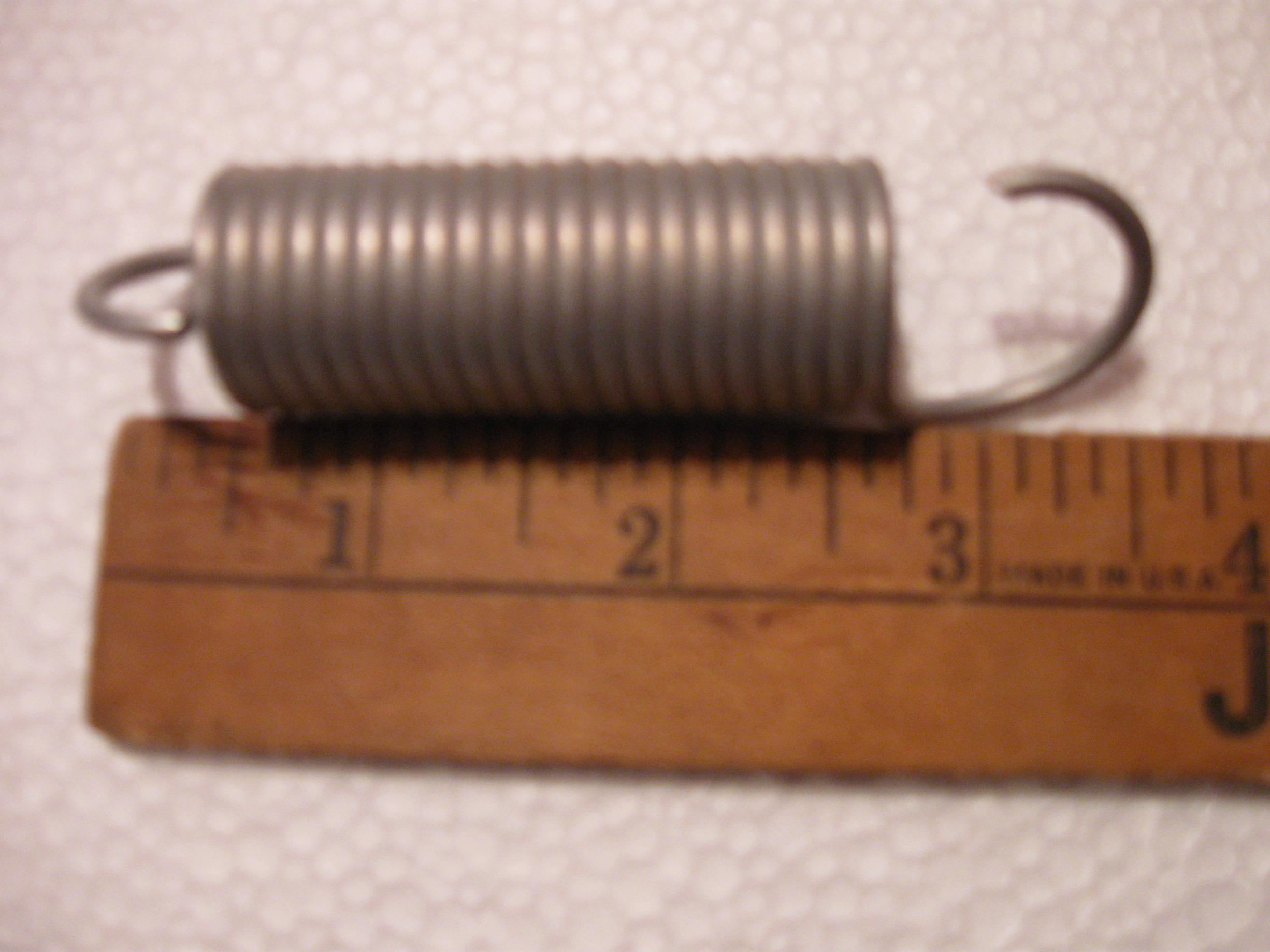

      Kind of fuzzy , forgot about macro. THIS is a genuine spring used for the B models, D models , F-19 and up with 6 in tailwheel , they work on the 8 in too. The larger open end on the right goes DIRECTLY to the rudder arm and the more closed end is where the chain starts , then the clip goes to the tail wheel arm. No need to make them real tight , if a chain has to be longer for correct tension make the right side the short one.
      Not as quick a response but that is good sometmes; no argument on which is best. Giving Dual perhaps a slower response is best.
      That is the reason the creator made chocolate & vanilla ice cream. choice is good.

        Do you have a pair of the pictured springs for sale. Let me know and I will contact you offline about a transaction.
        For anyone else with really strong springs; after many years with strong springs the holes in my rudder arms were enlarging where the springs hooked on. An astute IA found and solved the problem during an annual before the springs pulled through the remaining metal on the arm. The solution was to insert an eye bolt into the hole in the rudder arm, then hook the spring into the hole in the eye bolt.
        These planes are all old and we need to keep an eye out for things like that.
        • #34
          Re: Is your tailwheel steering secure?
          Many arms are reinforced with a bushing! If you do the shackle thing then you have to shorten the spring, I think Rob Lees used the shackle method. No I do not have springs for sale, rumor has it that we make them when needed. A spring is a spring is a spring....
