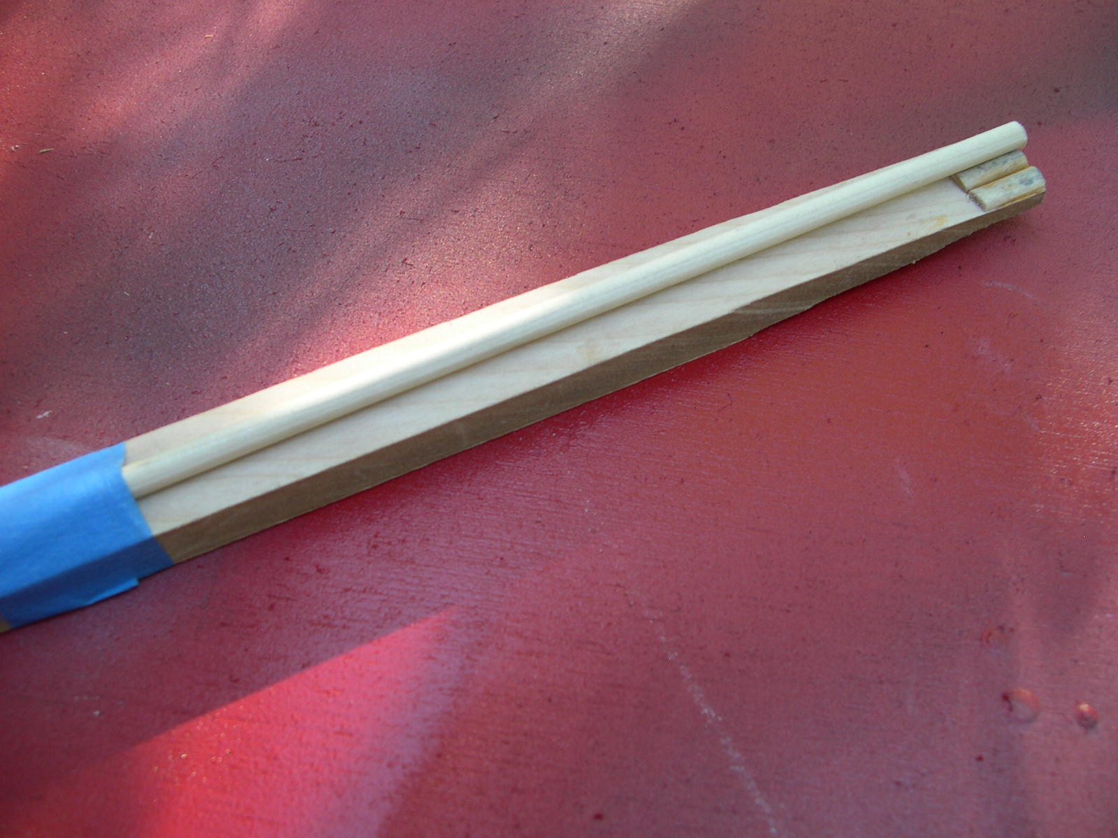

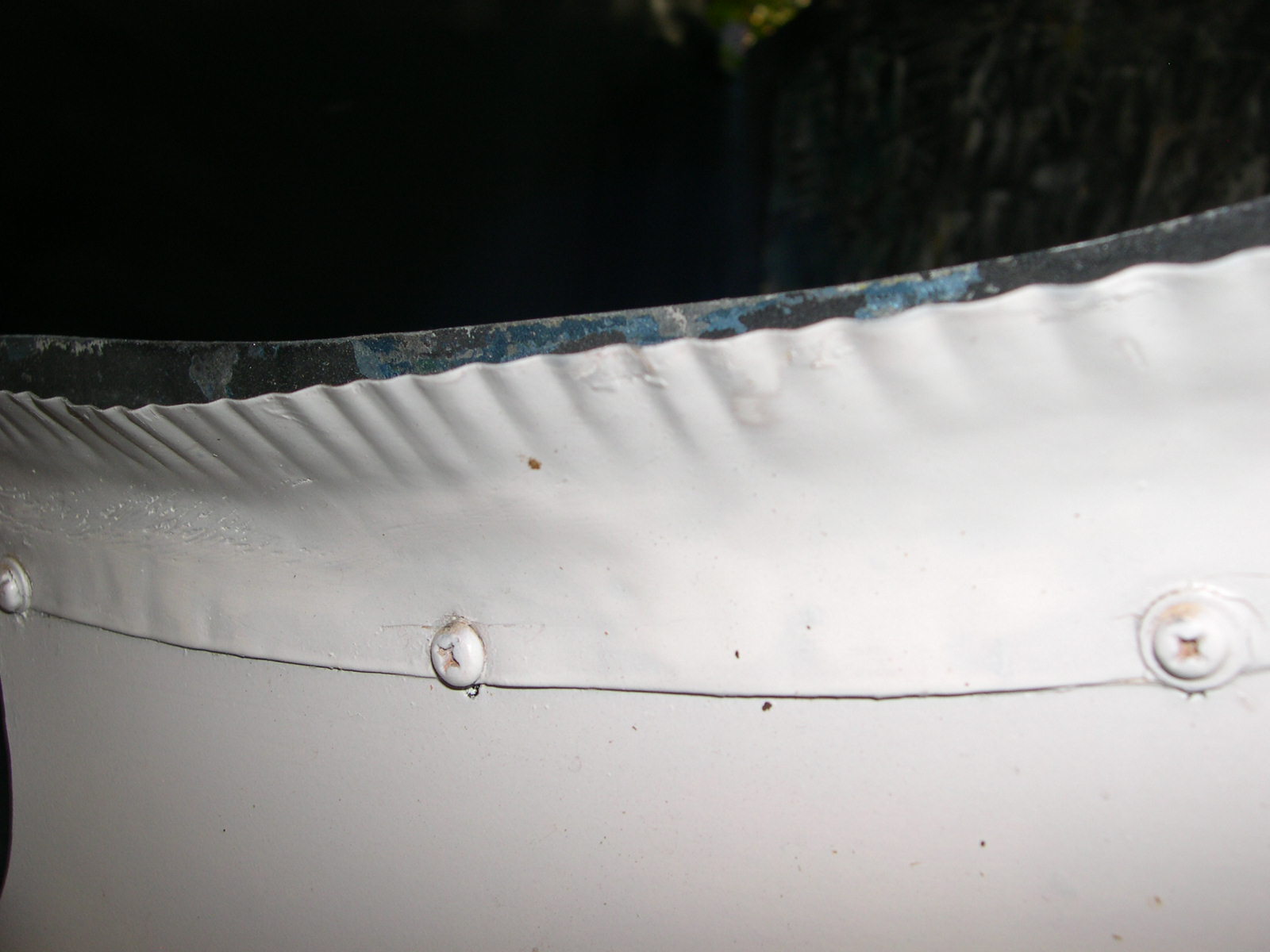

    Joels photo of the fluted edge fairing strip started me thinking I might be able to salvage the really pathetic fairing strip on my project. My fairing strip was all deformed and bent outa shape. Seems like everything I did to try and get it to follow the curve of the windshield only made it worse. I was about to give up on the old thing, but decided to try a little low-tech fluting and see if that would fix it.
    I made a crude fluting tool out of a length of 1/4" dowel. I glued three short pieces of half round dowel onto a length of scrap plywood. Then I taped a longer (6") piece of dowel onto the plywood to act as the anvil. The procedure was to jam the plywood/dowel tool into the space where the windshield normally sits, squeeze the longer dowel on top to create a little depression in the fairing strip, move the tool over 1/4", squeeze again, move, squeeze, ...etc. It took about an hour to do the whole fairing. I used a pliers to squeeze the dowel, but someone with strong hands could just squeeze it with their hands.
    The results were like a miracle. My fairing strip now fits the windshield perfectly, it lays down a nice sweet curve. Thanks Joel, that fluteing idea works great!
