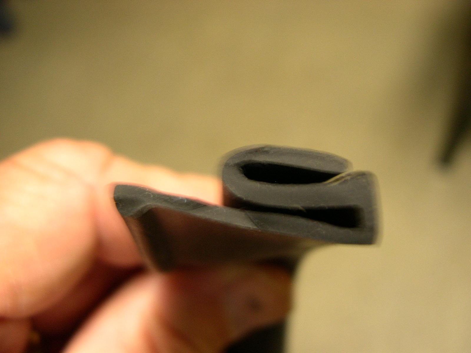

                  OK, I got my windshield moulding the other day and it's a beauty alright...very business-like heavy duty rubber, a quality piece. But wait, how does this thing go on? Long side in the front? Short side over the trim piece? Put the moulding onto the windshield and then jam the whole thing into the windshield mounting trim place? Or put the moulding into the trim place and then jam the windshield into the moulding? Or what?
                  What I'm working with here is a project windshield that 20 years ago was installed with nothing but generous amounts of silicone caulking, What a mess! I'd like to do it right this time. So, please, what's the right way to install the rubber windshield moulding ?

                    Mine is installed with the long leg on the inside of the cabin. So looking at your picture, starting from the bottom:
                    Your thumb would be inside the cabin.
                    Then then long leg of rubber.
                    Then the windscreen.
                    Then the short web (middle part) of rubber.
                    Then the aluminum trim.
                    Then the short leg of rubber.
                    Then your finger which is on the exterior of the airplane.
                    On mine, the long leg of rubber kind of flops around on the inside of the glass. I'm not sure why it's so long.

                      Tim, Bob, etal,
                      I was told that the long side (bottom part in the picture) is supposed to be folded back ABOUT 90 degrees so that it meets the top surface of the boot cowl at an almost perpendicular angle. I think this way it will help hold some of the weight of the windshield. The bottom of the windshield fits into the upper groove in the picture. Then the whole thing is completely covered by the aluminum strip that you see on the outside across the bottom of the windshield.
                      I have tried it on a boot cowl not intalled on the plane and the long edge of the gasket ends up becoming curved, sort of folded back on itself.

                          Can anyone help resolve contradictory information about windshield installation? I've got a new windshield from LP Aero Plastics, the rubber molding from Tom Baker, and a new boot cowl-to-windshield aluminum fairing strip from the factory.
                          But now I'm confused about the orientation of the rubber molding. Tim wrote this referring to the photo above of the molding cross-section:
                          But Tom Baker told me just the opposite:
                          Windshield fairing (thumb in photo).
                          Long one-inch leg of rubber, with the bead sitting on the top edge of the fairing.
                          Windshield.
                          Short half-inch leg.
                          Other short half-inch leg of rubber bent up, perpendicular to windshield, sitting on top of the glareshield.

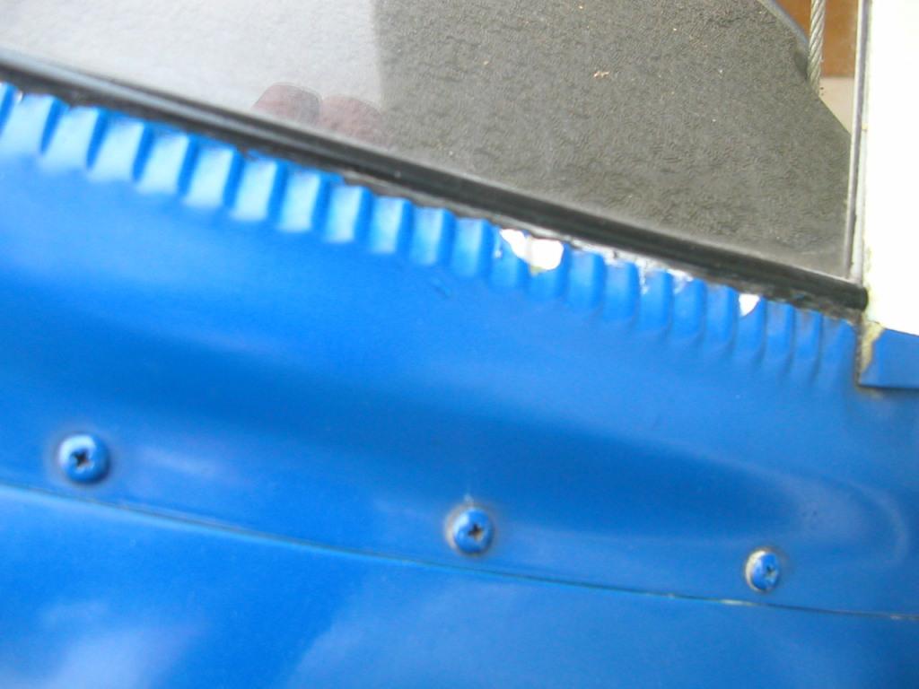

                          And can anyone confirm what Tim wrote in the separate 8/08 thread called "windshield rubber weatherstrip":
                          "The factory has them also, just remember to trim off the corrugated part of the strip, I have seen several aircraft where it was not trimmed off and it rubs the windshield. Tim
                          '41 BC12-65"
                          The top half-inch or so of the factory fairing strip is indeed fluted, but I assumed that was how it should be left. See the attached photo of Tyler Foster's serial no. 8015 at Oshkosh 2008, which seemed very original. Fluted fairing strip, with the bead of the long leg of the rubber molding over the top edge of the fairing.

                            The "fluted" part gets done at the time of installation, each airplane & windshield are a bit different so the flutes vary. At one time it was only a smooth curve that followed around the bends.
                            Even I got confused by description , the "proper" rubber channel will have a longer part inside the cabin and it does go over the glare shield , it is put in place with a tool shaped like a small hook. Wish I was there.... pictures anyone?

                              On second thought, and after looking at all my photos of other BC12-D's windshields, I remember that I've never seen that fluted edge on any other BC12-D windshield fairings. And Tyler's ship is a bare-bones Ace model, without the left door, etc. Is it possible the factory left that fluted edge on the Ace fairings, but removed it for the BC12-Ds? I assume the fluting has something to do with keeping the edge from wrinkling as the tooling stamped? rolled? the compound curves into the strip of aluminum?
