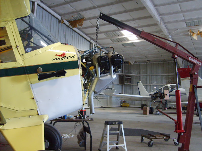

It is a VERY tight fit with Eisemanns, we had to adjust the firewall on my airplane using a sledgehammer. There is not enough room to remove the mag. There is no room to move the engine forward in the short cowling (for more mag clearance), not even 1/4 inch.

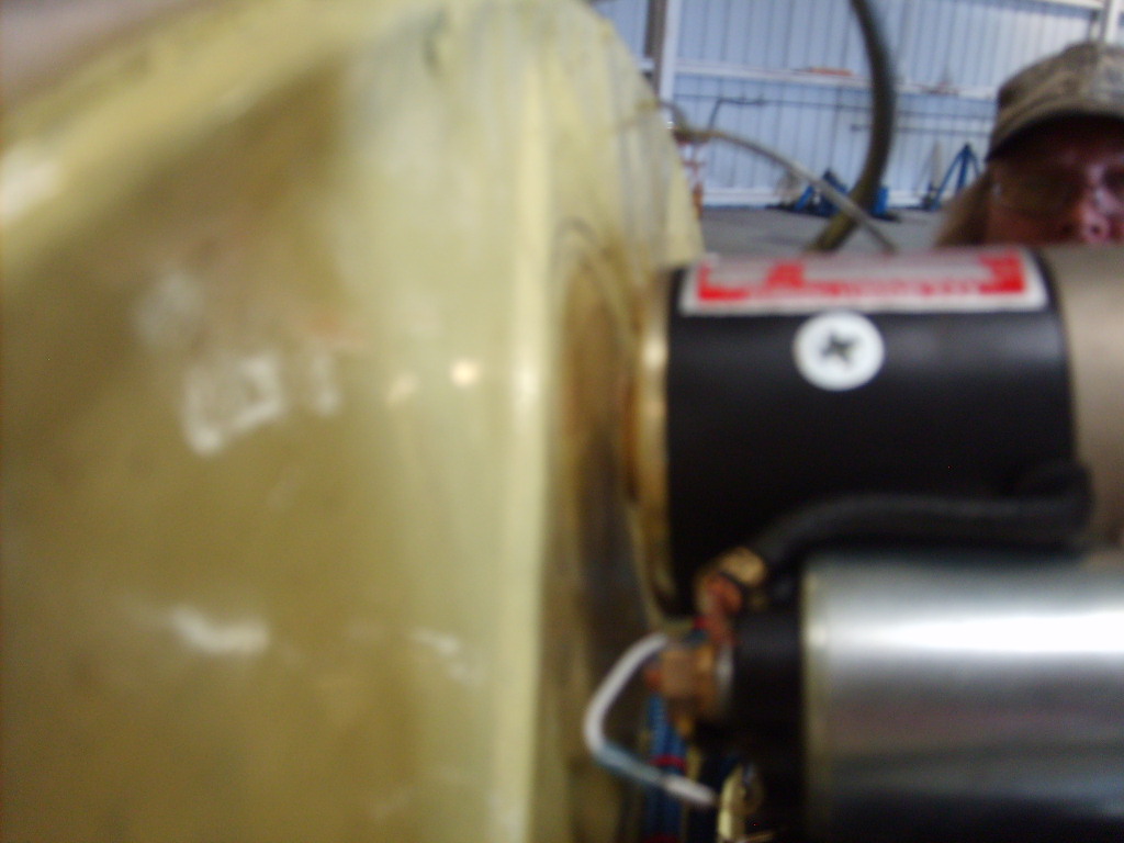

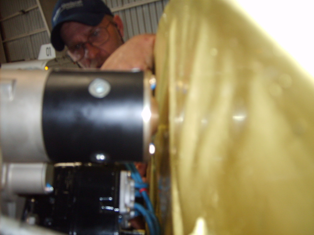

Dennis I used the short mount on my plane with a starter, alternator. and bendix mags, luscombe exhaust.The starter and alternator are B&C products and are the only one that will fit on a short mount.
