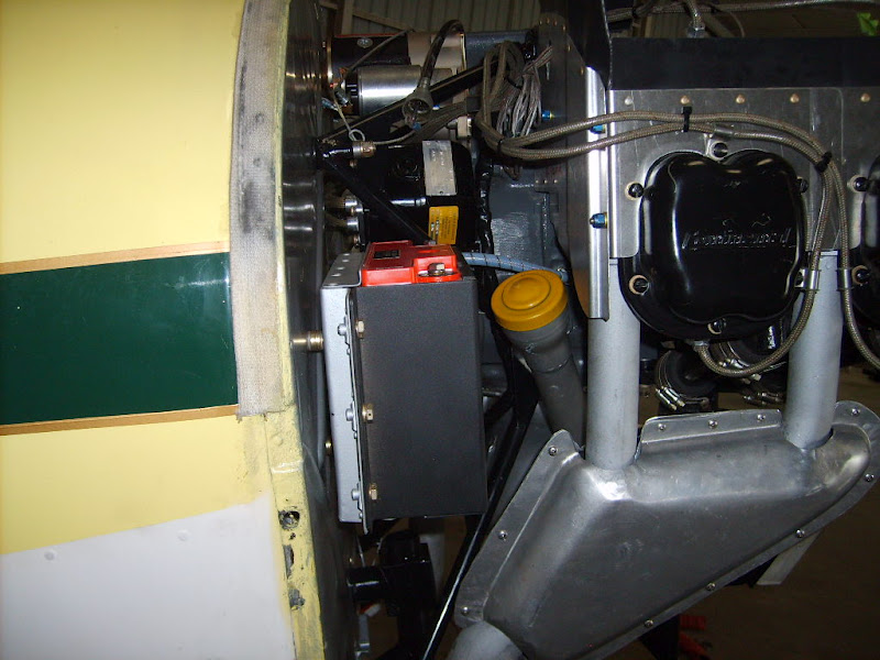

      Kevin the sky teck will not work as it will hit fire wall if i remember it's almost i inch longer then B&C it will hit.Also to remove the starter all you do is take the top mount bolts off, loosen the bottom bolts and lower the engine about 2 or 3 inches and out it comes.

          With the Oddyssey battery on fire wall and starter,alternator on a short mount the CG on my plane is 18.97 the empty weight is 777 pounds the main wheels weigh 708 lbs and the tail wheel weighs 69 pounds and it flies like it did when it had the A65-8F on the front, only climbs better and is a little faster oh and gets off the ground quicker.

            Re: C-85 Long engine mount or Short

                  at the time that i put the engine on my plane sky teck had one starter that fit C85 it was longer then B&C by about 1 inch and if you look at the photo of my install 1 inch would not get it. I cant find my numbers but i did look at sky teck and it looks like they changed there motor on there starters witch could allow them to fit. The numbers are from my plane and the re-weigh that was done after the engine change. I don't have a long mount. Ok found my numbers and these are form Sky Teck and B&C's web sites the only starter Sky teck lists for small Continental is 6.4 inches from the face to the end of the case.The B&C starter is 5.70 from the face to the end of the case. That is .70 in. witch is 7/10 in. so with the B&C installed on a short mount the gap between the starter and firewall is 5/8 in. the sky -tech will hit the fire wall or get the hammer out and put a big dent in the firewall.Or you could shim at the mount to firewall attach point or the engine attach point witch moves the engine forward then all kinds of things don't fit. B&C is a bolt on and requires no other mods.

                    The sky tech didn't touch the firewall but it was so close it wasn't funny....the b&c certinly gave a little more comfort space between the firewall and starter.

                                Rich why not stick with the short mount and do like i did put the battery out on the fire wall. The group on supper cub were talking about a new battery that is just hitting the market that is 620 CCA and only weighs almost 3 LBS. It is 11 LBS. lighter then the oddysey i have on my tcraft witch is 14 LBS. Check post 19 of this thread my CG and weights are there.
