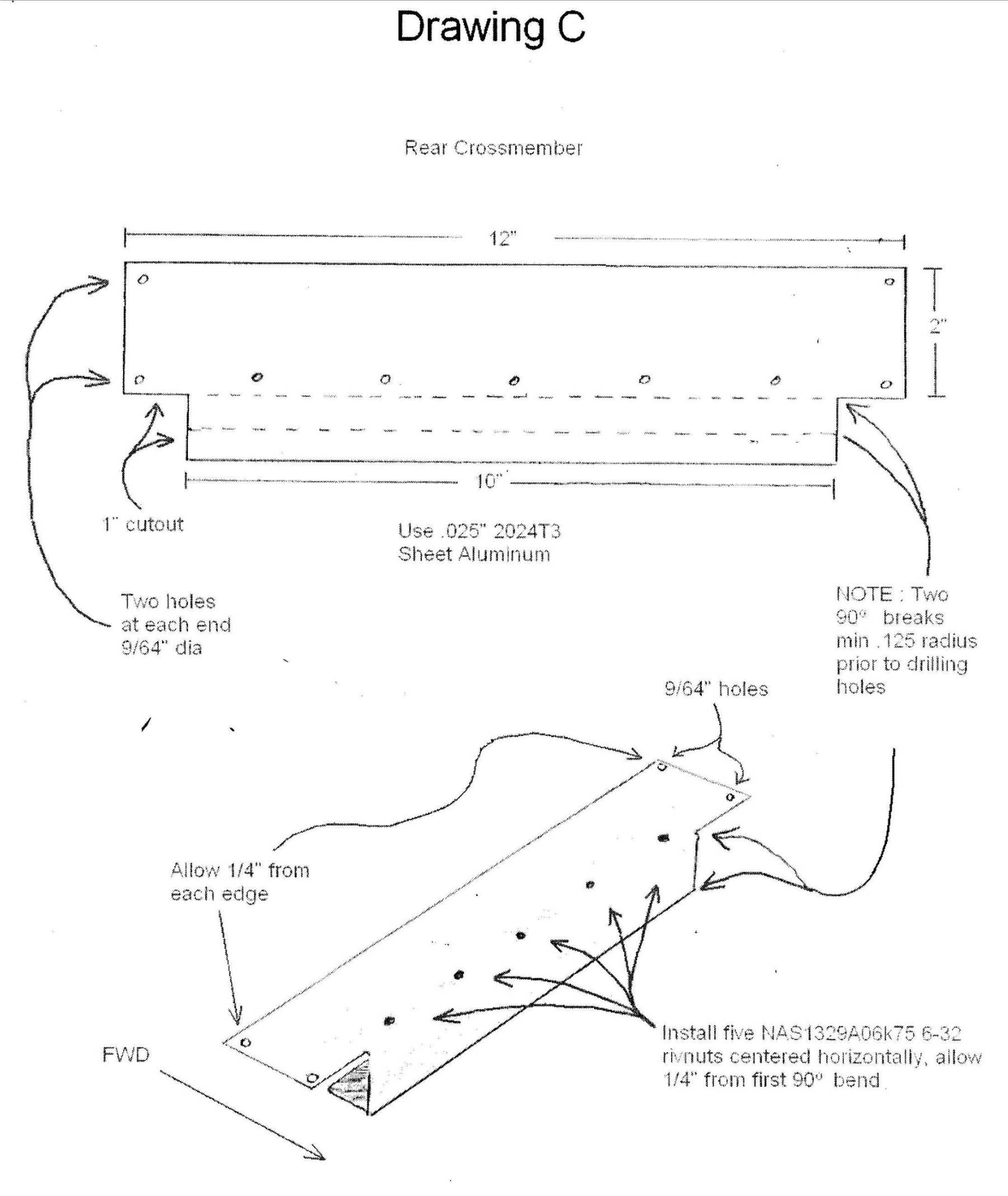

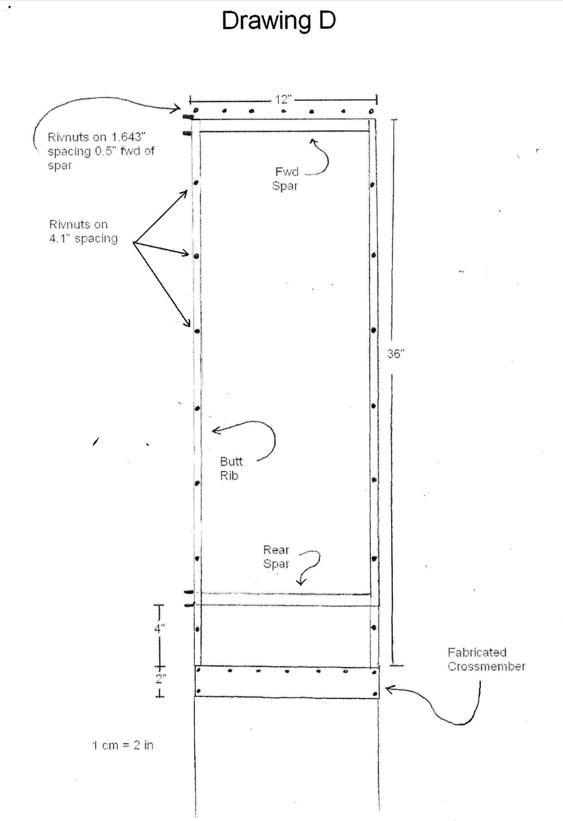

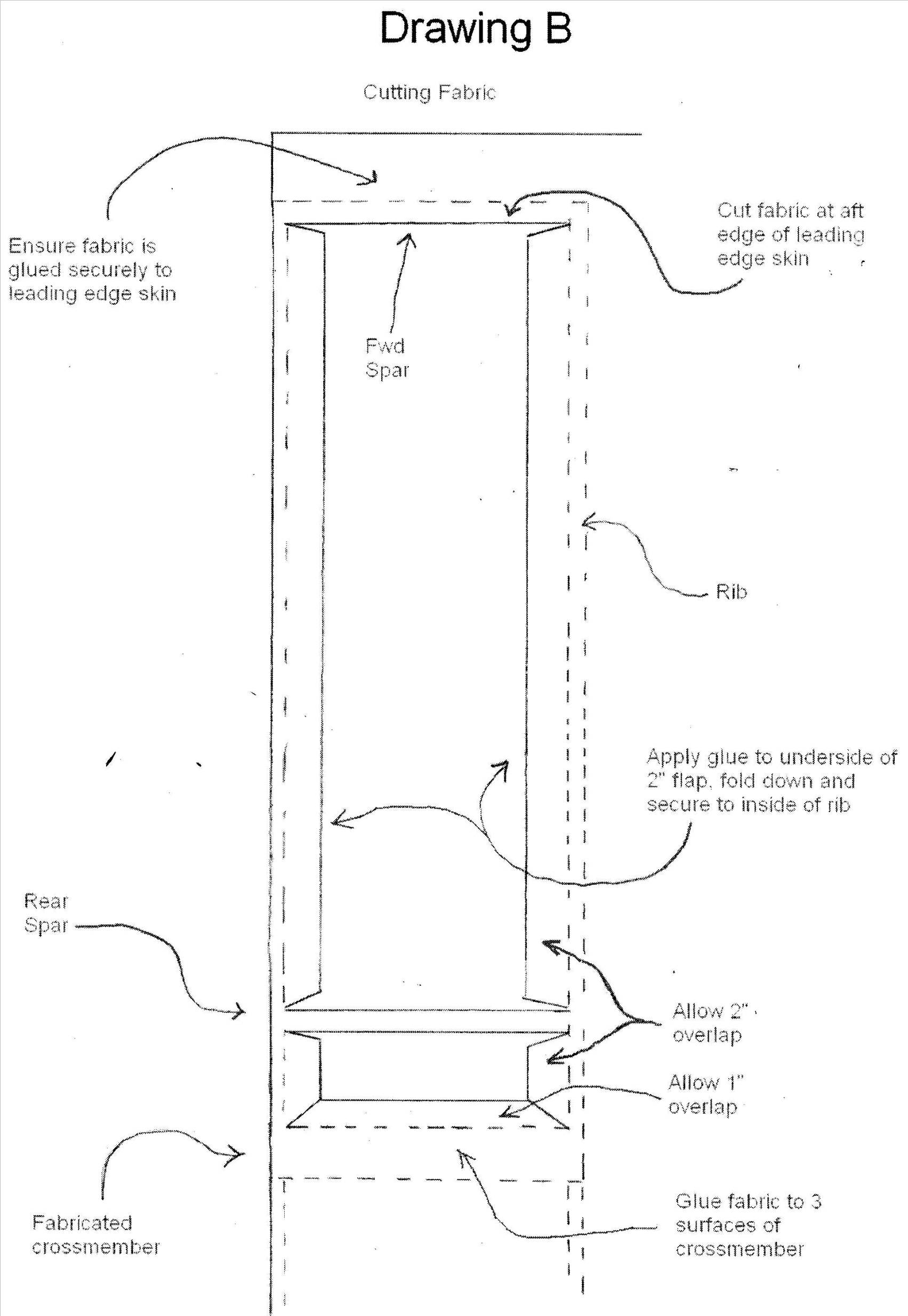

    Thanks to supporting documents from Walter Whake, I was able to get a 337 approved by the Portland FSDO to replace the fabric over my wing tanks with sheet aluminum. If anyone is interested, I will be glad to share a copy. It is basically the same as what Walter did. My 337 just goes into more detail and has more drawings.

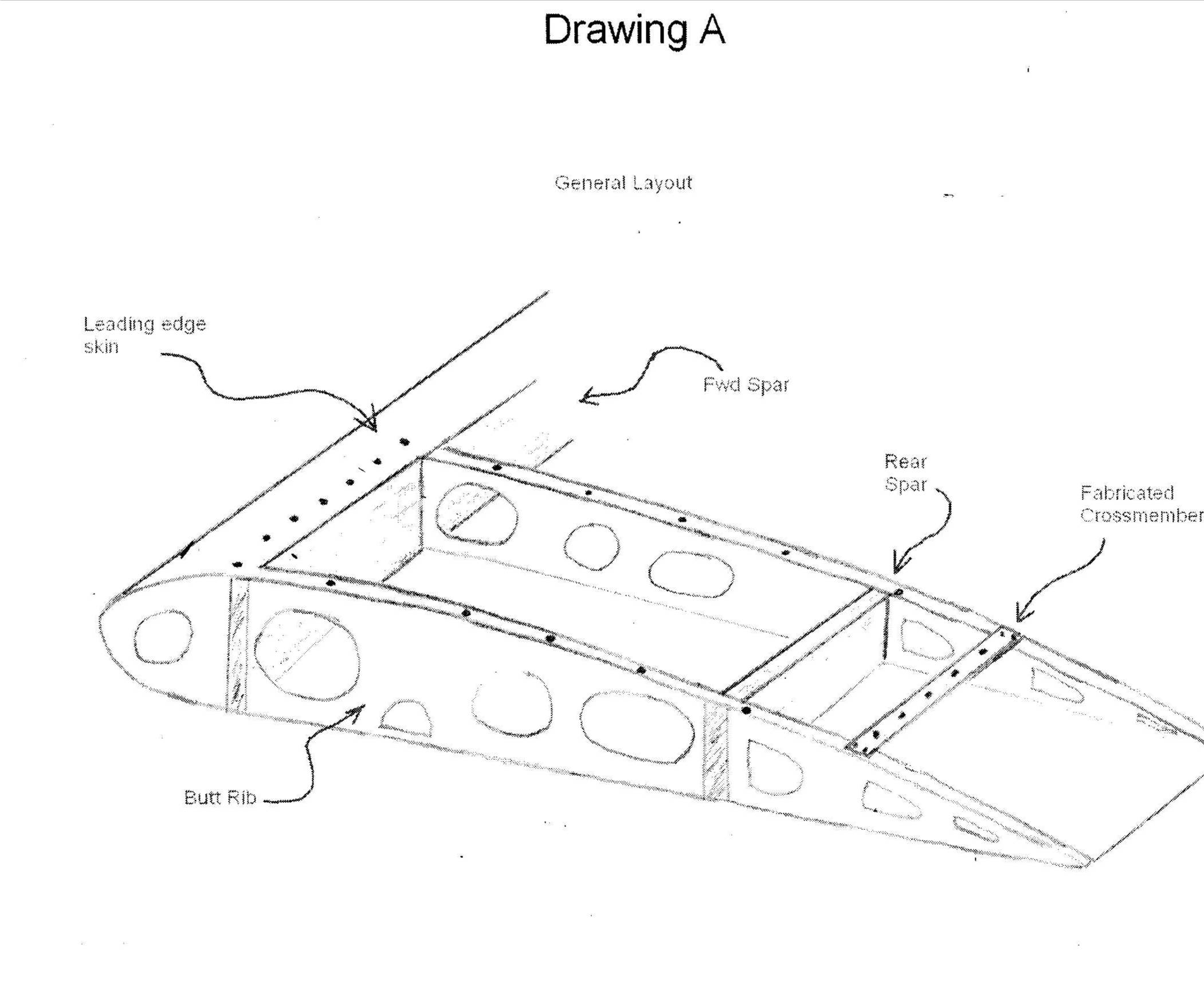

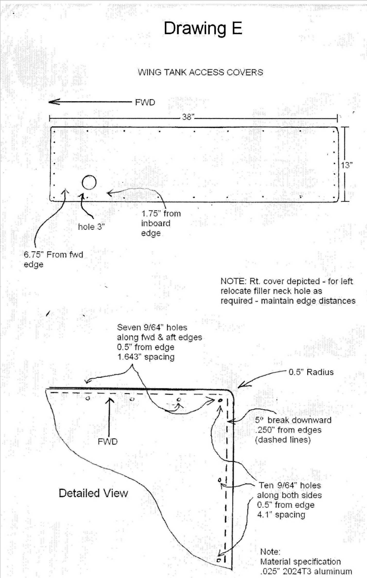

          No doubt about it! Walter is "da man". I could not have gotten my approval without his drawings and 337 form. Thanks again Walter!
          Attached are shrunk down versions of each page of the 337. There are a total of two pages for the form and five pages of drawings.
          I could only attach 6 files to this message, so be sure to get the last one on the next message.

            Re: Aluminum Covers for Wing Tanks
            Last of the files for the 337.

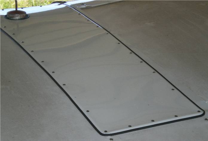

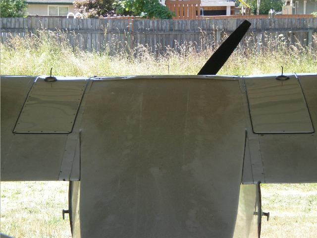

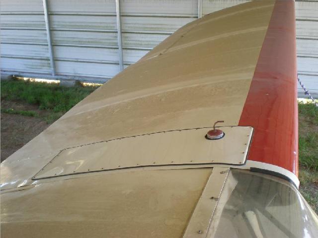

                    Richard,
                    Could you or Walt post some photos of the covers installed on the plane?
                    It's a great idea, I'm curious what it looks like.

                      I will take the camera with me next time I go to the airport. May be a couple of days.
                        OK, I went to the airport yesterday with camera in hand. Attached are the requested photos.
