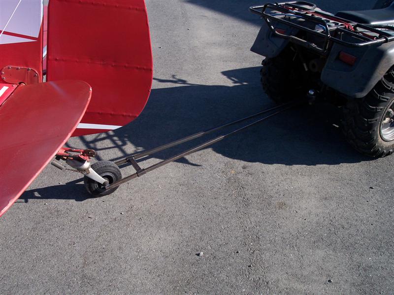

                            Here's the tow bar I build and it works great, not only will it pull tail draggers but I towed a Cessna 310 in the hangar the other day, using a four wheeler.
                            Wolf Lake Aircraft Services
                              Re: Tow Bar
                              Nice towbar! Back in the old days Dad had a Cabin model WACO that had to go up hill in to a dirt floor hanger. He had a trough (2"X8" with 2"X2" nailed on each side) for the tail wheel to guide it in straight. As the tail wheel aproched the guide he would have to fuss a little but from there on no problem. Actualy I believe most of the hangers there at that time had a similer arrangment. There is no electricity on the field anymore so now we fight them in by hand. :doh:
