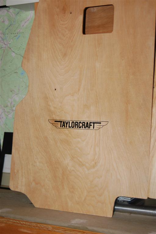

            I cut mine out of 1/4 Birch plywood (2 pieces) 4 coats of varnish on top
            3 on the bottom.

              Nice job, thanks for the picture.
