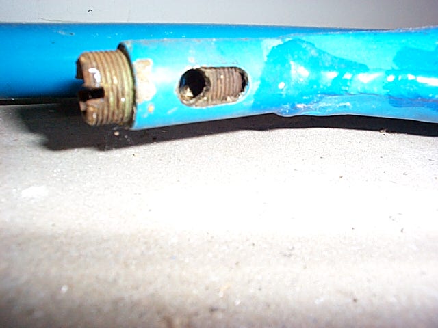

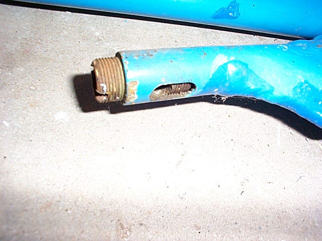

      Hi Dennis,
      Are you sure they are not adjustable?
      Did you look at the very top of the rear strut, the piece up inside the wing fitting?
      T-Craft struts don't have that threaded fork like some other planes.
      I attched some pics. I bet you have these, don't see how one could rig the plane without them.
      Also if they are PMA parts or STC-ed parts you don't need to worry about they alloy the selected. ie 4130, 1015, 1025...

          Thanks David Rude, you solved the question. I guess I don't know my aircraft as well as I should. It has the rear upper adjustment as per your photos. It is not a clip wing just the paint reminds me of the great Duane Cole. I have finish painting the tail now too. I see that the EAA has finally responded. :joy:
