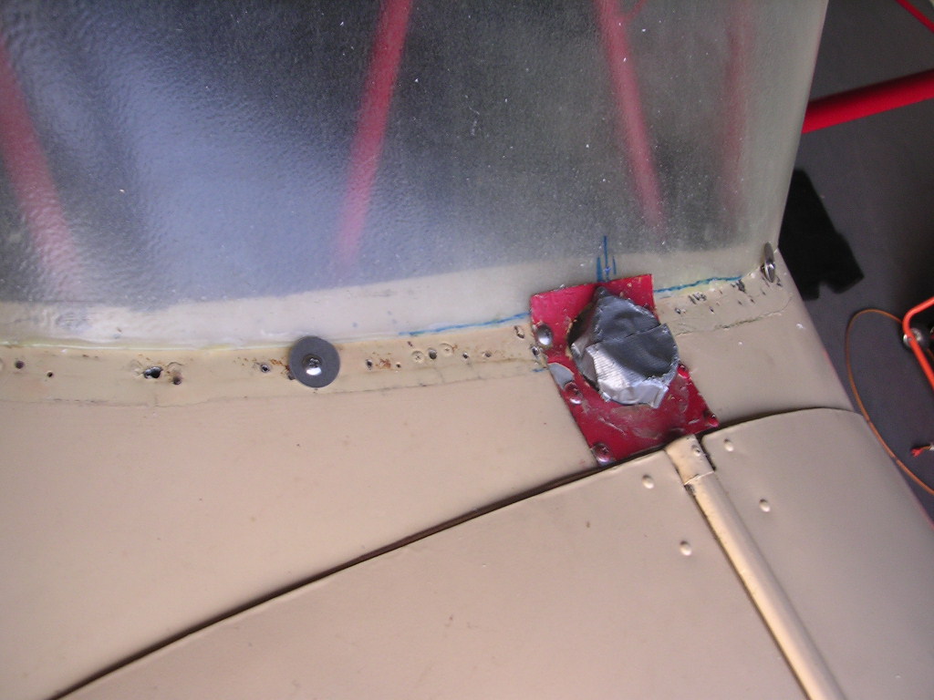

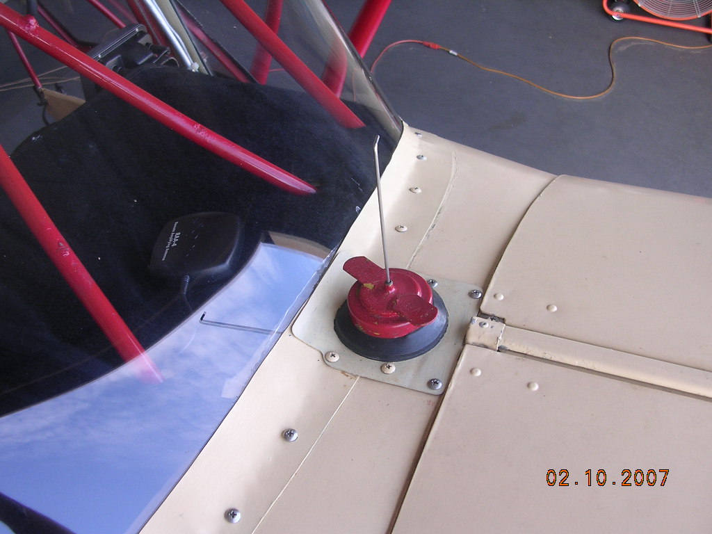

I removed the bottom center wire supports and have the top two just touching the wind screen. The four screws across the top in the fuslage are 1/8 oversize, I filled them with silicone and put the screws in. The area around the boot cowl is floating in silicone between the boot cowl and the fairing. All screw holes are oversize. The area around the wing roots has an internal alum fairing with a rubber u trim, the fit is tight but flexible. I had to make the external fairings new but they fit pretty good. The installation has been in about 3 months, so far so good. The temperture varies from about 70 to about 102 degrees.Walter Hake TF#

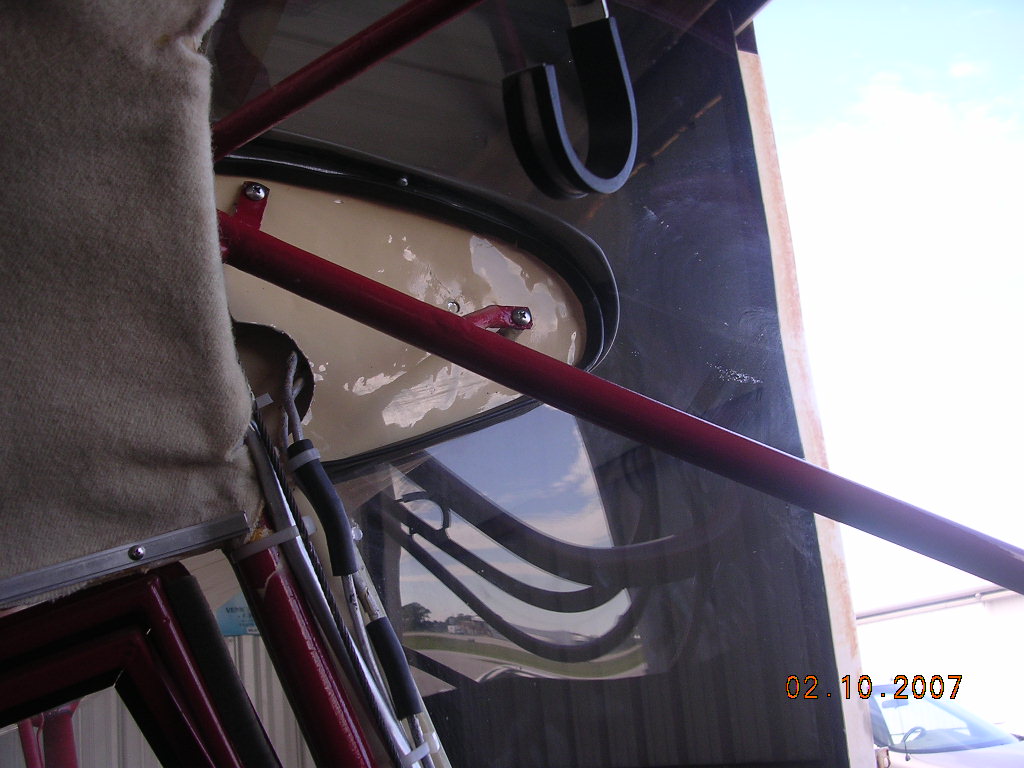

Supports do not touch, they have rubber tubing over them, they are there to support the windshield if it moves back in a dive. Four were put on when the dive test to 170 mph showed things moving back. I do not see the proper lower windshield abnd rubber channel in place. Could be my eyes, what are the washers doing ???Taylorcraft Foundation, Inc

Are the folded sheet aluminum "A" pillar side supports gone too? Both of mine have a metal piece that holds the sides of the windscreen without the screws touching the transparency. I can't see it on the top rear but there should be a metal piece to hold the top back edge too, NOT just screws through the transparency!

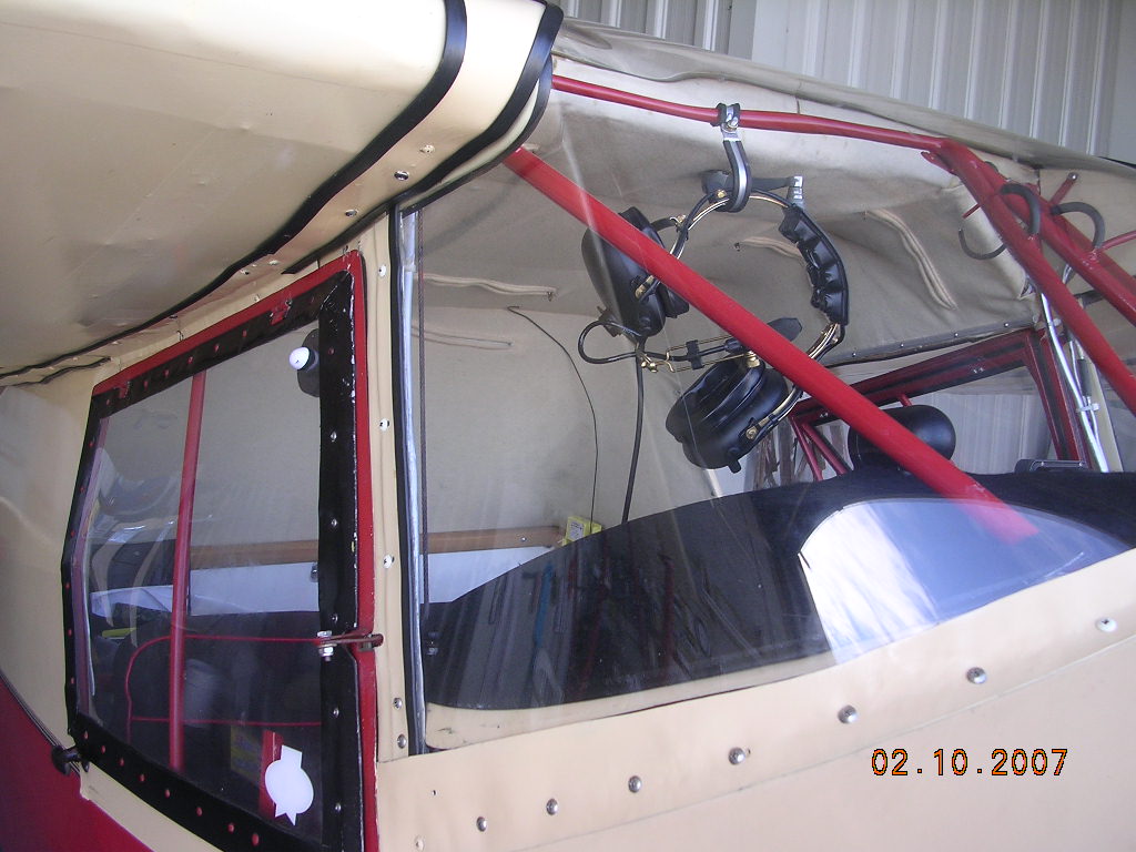

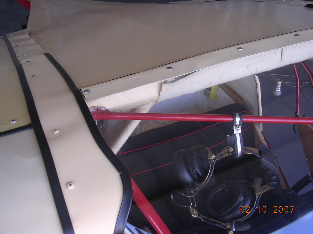

The washer was a temporary tool used while fitting the windshield. The windshield that I removed was embedded in silicone. A nasty cleaning job, it was about 20 years old and spent most of its time in the Chicago area. There were no cracks,just haze from cleaning, reducing visability. The weld on the lower internal supports were so weak that they fell off when I removed the windshield. The upper supports are firm and the rubber just touches the windshield. Attached are some finished pictures. The new windshield miced at about .005 thicker than the old one.Walter Hake TF#
