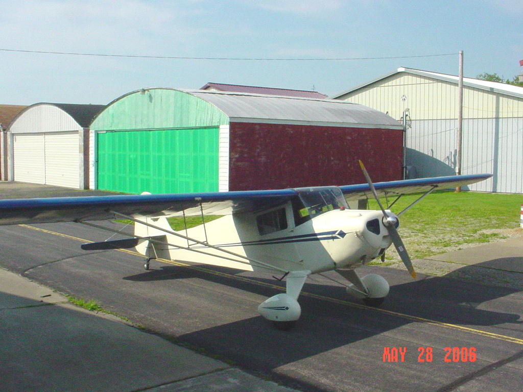

    Being a new member I have a few questions and some ideas. I am doing an on going clean up/ extensive annual on N95334. She was born on Aug 30,1946 as a BC-12D.
    Idea: The nose grills are so soft and too easy to bend in just touching them, so what I did after spending all evening bending them back to correct shape and making them look evenlwas to sand blast them (walnut shells) and then filled the back side cavity with T-88 epoxy. I embeded small wood sticks (like long tooth picks) in the epoxy. Now after painting them they are stiff and a lot more resistant to bending.

                  By the way, I love that paint scheme on your BC12D. Don't know why...

                    Thank you guys!! This site is great!! I will try an post photos of my progress of the so called extensive annual. So far the the nose, including engine has been cleaned, painted and replace baffles, highly polished prop etc. The outer part (bowl,top&bottom cowl and boot cowl) and landing gear are Stits Eagle red. All new glass, new interior. The doors are next for red paint but where to stop ?? Kinda want to paint it like Duane Coles's but with some black trim. I am tired of working on her or him since January. Can't decide on a name either "Dennis the Menace", "Lil Rebel", Firebaby (if I decide on flames with blue highlites) or "Miss Triss". Thanks again you have been a big help.
