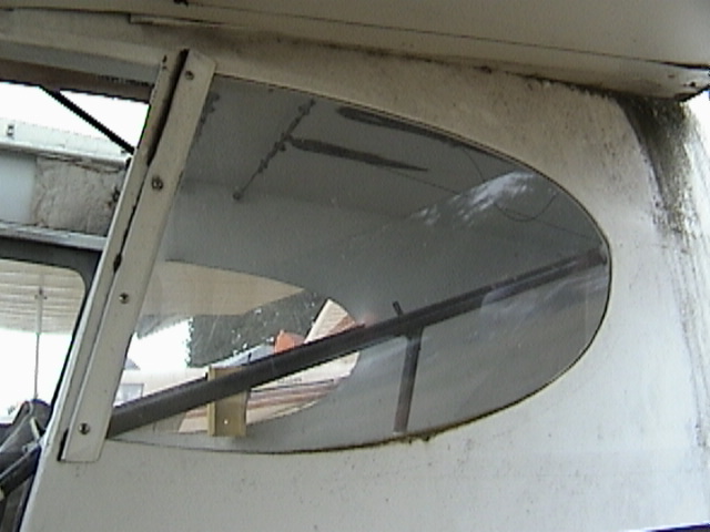

                  Mike,
                  Are you looking for the short D window, or the long one that came on the later models? The tumbnail shows the short one, the attachment is the long one.

                        Originally posted by Pearson View Post
                        Mike,
                        That short window doesn't look correct.
                        mike
                          Re: rear D window Frame
                          I agree with mike.The short one is not original unless they made different styles from the factory.
