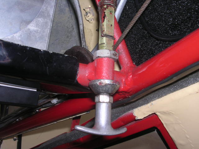

I use my parking brake some of the time, I back it up with chocks that have a long rope attached ...it is located on the lower left side od the panel..If I pull it out all the way it will snap loose, if I pull it out about half way it works great and I cannot move the plane. The 62 year old teeth are probably worn, I do not know the purpose of the spring, some day I will take it apart. See the attached photoAttached FilesWalter Hake TF#

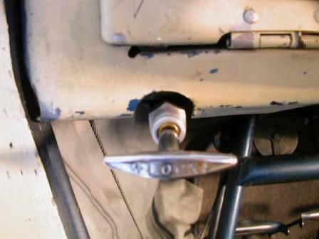

Photo attached of my parking brake T-handle. It wasn't holding when I bought my plane -- the locking threads inside the handle mechanism were worn down and the handle wasn't "catching" when pulled out, so just replaced the whole thing, cable included, with a new stock item from Aircraft Spruce or Wag-Aero, I forget which. Holds the brakes pretty well at idle. I only use the parking brake for starting (with chocks and the tail tied as well), and for run-up (to save my thigh muscles from holding the brakes).Attached FilesJoel Severinghaus
