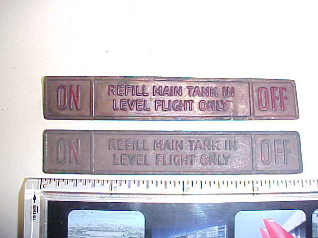

    fuel tank placard and on/off are two seperate placards. I mouted my valves under the dash and put the placards thereabove the valves

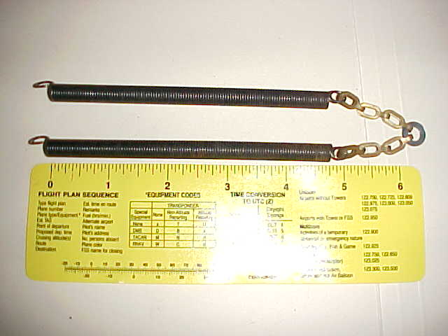

      Re: Location and wording of placards
      here are a couple ; one of a placard and one of the Correct rudder springs. I do have springs left for sale , more tomorrow. off to Fat Tuesday

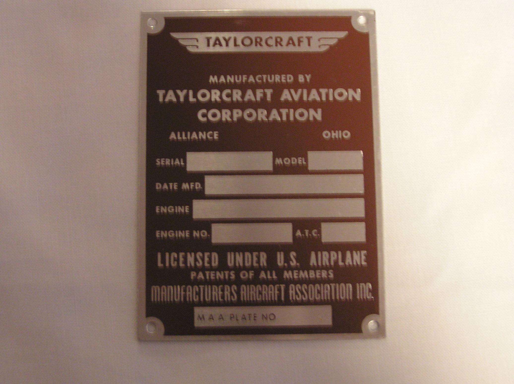

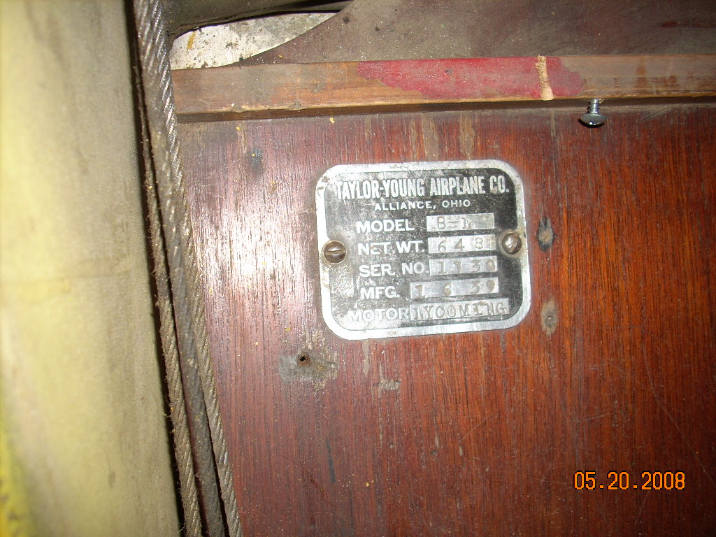

                  This is a picture that I have of one.There were several different plates made depending on the year of the plane and where it was built. The plates are available and I believe Forrest has them. If your friend is needing a replacement plate he must contact the FAA for a letter of authorization before he can have a new one made or buy one and have the information stamped on it.
                  Hope this helps,
                  Buell

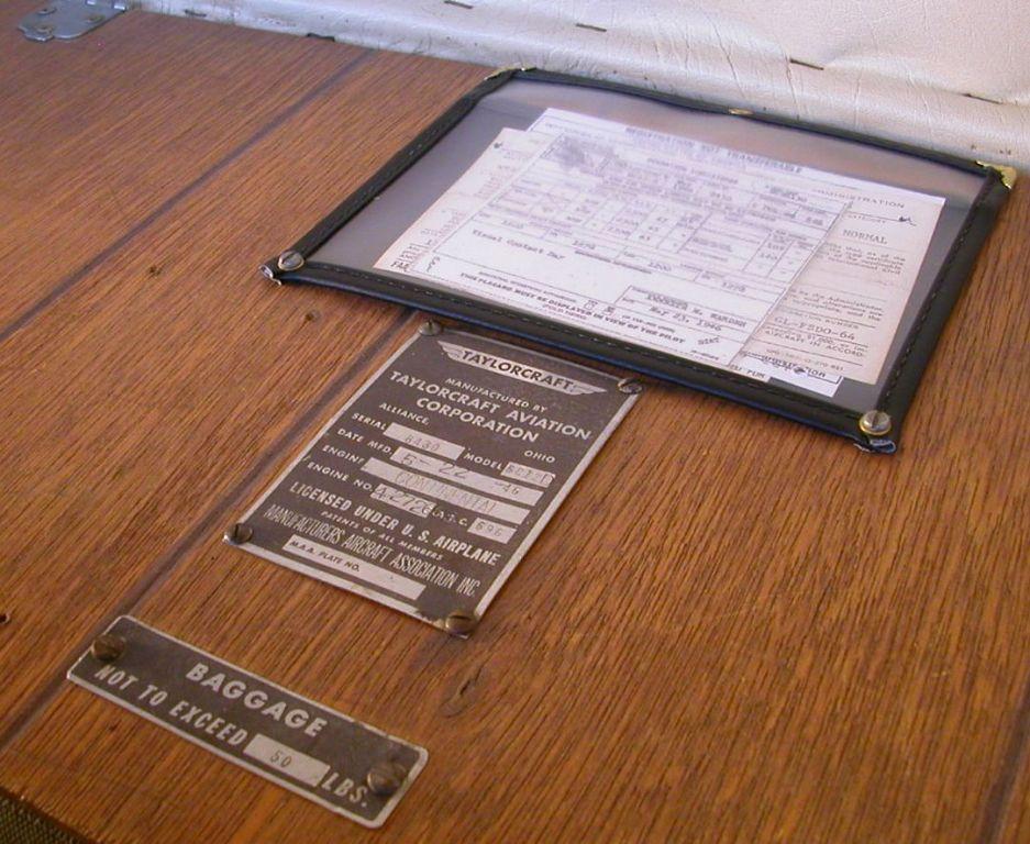

                    Here's one from 1939, Top of placard is towards aft end of plane. On floor board under pax right knee.

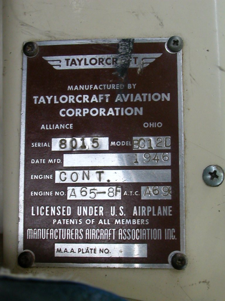

                        When I bought my ship, the data plate was mounted on a wooden lid over the baggage compartment, along with the baggage weight limit placard. I moved it to a vertical position on the cable cover under the passenger's right knee.
                        Also attached is a photo I took at Oshkosh of the data plate in Tyler Foster's very original (if scruffy) '46 BC12-D. Sharp kid, an 18-year-old from Sanger, Texas who flew up to Oshkosh with some 17-year-old pilot friends in their planes.

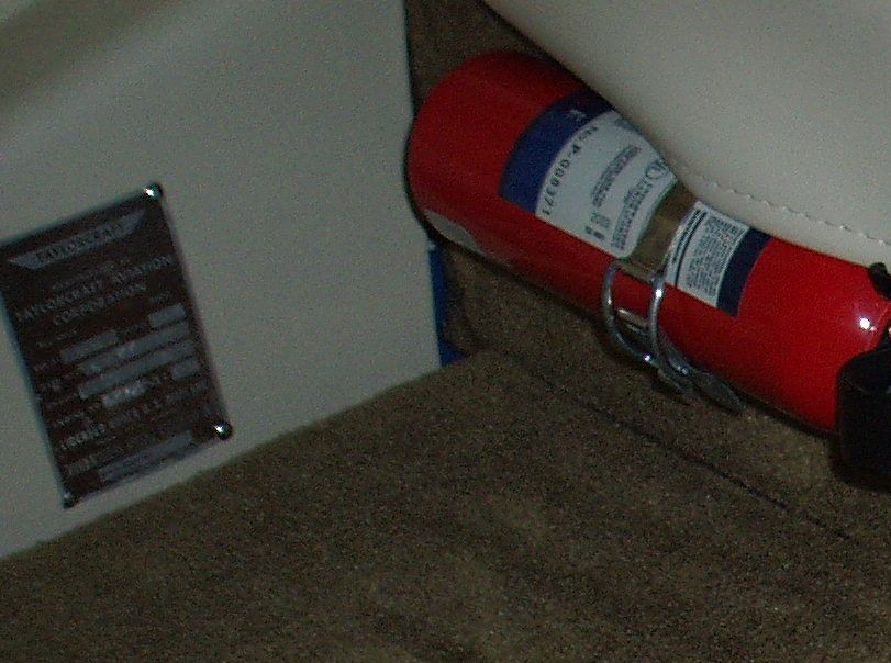

                          My 41's placard was located on the right side by the passengers right knee. I do not remember exactly where but can investigate if you like. I still have all the panels and should be able to get a closer location. I found it among coon poop and other debris as I was cleaning things up for restoration. Larry
