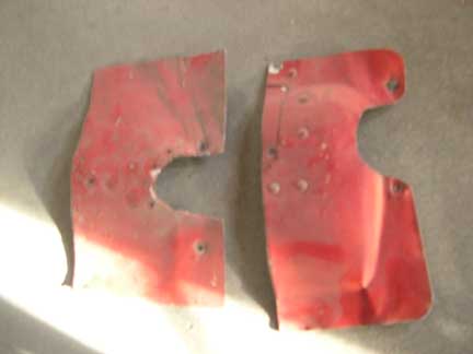

          Hank or anyone:
          I seem to have two different bungee covers on the same plane! I think perhaps one is what Hank calls a "flat" and the other a "blister" type. Both have been repaired multiple times...so I'm going to make a couple duplicates, either fiberglass or hammered out aluminum.
          My question: which type (flat or blister) is original ('46 BC12D) or...which type works best?
          Also, what's the best material? aluminum does not seem to be ideal, (looks like vibration causes them to crack) would it be better to make them of fiberglass?

            The only flat ones I know of were on the DeLuxe models. I made a bondo mold to hammer some out several years ago (blister style). Aluminum works fine, but needs to be made out of at least .040. 3003 works best for hammering.
              Re: Bungee Cover Pattern
              Bob,
              From what I see in the picture of your covers you had blister covers all around but someone couldn't make a new one for the passenger side (not a fully formed one anyway). The one on the right in your picture is for the pilots side and it has pretty much been repaired to death. The flat ones for the pre war planes won't fit on planes with the blister covers (at least my 41 covers are no where NEAR a fit on my 45). I have a buck for the flat ones (they actually have a little stiffening lip all the way around the edge so they are only flat across the bottom. The "flat" ones actually fit up into a pocket in the belly and don't seal as well as the blister ones. The blister ones have a flat "flange" all the way around that (is supposed to) lay flat against the belly on the outside of the hole. I haven't made a blister one since my 45 is in restoration and I haven't needed them yet. My old ones are good enough for patterns when the time comes. I made a set of the flat ones for the 41 fairly fast and am going to make some more as soon as I remember where I put the *@$%*& buck. (For Paul and Wayne, I hope that will be soon- KEEP BUGGING ME). I have the start for the blister buck and I will see if I can accelerate making those now that someone else will be doing the Pretzel Balls and glove box door handles. My first priority is getting my 41 back in the air. Spent yesterday building new "D" window frames for the 41. Now I have to figure out how to install them in an already covered and painted plane.
