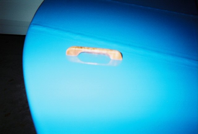

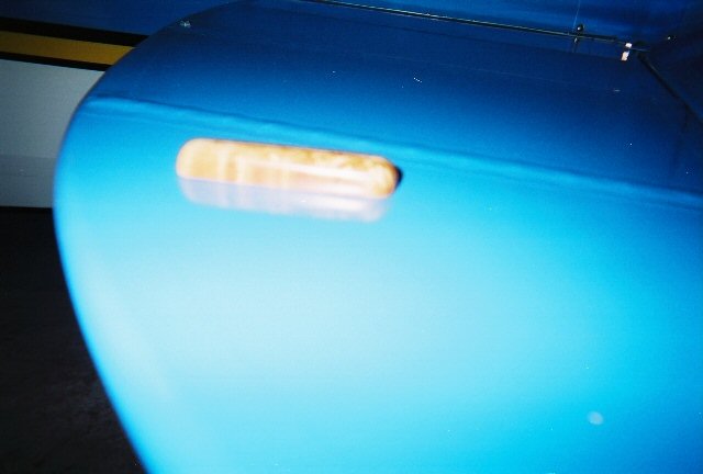

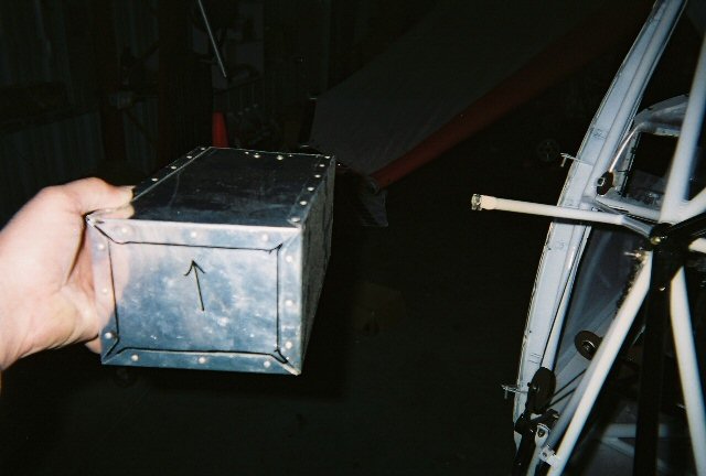

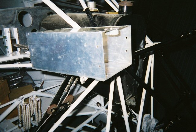

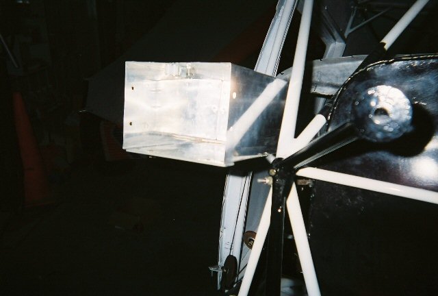

                            Sorry it took me so long but I finally got some pics of my glove box and glove box door handle that we made from curly birds eye maple. The glove box is made just long enough to fit inside the boot cowl and will hold a sectional. We also made it so it is removable,incase you need to get in behind it for some reason you just remove 8 screws and slide it out...you don't even have to remove the glare shield. Check out the pics and tell me what ya think.
                              I smell a patent application....?

                                Re: Glove box
                                Rob,on the glove box or the door handle.LOL....I don't intend to patent it...we'll all just share it.
