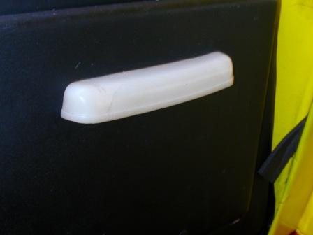

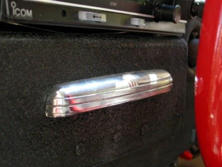

                          I'm also looking for original handles for my '46 BC12-D's gloveboxes. Does anyone know if those would have been plastic or chrome? (See attached photos.)
                          If someone would be willing to loan me an original plastic handle for a few weeks, I'll investigate getting copies custom-molded.
                            Joel, I have never seen the chrome kind before. I have only seen the white one. I believe that is original and plastic. Dave.
