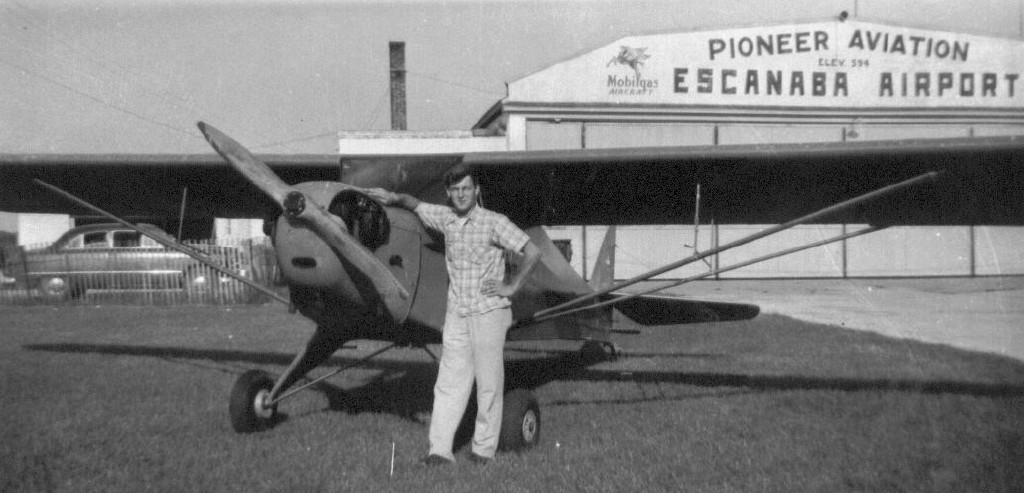

          Mr. Hernke. I believe you may own my Father's old Taylorcraft N22661. It sounds like you are restoring it. I have some old photos I could share with you of the plane when it was in great shape and would like to see what it looks like now. Thank you. Larry Brukardt. Email: [email protected]

            I'll butt in and ask, would you be willing to scan and post those pictures? I and some others here would be interested to see them also. I’m flying 22606, a BL. It was probably born in the same month as 22661, and I'd really like to see the paint scheme if it's an original. Let me know if I can help if you would be willing to do that.

                  History of N22661
                  Mike - NC22606. Right now all I have are some B&W scans. I'm working on getting better pics. I believe one is attached. I'll have to resize the remaining. Here's another.
