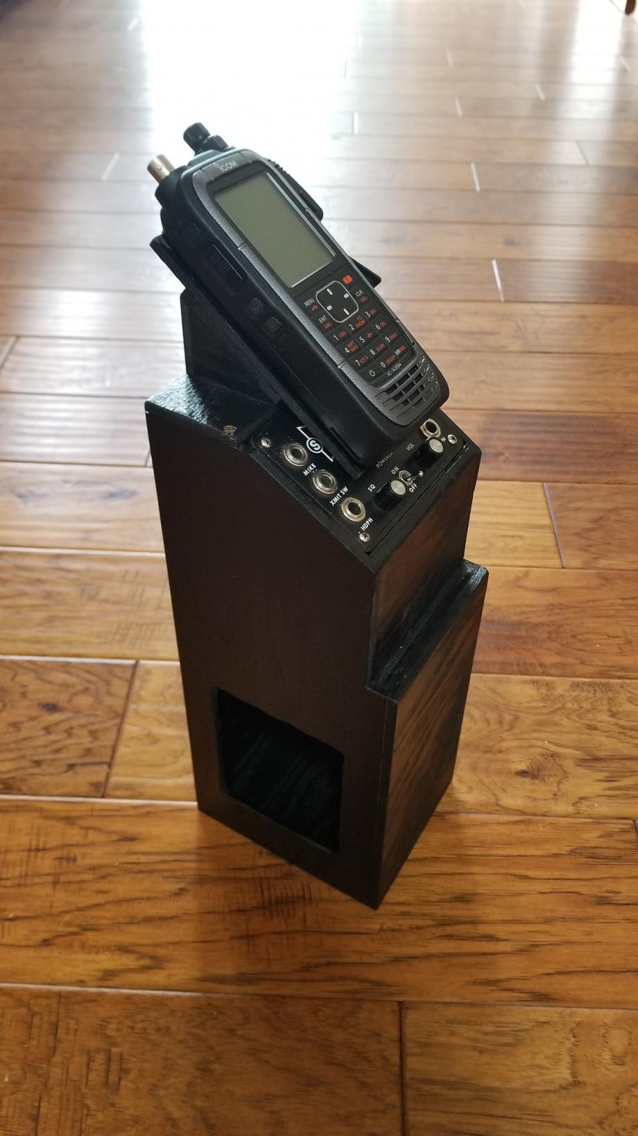

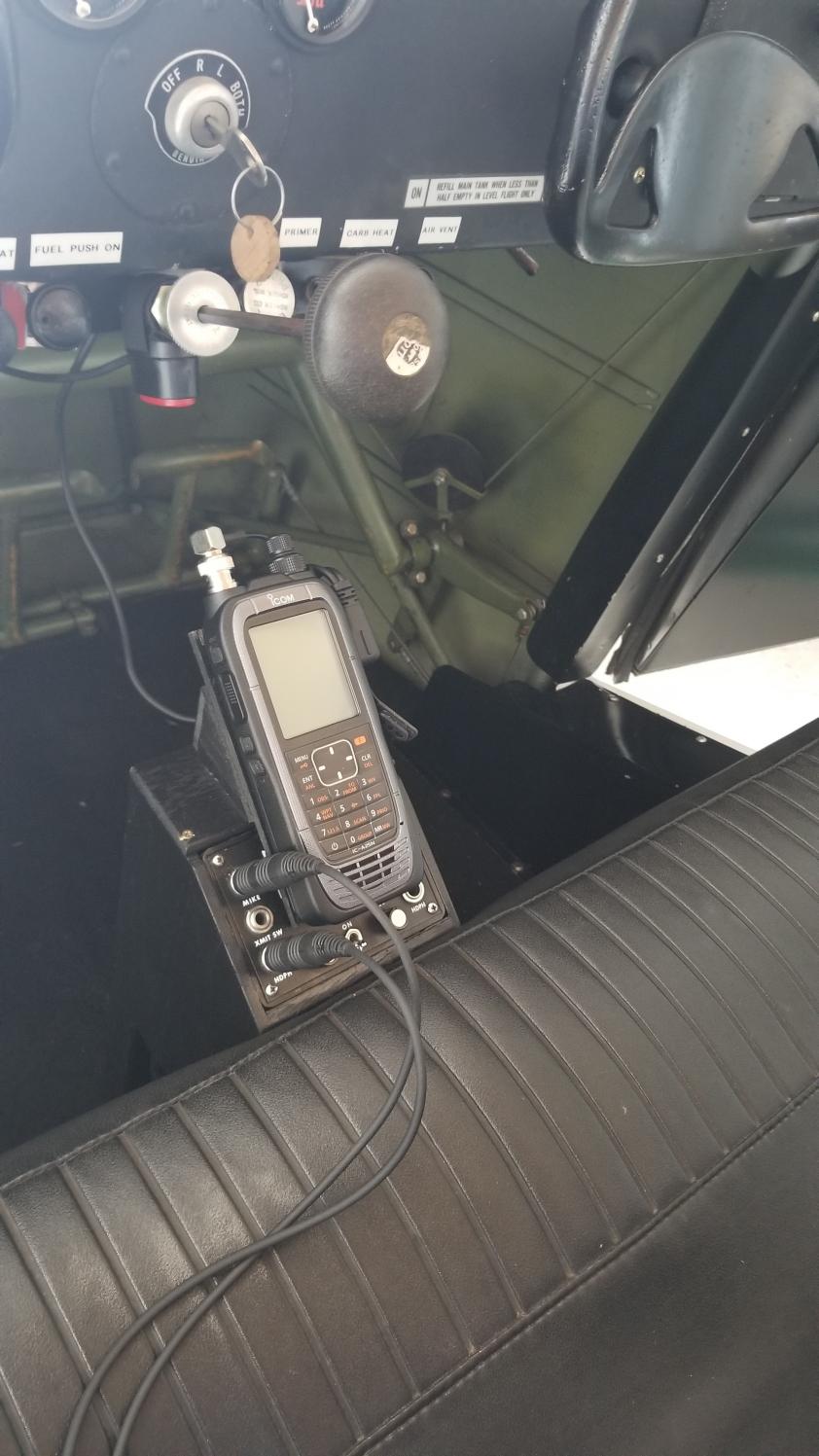

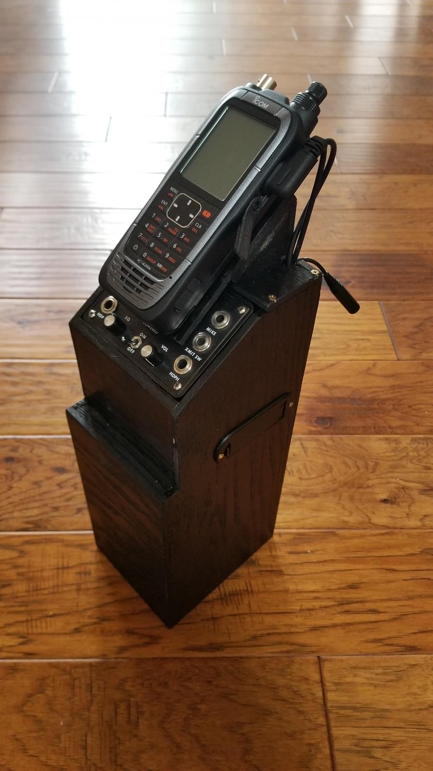

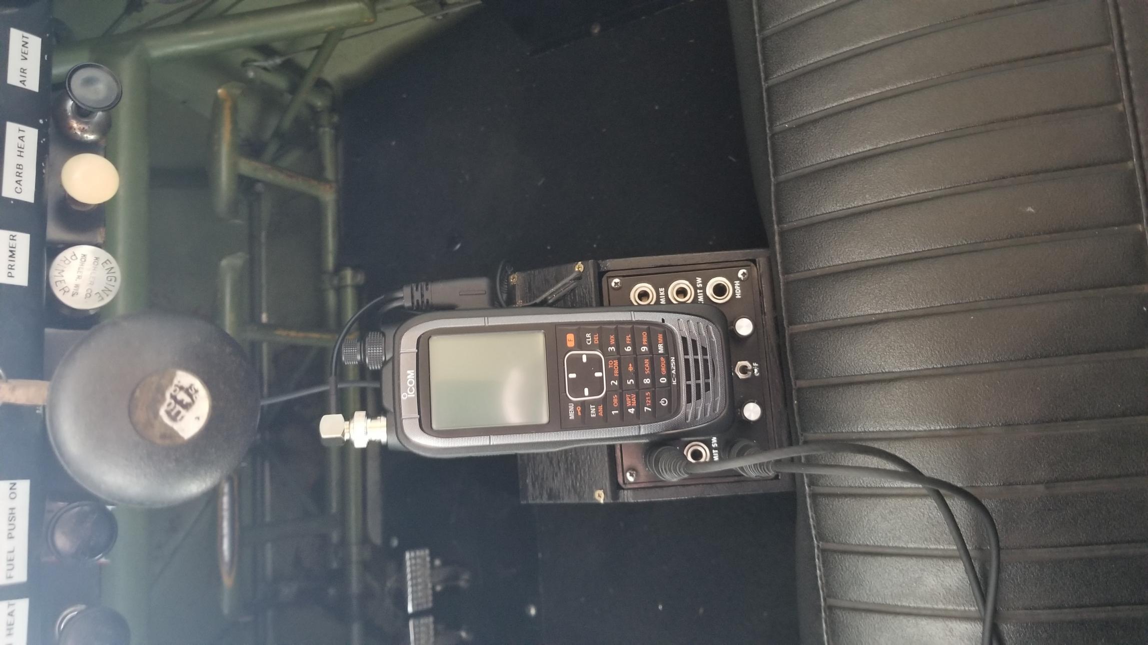

                    Sorry, I have been out of town the last two weeks. Happy to provide more info. I basically built a little box out of 1/4" or so plywood. The Sigtronics Transcom II intercom sits inside the unit. (Basically just sets in there). I have an older Transcom and you have to use a screwdriver to replace the battery every 25 hours or so. I created a jumper instead and mounted a 9v battery holder from an electric guitar (purchased on amazon) on the side. The A25N then essentially clips on above the Transcom, but allows me to access the knobs and jacks.
                    I have an external antenna which runs in the box and comes up the back and plugs into the A25N. The connection for the Transcom is also inside the box. The PTT is just a simple strap on button that people usually put on the yoke. I have it under the throttle in stead which I find to be a really easy an natural place for it. Just reach under and hit it with my index finger while hand is on the throttle. You can see it in the third picture
                    Let me know if you want any more pictures. I should be out at the hanger tomorrow.

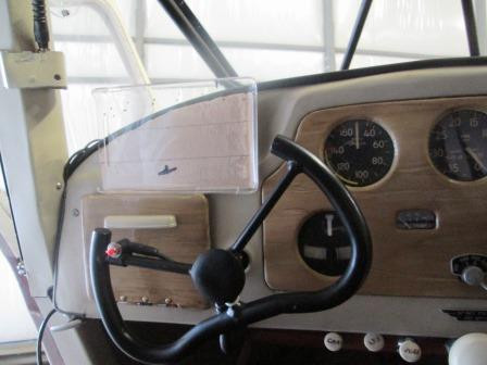

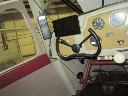

                      I mounted my iCOM to the A pillar with this small metal bracket (in the upper left hand corner of the photo). It uses the screws used to hold the trim piece which are reached from the outside and through the hole in the bracket. The antenna connection is the black wire hanging down just above the bracket and you can just see the headset and mic wires sitting on the glare shield. The clear plastic thing above the wheel is a tablet mount I am experimenting with for moving map GPS and also attaches with a glare shield screw and one of the glove box screws. No extra holes needed in the plane. The iCOM works great with the remote antenna (not so much with the whip and un-shielded ignition) ;-) The second photo shows how the radio and tablet do not interfere with the view outside or inside the cockpit.
                        OK, for some reason it wouldn't let me load the second photo on the same post.
