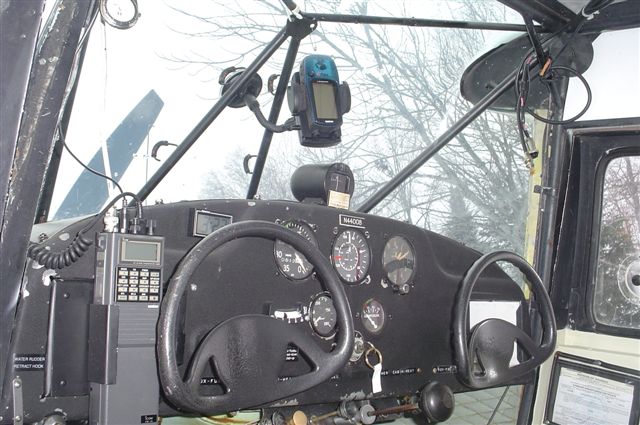

                I've used an ICOM for about 10 years. I went with an external 12V 5AMP hour battery that I take out and recharge now and then. I have one battery for the ICOM and one for a GPS196. I can plan on 10 or more hours usually before recharge the one used with the navcom. More for the GPS when I use it. Both radio and GPS are mounted with RAM mounts also.

                  I use a motorcycle battery for radio and GPS a 15 amp/hr it last me the summer with one charge.
                  The battery sits in a acid proff plastic container = Windshield washer fluid continer, Perfect size, 3 pluggs monted on top with master and 10 amp fuse.
                  The radio and gps has there own fuse in the plugg.
