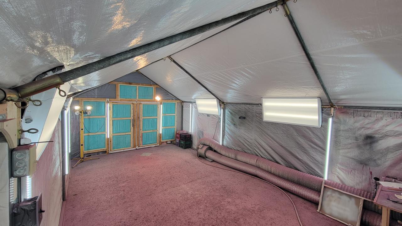

            I think I am going to buy something like this so I can paint in my shop.
            https://www.vevor.com/inflatable-pai...p_010233173763
            I have a friend that did just that! Good deal!
            • #22
              This is what I've ended up with. I'm suspicious of all of the plastic materials as they so readily get static charged with airflow. Static attracts particles that wait for wet paint to jump into!!! That's how it seems anyway.
              Scott
