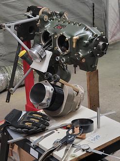

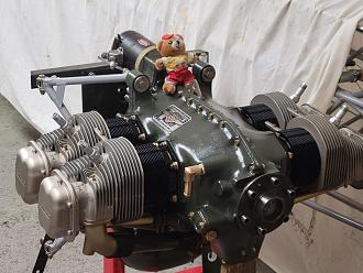

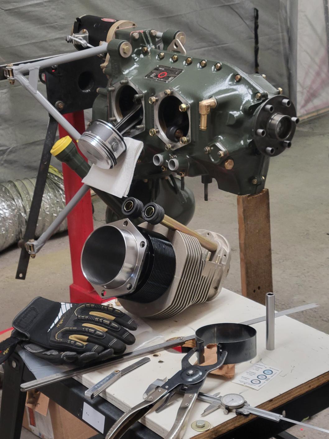

    AVvXsEj1OTxVTBZVaFDupAkmXucLGe9bPQjIgkiZsHv1batpkHA9Z1AW3zXBHoPyK3BNs1ZDDzZkhKCG-4arFyOpO7FJqeB6okkc580ZaRBEM7Cv36alF-hgKvGBPnZ5_rn-mrR4B4vGNCYGuAuExwklAUGdQpYdtZa6_j4QW0ApfPXxLRo5zZhonrkaDE1z=s4032.jpg AVvXsEioaKcCblehr3GIFrGw81ItU6LR663fggRQXvm-_VPY0Qhbwpy0z0p2HQ7WwtlViJYquMXdoIdzbypr98_6TdsnqAK60IG_rOwWQMw9sxA9RFxcv627UYTIwoK5jqIqLLEUi6iKpIpcLLGdJVx_y1I6rrv3ftRnZsmk0lhLrMN17DHceM_RACbpc2sR=s4032.jpg I bought a set of 4 superior cylinders for my Super Cub project. I haven't started the engine yet so not much info for you but it was my plan to balance the engine, so I was pleasantly surprised to find all four pistons were the same weight within 1 gram.
    This indicates to me that there was at least some attempt to match the assemblies in the set.
    Otherwise the assemblies appeared well made and well finished and no problems during installation.
    I used my Continental valve covers in place of the melinium ones
